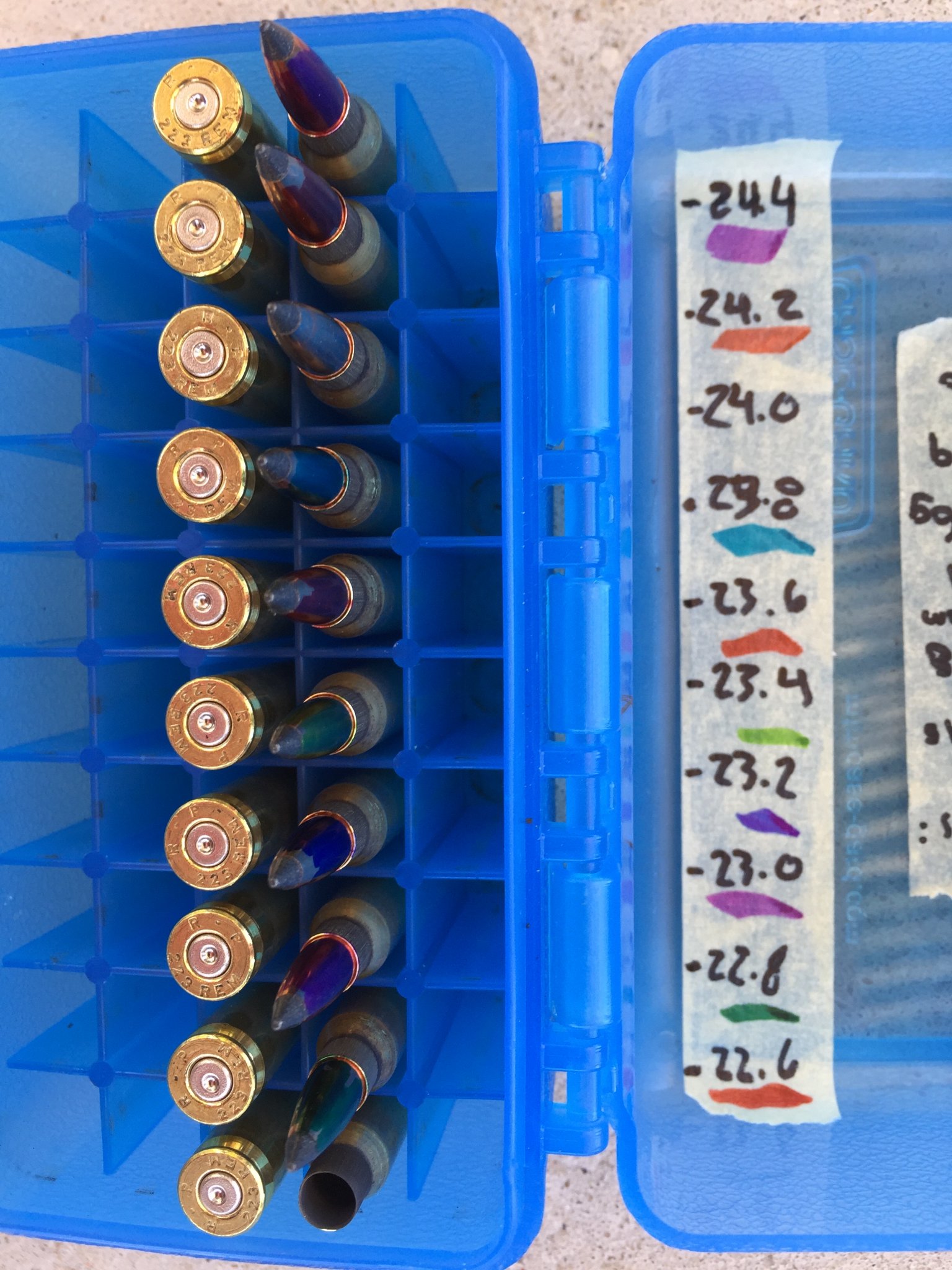

Color the bullets of each charge weight with a sharpie, leaves a color ring around the hole so you know which was which.
I've done that before and it works. I liked using white cardboard. I record all the shots on my phone by leaving it on record next to the target now.

If you run out of marker colors, just color one half of the bullet (in front of the ogive) red, the other half blue, etc. Maybe measure out and draw a 3 or 4 inch diamond to make it easy to position your reticle in the same spot.

You don't need to color the ogive of the bullet like @spife7980 does. I always colored in front of the ogive and never had an issue seeing the colors on the target. I still think it's a good idea to record all the shots with your phone at the same time, just in case.
