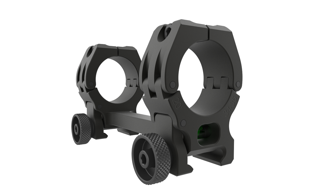

Like this?

Kinda. But with much better base mounting. 4 bolt and no thumb wheel crap.
I may be wrong as I’ve never used their single piece mount. It looks like the thumb wheels also have the Allen heads. If so, and you can torque them down like the regular rings, then this should work well for a single mount without being hand tight.
