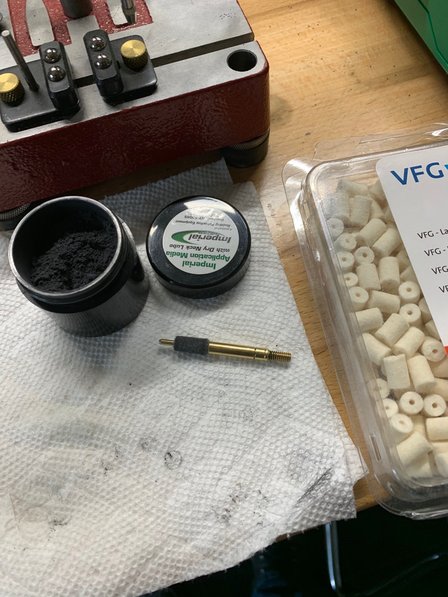

Here is neck lubing tip that's been working great for me.
Just take the next size down VFG pellet on their mandrel soaked with the imperial graphite & brush it through the necks. The pellet holds the graphite in the fibers well & doesn't make a mess. I tap the pellet over the graphite container as you don't want a bunch of loose graphite caked on the pellet, just even coating in the fibers. This has by far given me the most consistent seating pressure.
Edit Pic added:
