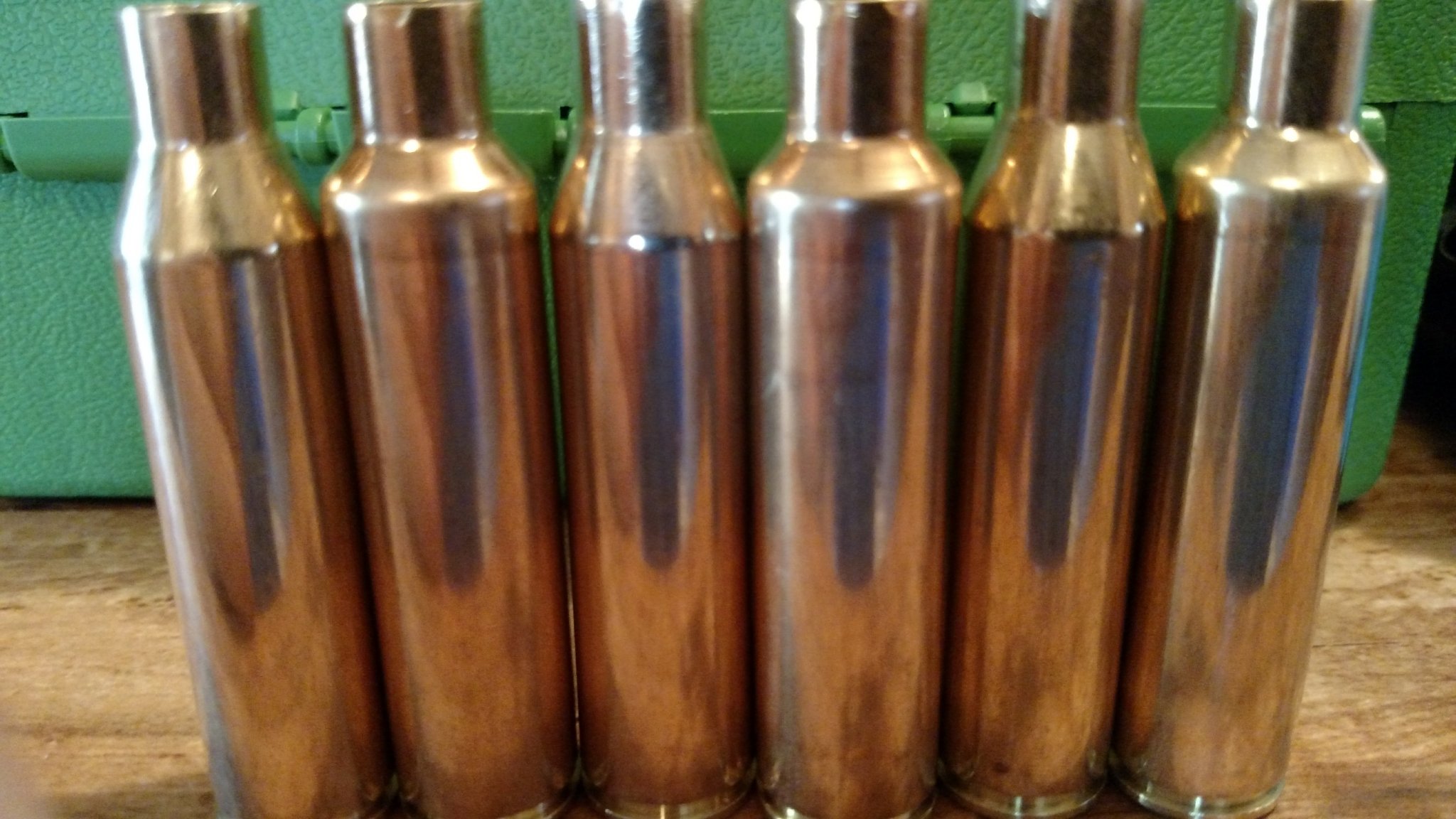

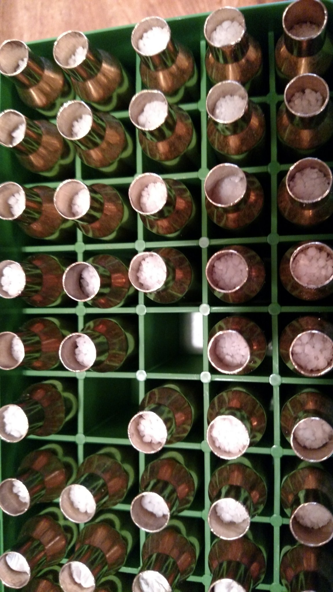

I use cream of wheat or Tapioca pudding for fireforming wildcats.
On Dasher or 300 Ackley or 338 Lapua Ackley Improved I use 16 grains of Red Dot then fill the entire case with Tapioca pudding.
I tap the case with a spoon to settle the pudding.
Put a piece of paper towel on top to keep the pudding from spilling and fire away.
