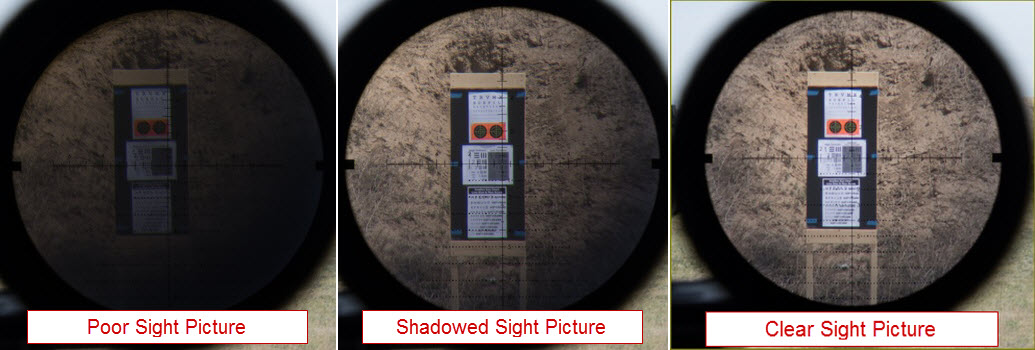

Maybe I'm misunderstanding what you're saying but I do not agree with your suggestion here, each scope (usually) is different with regard to eye relief, but beyond that also has a particular eyebox - that sweet-spot that allows some forgiveness when it comes to eye position. Most scopes have the most finicky eyebox at the max magnification so I recommend you set your magnification to the top then place your scope on your rail and hand tighten the ring/mount screws (so the scope doesn't fall off) in a position you think is right, then close your eyes and bring the rifle to your natural hold and get your cheek-weld, now open you eyes - do you see the full/clear sight picture or do you see tunneling or shadowing within the view? If you do not get a clear sight picture then move your head forward or back, if you move your head forward it means the scope needs to come back on the rail and if you move your head back it means your scope must move forward on the rail. Loosen the screws and move your scope to the new position you think is right then hand tighten those screws again, close your eyes and repeat the process. Once you get your scope in what you believe is the proper position so that when you blindly bring the rifle to your natural hold, do it several more times to verify and once verified you are ready to torque your rings/mount to the rail. If you find that no position seems to work then it may mean you have to work on your hold because your natural hold should be the same most every time, it should be muscle memory to bring that rifle into your shoulder pocket and get your proper cheek-weld. If you dial back on magnification the eye box should only improve from there. With this method I have found that most positions still allow a good sight picture through my scope. One other caveat, if you see shadowing at the top or bottom it may mean your cheek height needs to be adjusted up or down (if you do not have an adjustable riser or do not have a stock pack then you will need to get different rings to raise or lower the scope). The images below are intended to give you an idea of what I mean by shadowing, your natural hold should give you the clearest sight picture each and every time.
7110792
Now, with regard to the General's post above, if you've done all this and you're shooting a 338 Lapua (or something with a big kick) and you're getting smacked in the brow from the ocular of the scope, then you probably need to find a scope with longer eye relief.
