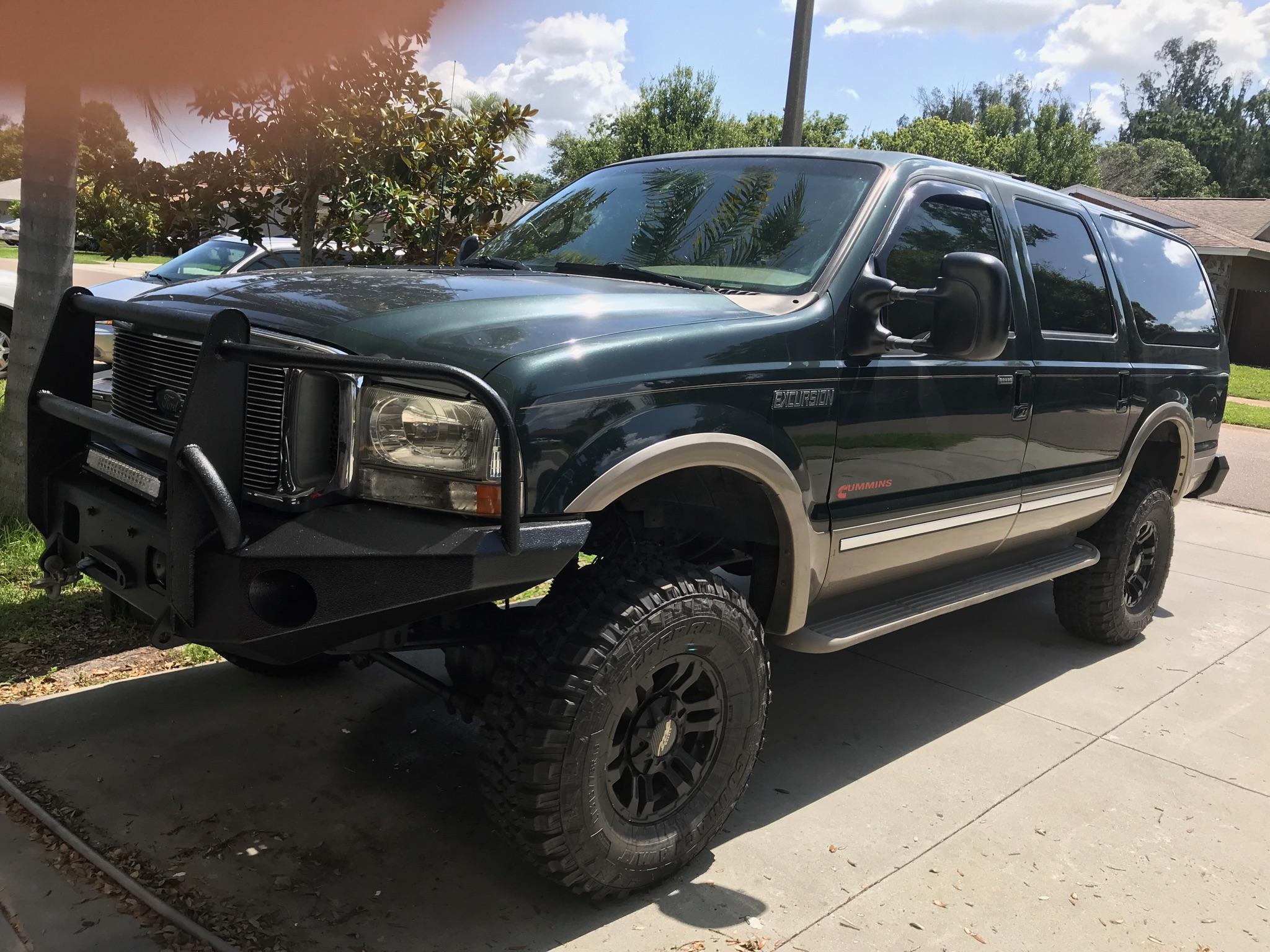

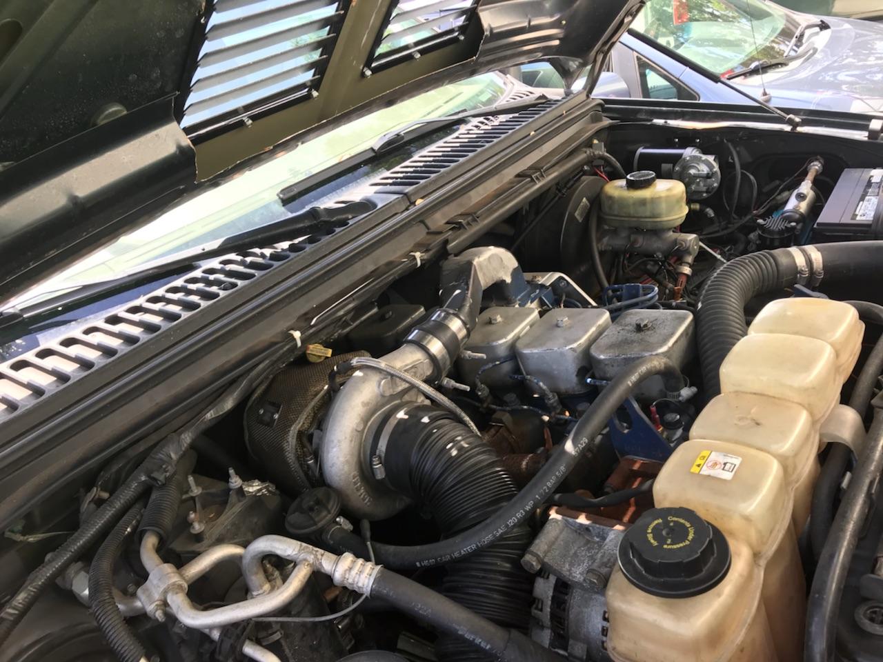

i sent some pics over to 1j to post up for me, if he so kindly will.
Here ya go buddy ;)
and i do thank 1jo4
thats my brothers truck, came w the v10, now has the cummins, its great.
he has no complaints, it worked out awesome, i think he is in the 20,s for mpg in the city also
i ll put together his contacts for parts and shark will be all like yabba dabba doooo
