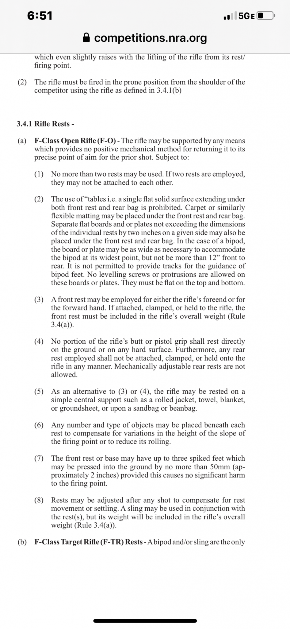

    Searching for answers :) I came across the NRA May 2018 F-Class rules.
    Seems there are some changes.
    The 2" wider rule has been clarified.
    There doesn't seem to be a half inch thick rule for boards.
    Maximum width has disappeared.
    F-Open:
    Carpet or similarly flexible matting may be placed under the front rest and rear bag.
    Separate flat boards and or plates not exceeding the dimensions
    of the individual rests by two inches on a given side may also be
    placed under the front rest and rear bag. In the case of a bipod,
    the board or plate may be as wide as necessary to accommodate
    the bipod at its widest point, but not be more than 12” front to
    rear. It is not permitted to provide tracks for the guidance of
    bipod feet.
    Any number and type of objects may be placed beneath each
    rest to compensate for variations in the height of the slope of
    the firing point or to reduce its rolling.
    A sling may be used in conjunction with
    the rest(s)
    , but its weight will be included in the rifle’s overall
    weight (Rule 3.4(a)).
    F-TR:
    In the case of a bipod, the board or plate may be as wide as necessary to accommodate
    rear.
