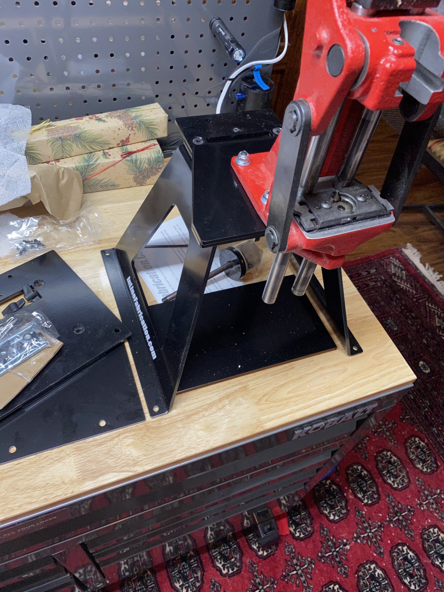

Anyone use threaded inserts as a means to attach a press or a riser like Inline Fabrication makes to their bench? Not T nuts, but threaded inserts.
for example:
They seem very strong. Table 1 on the following link shows their pull out strengthen red oak, to be about 886 pounds. Sunk in 1/2" and .376" diameter fastener
They seem like a nice way to allow the removal of a press and or riser. T Tracks look cool too, but I don't need all that movement.

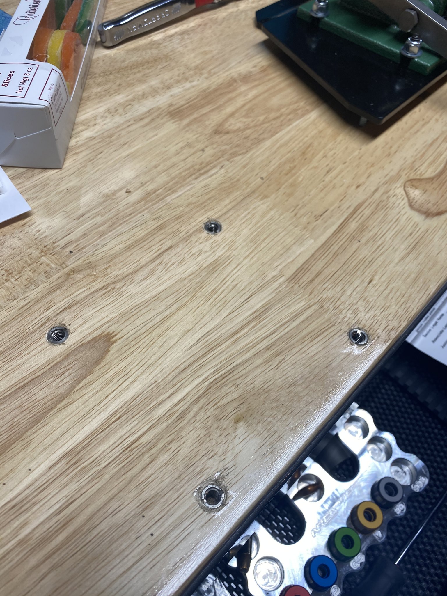

Threaded inserts work very well in hardwoods and even in pressed woods. They can be had for a lot less than shown in your link. T-nuts also work well when used properly. They both have their applications.

You do not use glue on threaded inserts. The threads on the outside of the inset is what holds them in the wood. The strength of the fastener is only dependent upon the type of substrate you are using them in, I.E. hardwood, particle board, soft wood, plastics, etc. Also, the material of which the inserts are made, I.E. brass, steel, cast metal, nylon, etc.
Used in a proper application and inserted correctly, inserts are a very good option for fasteners that may be removed and refastened and even modular furniture assembly.

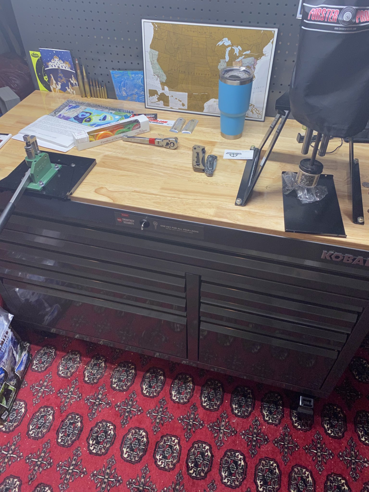

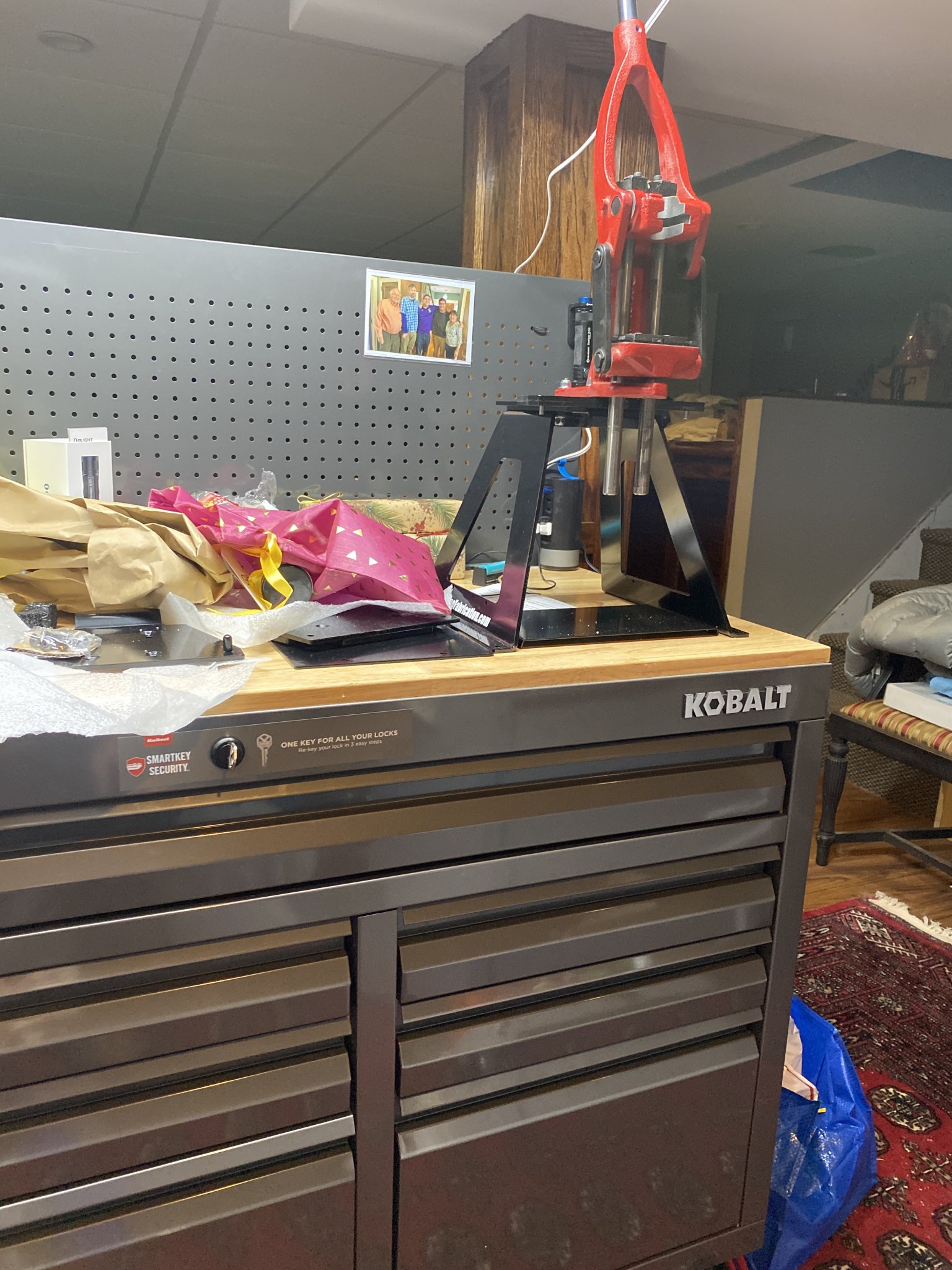

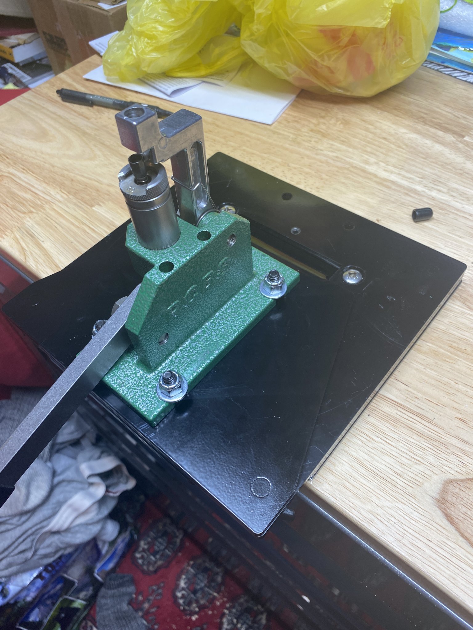

Ok, thanks for all the replies. I have both Inline Fab press mounts installed using threaded inserts and they feel very solid.
As a test, my buddy and I sank one into a 1/2" thick slice of poplar, and shock loaded it with a 50 pound weight and bounce tested it (aid climbing for any climbers reading this) with my buddy weighting it with a combined static weight of about 275 pounds and then bouncing on it, and it held no problem. They perform about the same as ice screws, and sink in nicely using a 1/4-20 screw and a double nut to jam and turn.
Yes, I really like the ability to remove everything and have a smooth bench, not that I need that option often.

I wanted stainless steel, so I ended up getting the stainless ones from amazon. Yes they were more money, but I also needed the shorter length, and I didn't need to pay for shipping as if I used another supplier.
