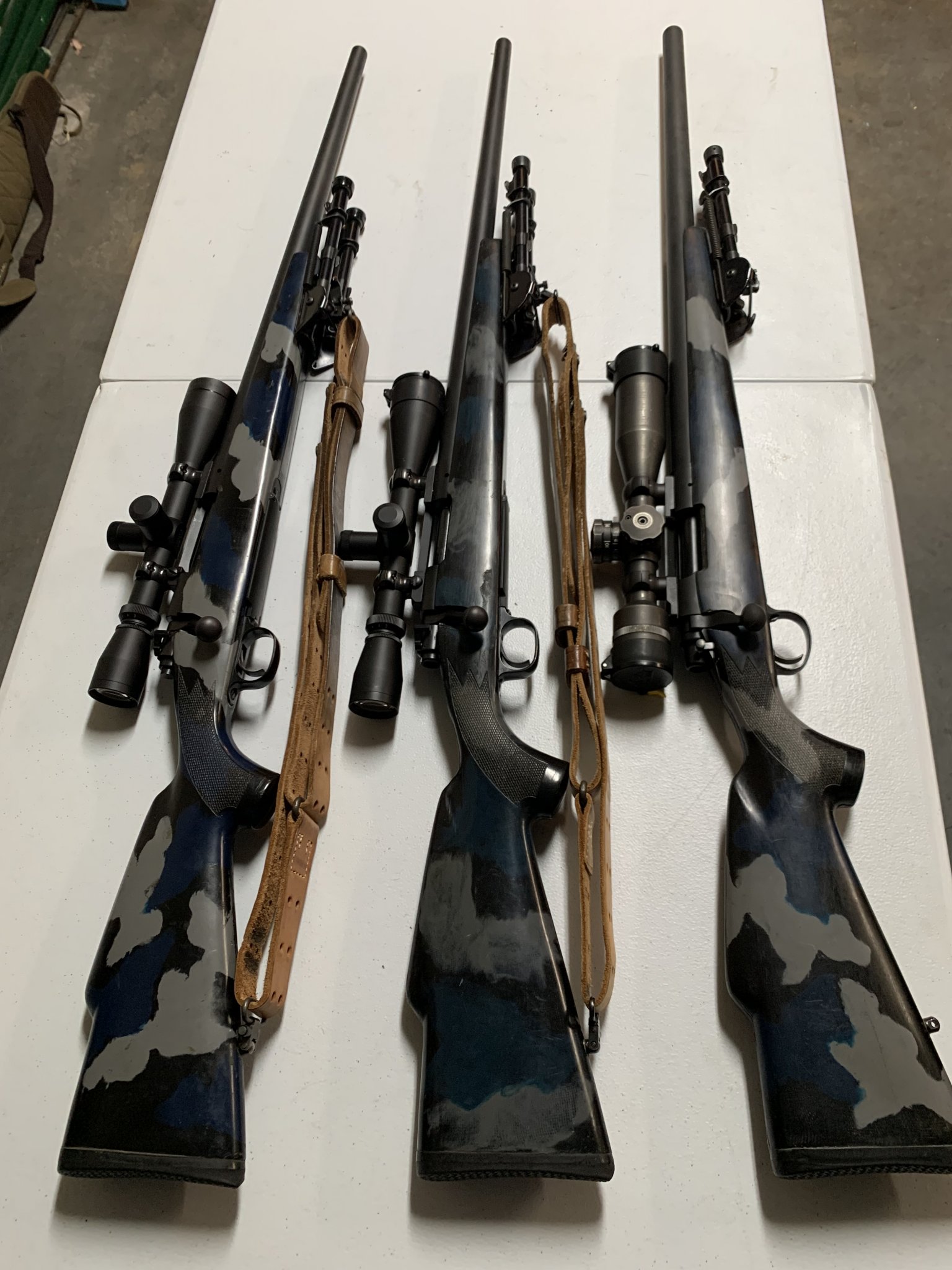

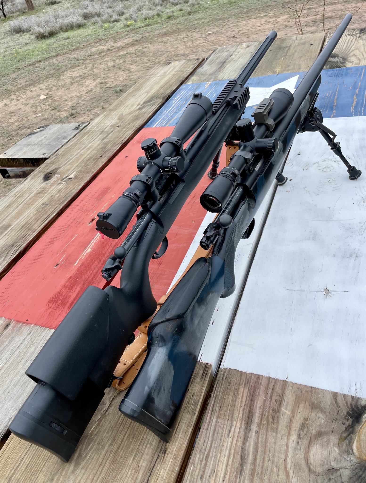

Few years in the making. Pretty much done👍. Need to go shoot them now…lol
Actually, they have been annealed. That, and the fact I have lots of them from the job over the yrs, is the only reason I’m futzing with them. I’ll try a couple more things before I switch to my Lapua stuff. I’d like to have a bunch of ammo I can just shoot and leave the brass where it falls. I think I’m gonna start taking some of these “old guns” to matches and have fun like I used to….

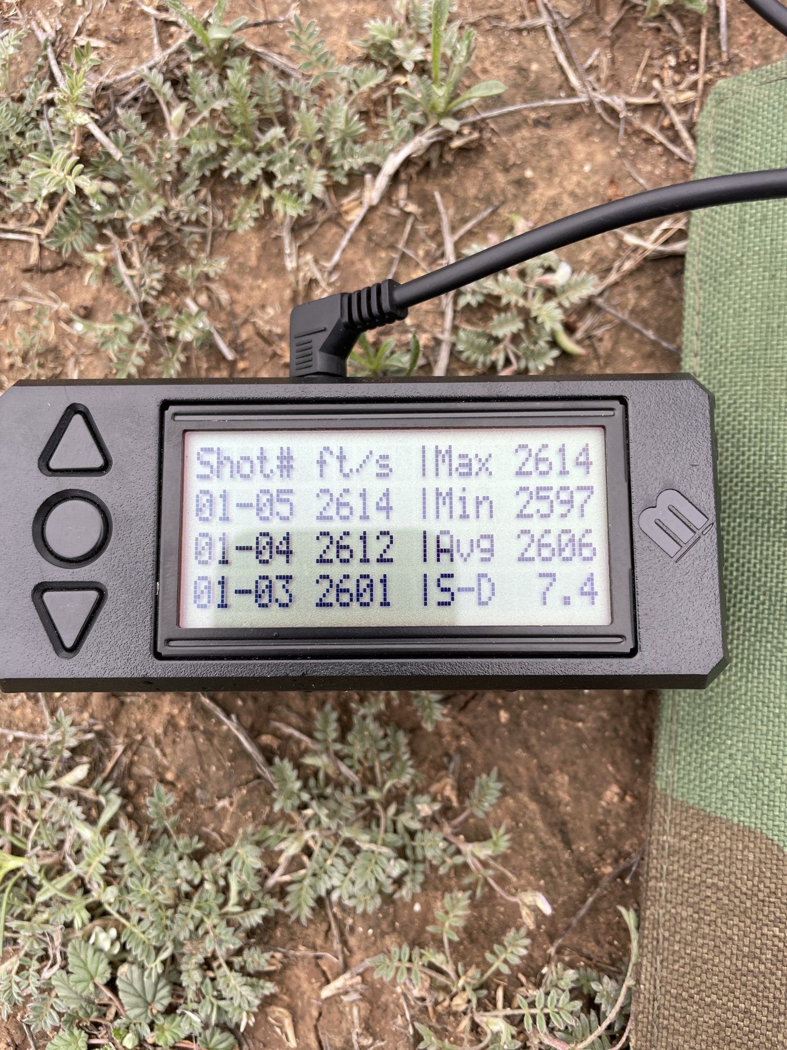

This was Fed GMM case, 43.5 Varget, BR2 primer, 180 SMK (I’ve got a ton of them), seated 2.82”

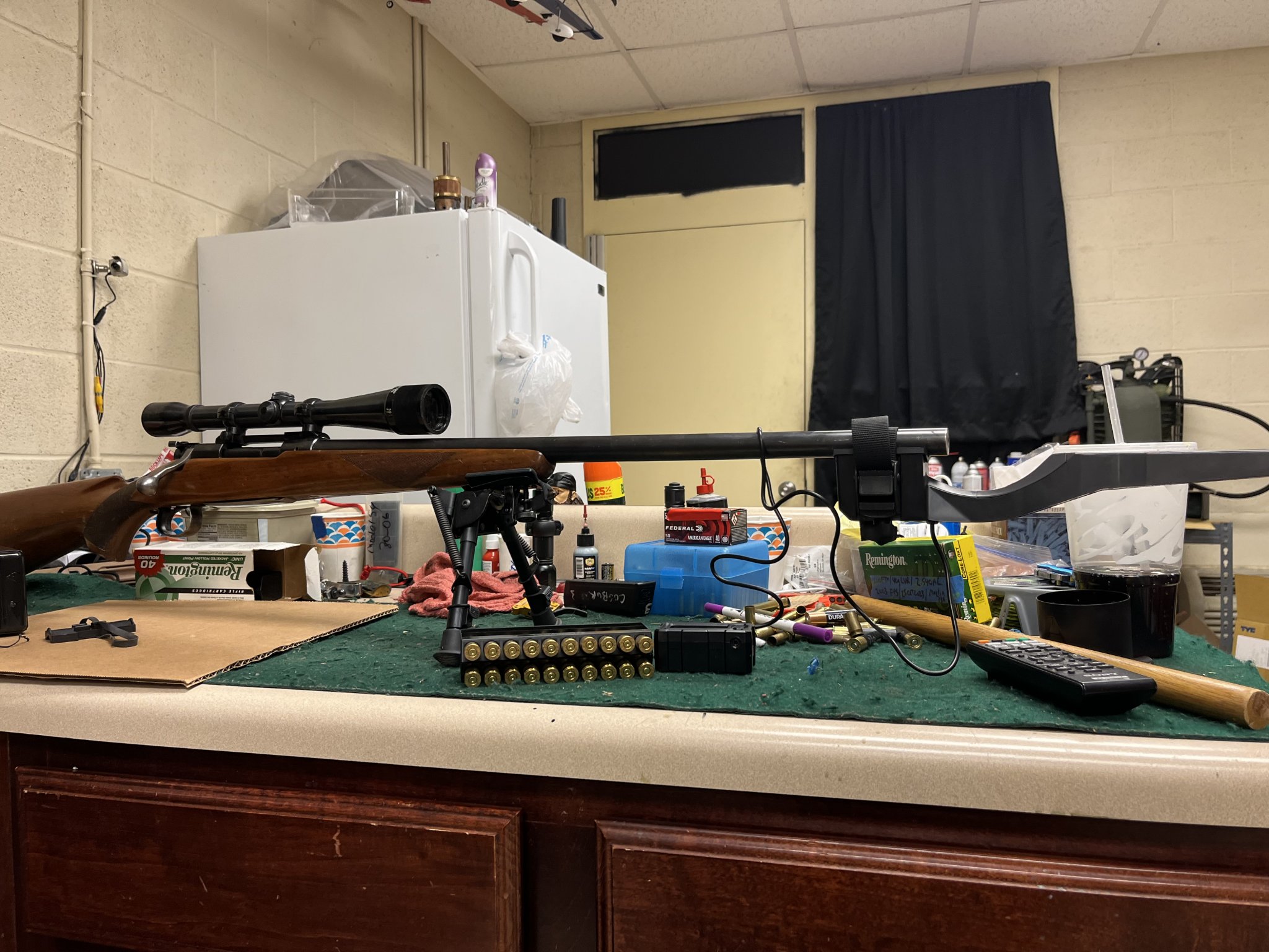

I've got several .308 rifles, but one of my favorites is an old sporterized 1909 Argentine Mauser that was converted to .308. My sons and I shoot in a military vintage silhouette match. (chickens, pigs, turkeys and rams at 200-500 meters). Sometimes I shoot "as issued" with a Swiss K-31, but got the sported Argentine to use in the "vintage military sporter" class. The Argy likes 42.6 grs of IMR 4064 with the Nosler 175gr CC, CCI 200 primer, in FGMM brass. COAL 2.810.
It doesn't do badly for a 110 year old action with a barrel of unknown make, and a cheap Nitrex 3-9 scope...

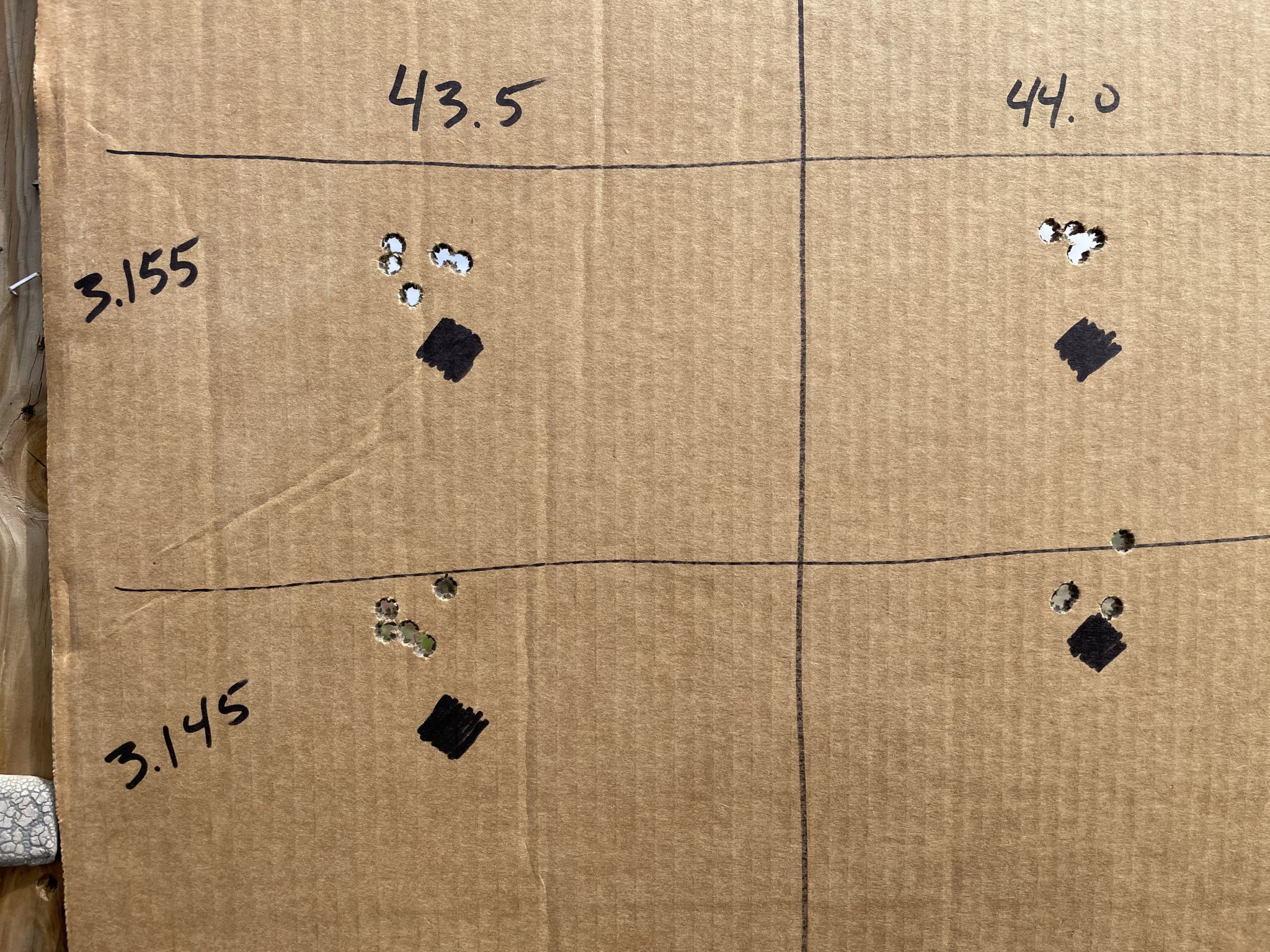

After settling on 42.6 grs of 4064, I dicked around with the COAL and it seemed to like 2.810 best. Target from my COAL testing. 2.810 in bottom right.

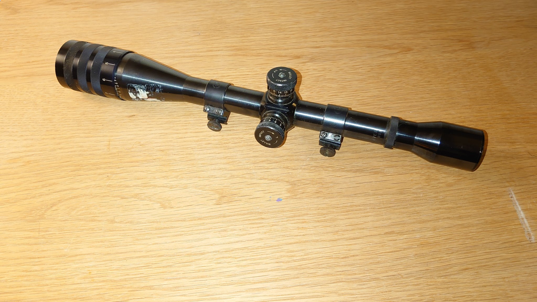

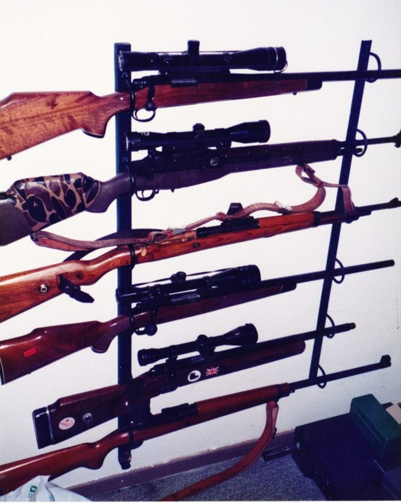

In the beginning of the 80'ies I was sponsored by Winchester Europe with a Win M70 Varmint in 222rem and a Weaver T16 for international moving target shooting in the old Olympic event "Running Deer 100m".
I still have the T16 scope:
I have an old insurance photo from app 1985 of the rifle with the T16 mounted, 3rd from bottom.
Top was my silhouette rifle, M700BDL Varmint in 7-08. The Leupold 6.5-20X40 with Leupold dot is one of the first five such scopes ever produced. As a young student in the 70'ies I ordered five from Leupold. I received a telex were they asked if the order was correct :)
Second from top is a Winchester M14 with a S&B PM 6x42 with bdc with 100m clicks from 1 - 800m. Above 300 there were also 50m clicks.
Bottom is a Kongsberg M59F1 in 7.62NATO with sidemounted scope (not pictured) as issued from the Norwegian National Guard. This specimen was a genuine .7moa rifle with selected Raufoss 147gr NATO ball ammo.
