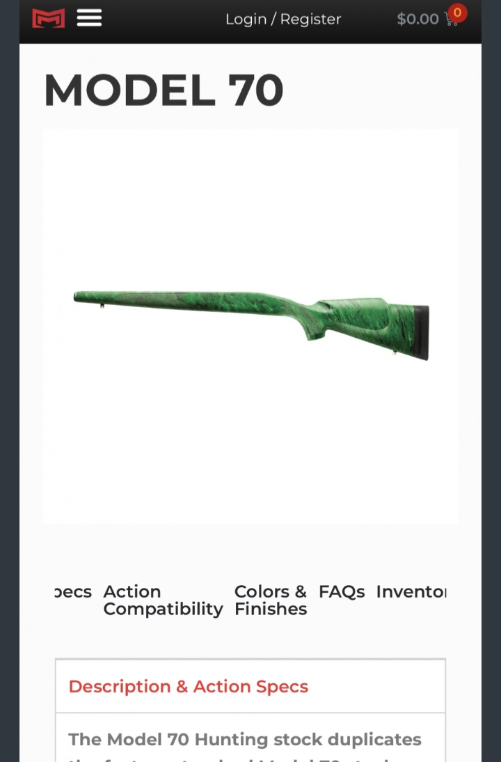

Interestingly I called McMillian to see what information they had as far as stocks, inlets and bottom metal, they mentioned other actions. It seems that once HRT moves on to another rifle, the field office SWAT Teams get the hand me downs.

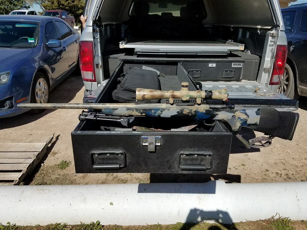

Awesome photo, nice rig. Looking closer at the screen captures I posted wondering if that first rifle being held is actually a Model 70?
Thanks again there’s not much data out there on these early rifles

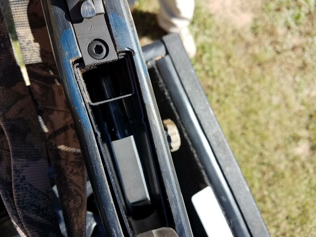

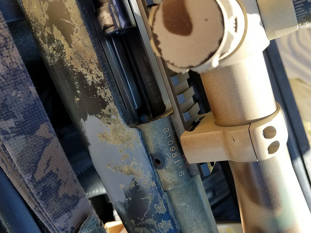

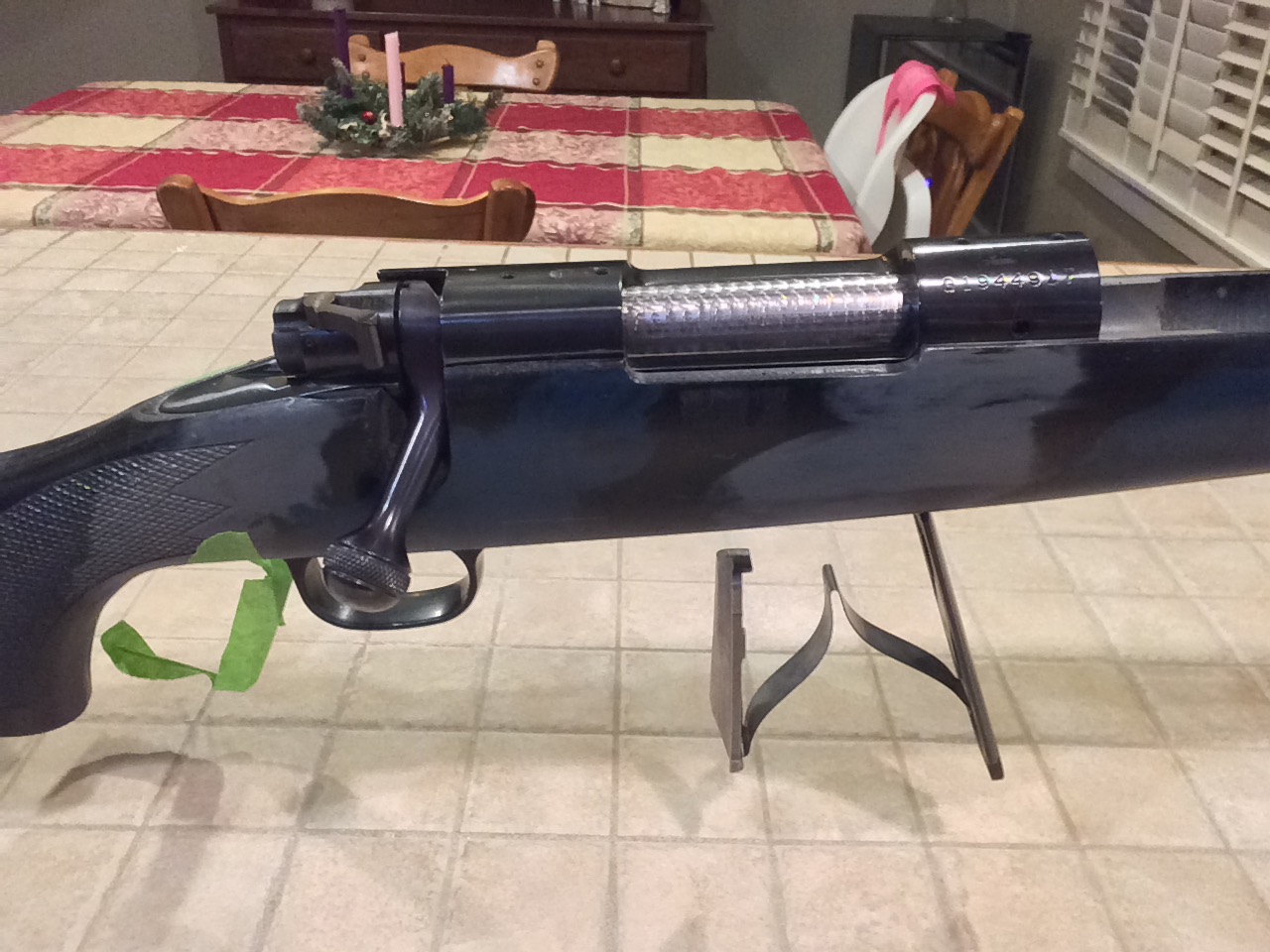

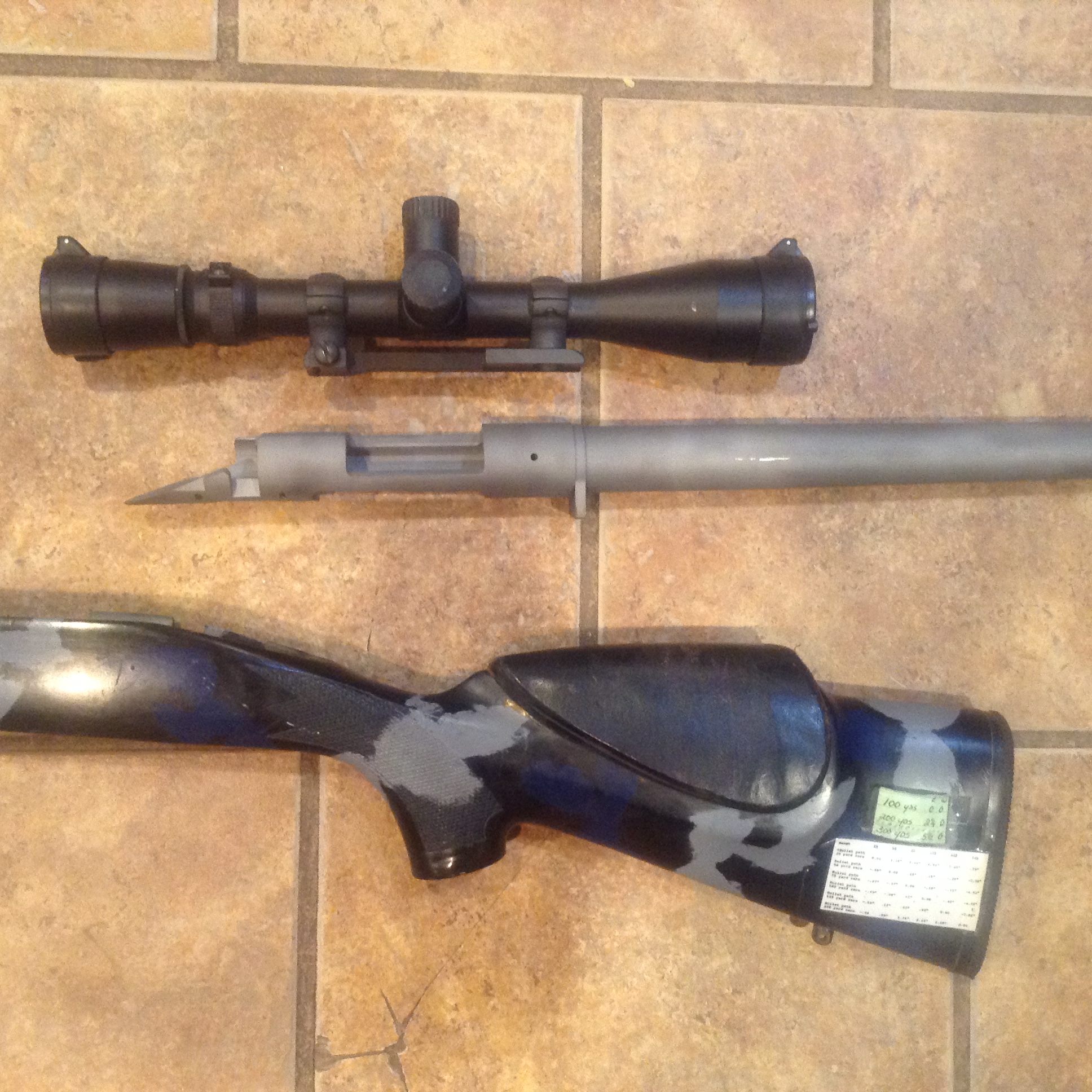

There were some short M70's as well! Here's one I'm working on. The stock had a short inlet and it took me awhile to find out what the original serial was so I could hunt for an action with similar serial number.
Unfortunate Truth!
There were some short M70's as well! Here's one I'm working on. The stock had a short inlet and it took me awhile to find out what the or initial serial was so I could hunt for an action with similar serial number.View attachment 7347730
I've seen and shot one of those. A lot.
