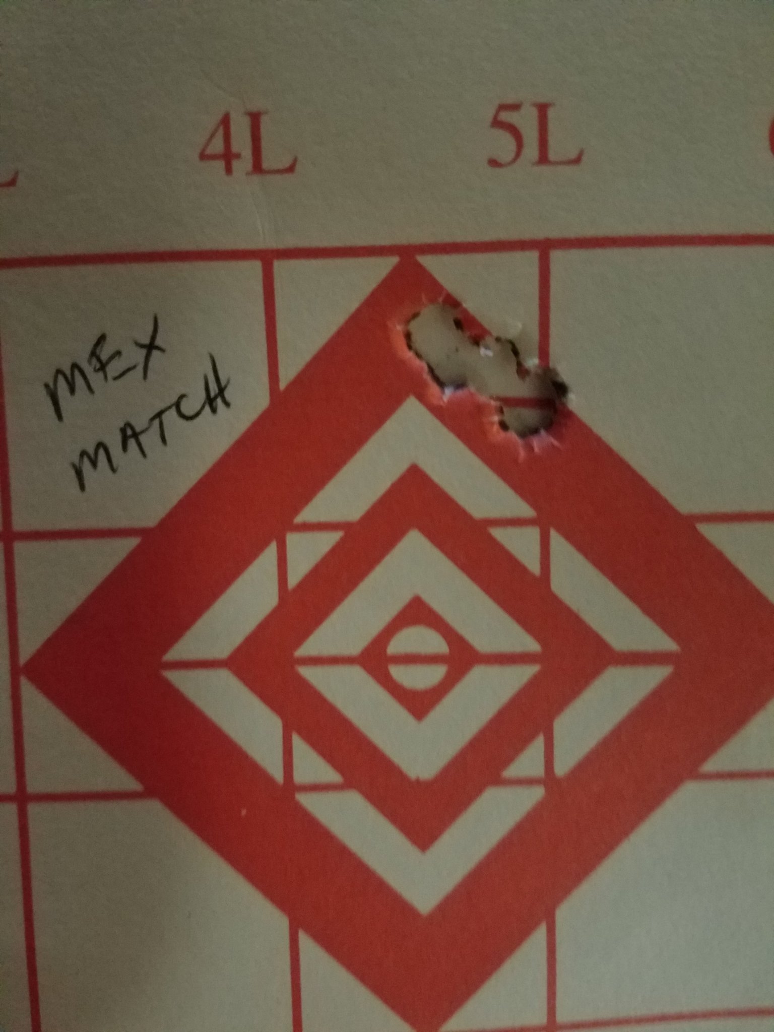

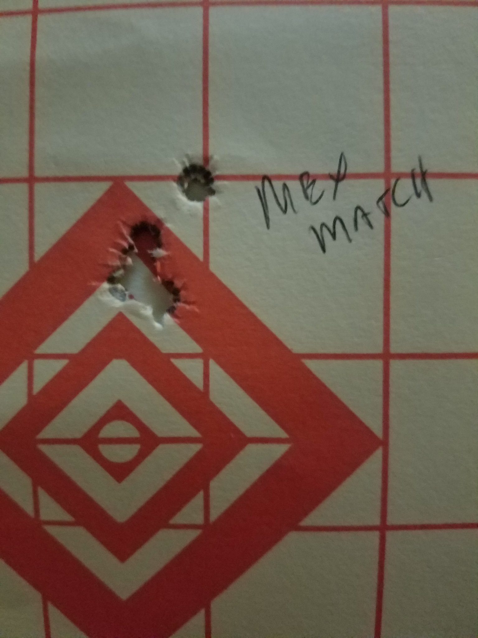

    I did pull 20 of them and made the Mex match per the JP video above. I will shoot those tomorrow BUT one of the first I checked is still stiff on closing the bolt. I finally bought a box of the Fed. 90SMK and I'm not getting that with it either.
    This is the result of using JP's Mexican Match recipe with 77 TMKs. These were doing an average of 3150 out of my 26" Krieger.
