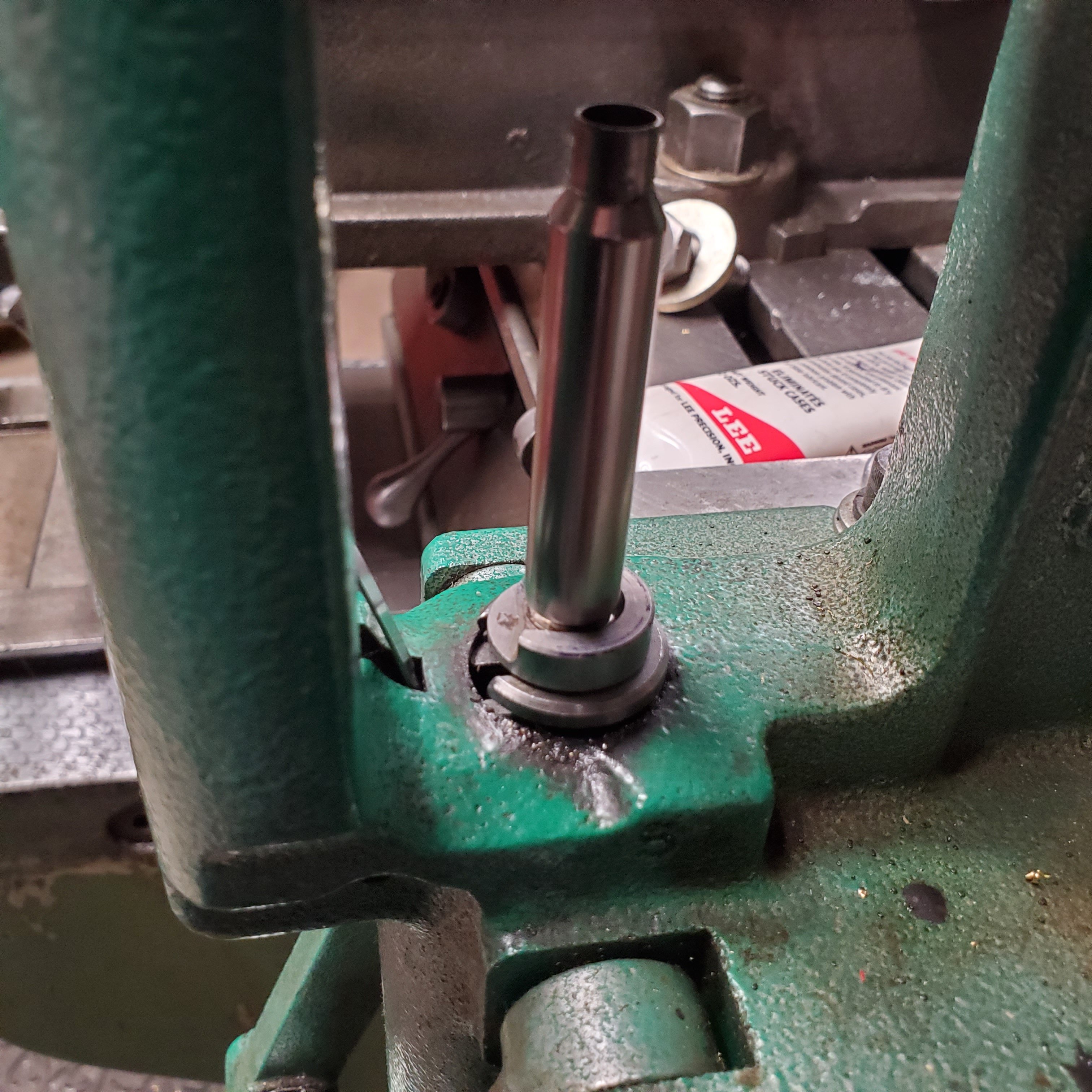

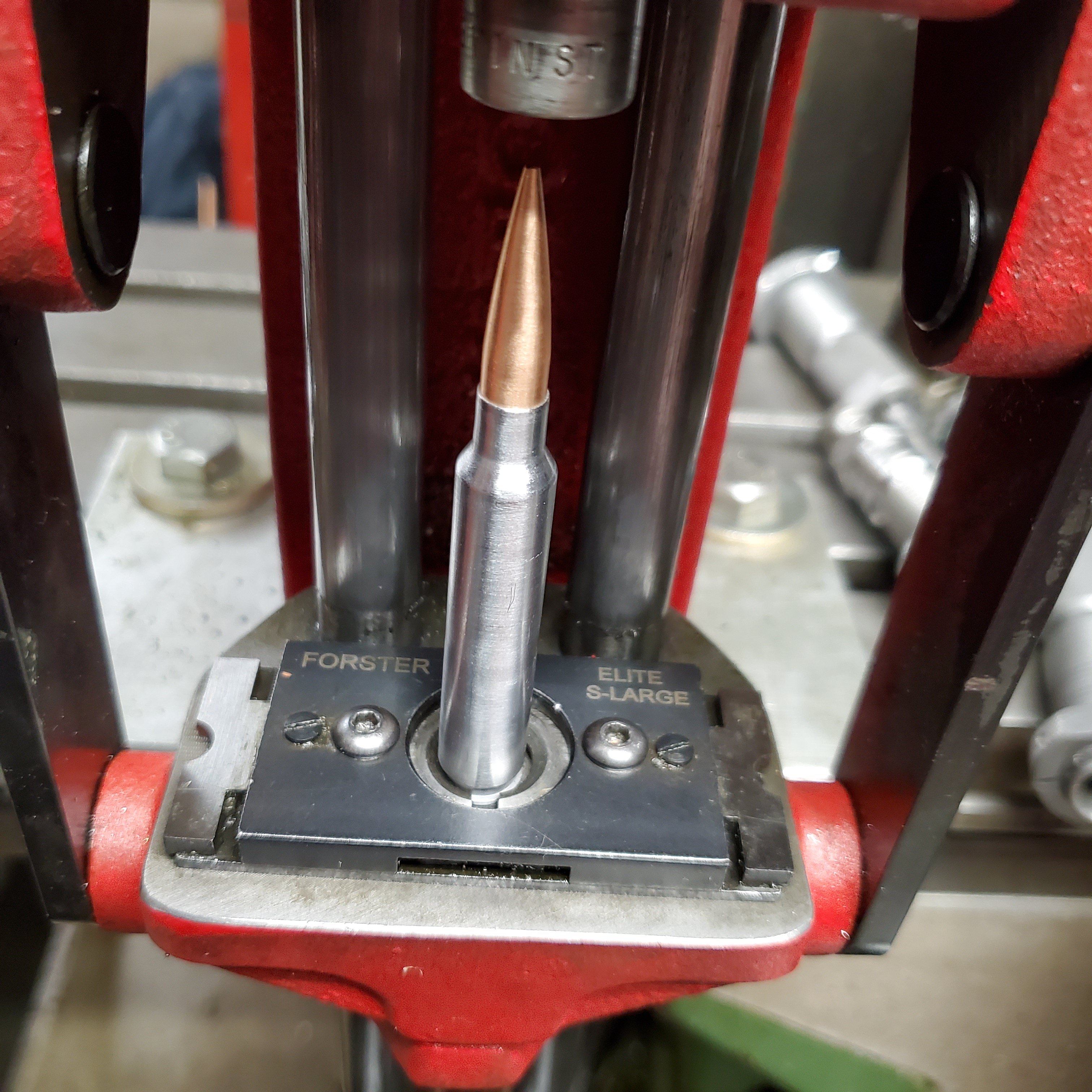

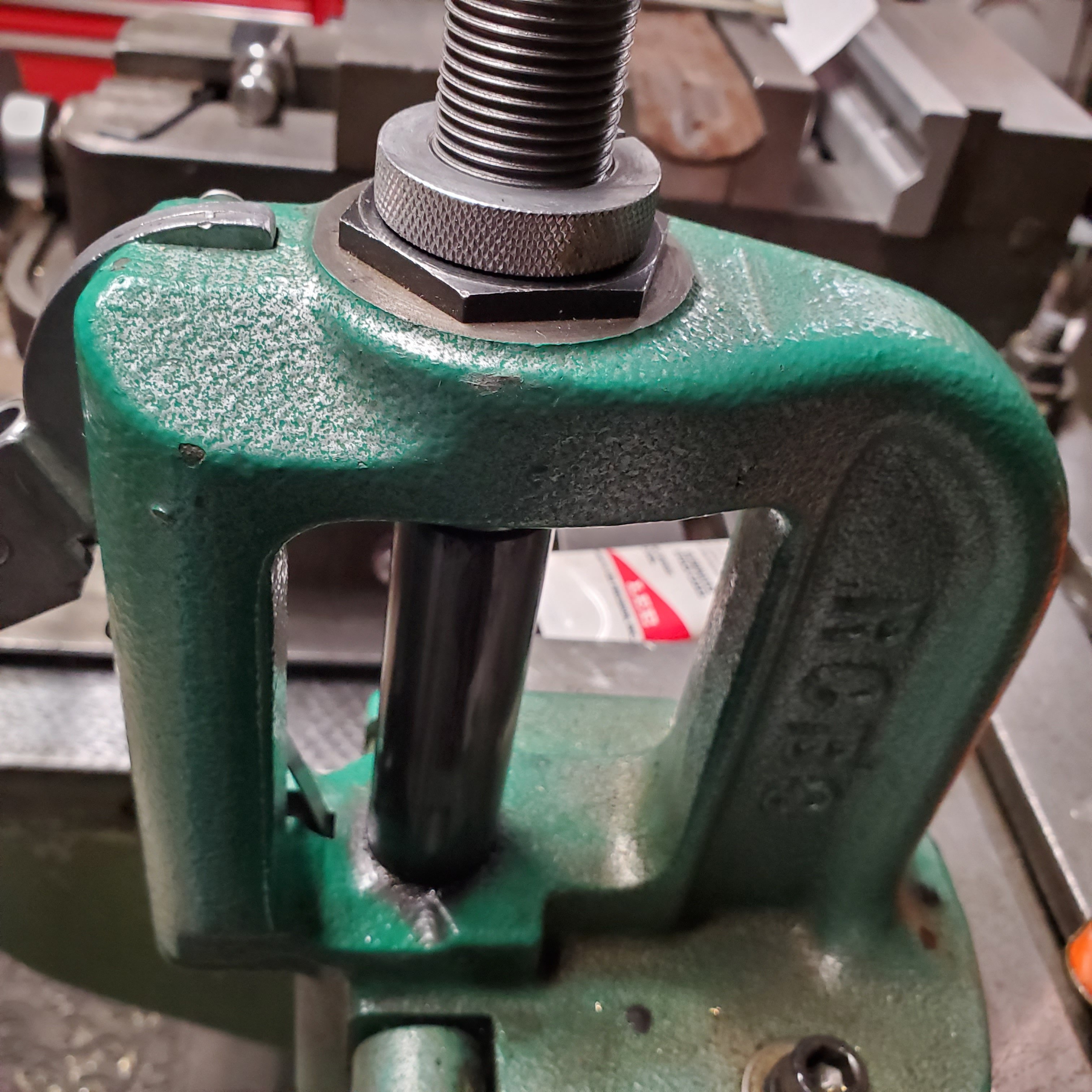

Federal already has loaded ammo and there are rifles ready from a bunch of manufacturers...seems faster than Hornaday to me.

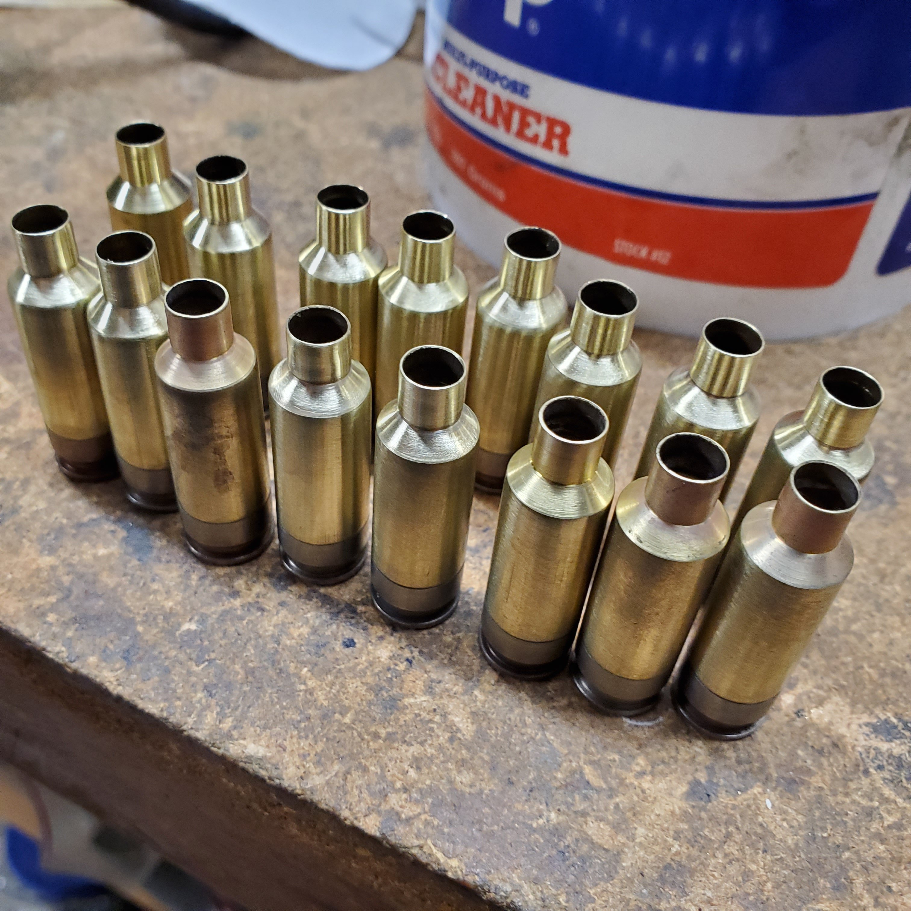

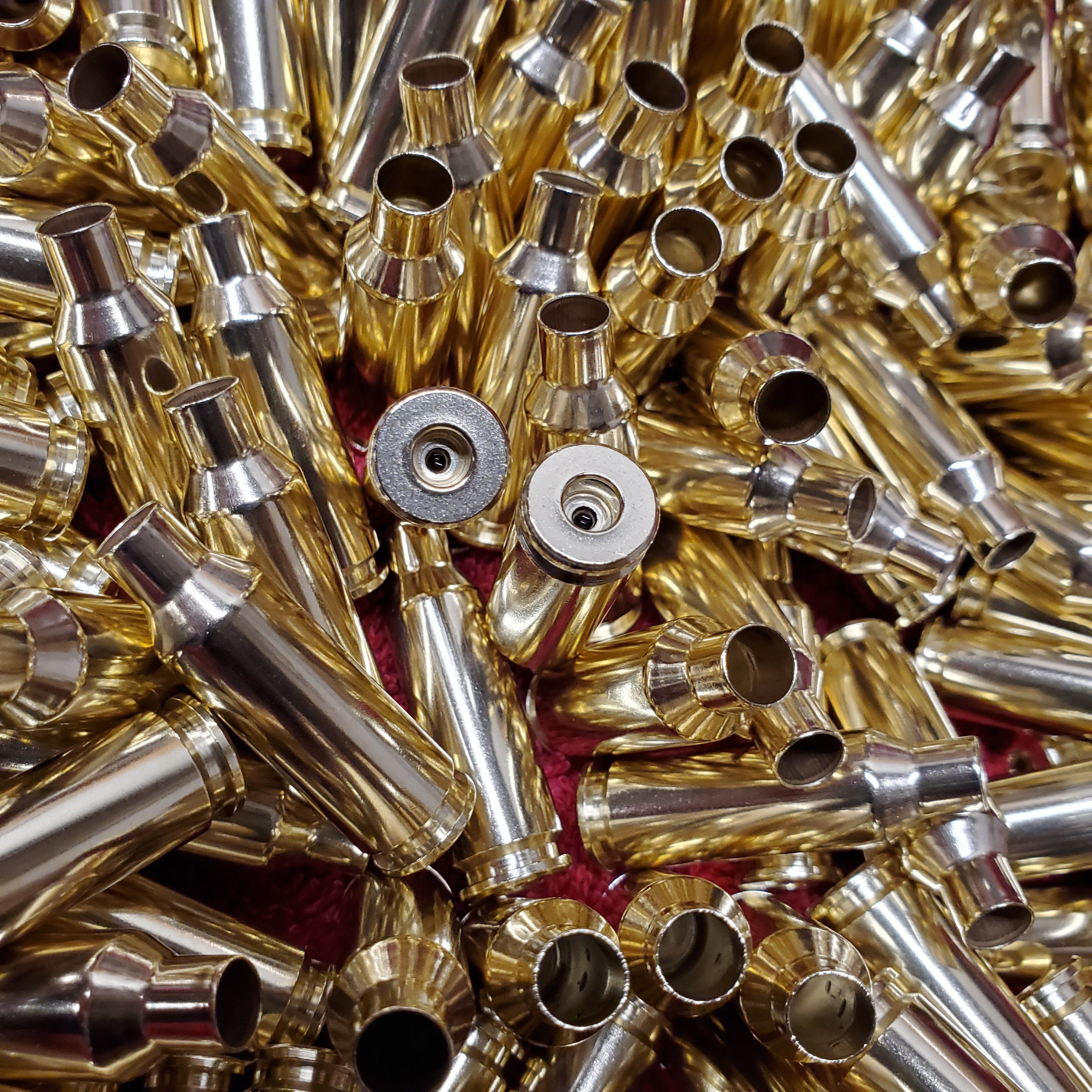

I took over a year for Hornady to get ARC dies and reloading cases in their 6 mm & 338 ARC calibers, and no reloading data, same deal...so I made my own brass, for both, and even chambered the 338 ARC barrel.
Never fired a factory round in any caliber I own, but here is where you can get their nickeled steel cases....and cases could be made out of other brass cases, while ya wait for the steel cases.
If ya want to reload for it now or wait... that's up to you.. same as in 1962.
So sometimes I make the dies to make the brass...look no head stamps on 250 pcs of formed brass cases these are 6 mm ARC when Hornady failed to get brass to the market. ...or the first ever 6 Dasher hybrid cases...when no one is making brass for you, or your shooting an obsolete caliber, like 401 WSL, or 30 RAR, you can make it yourself.

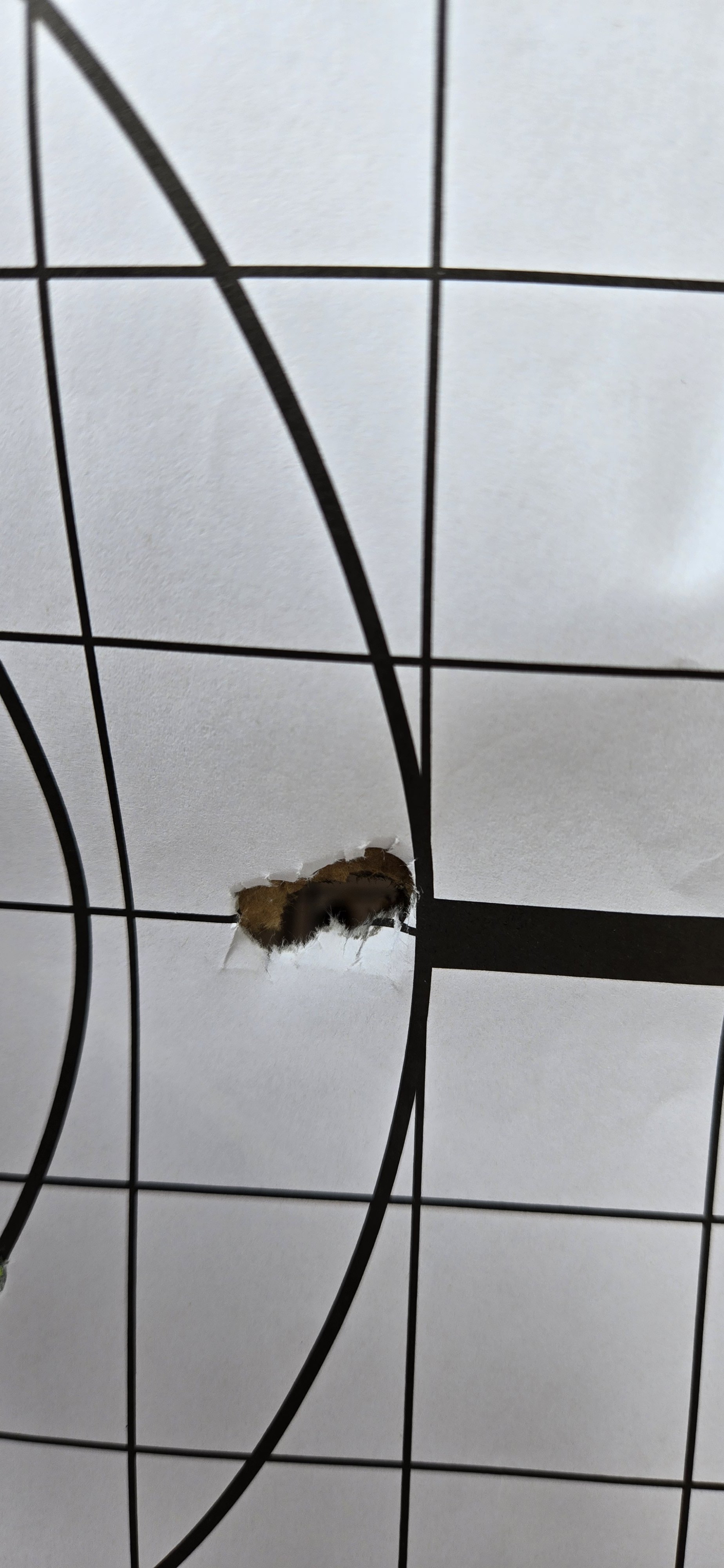

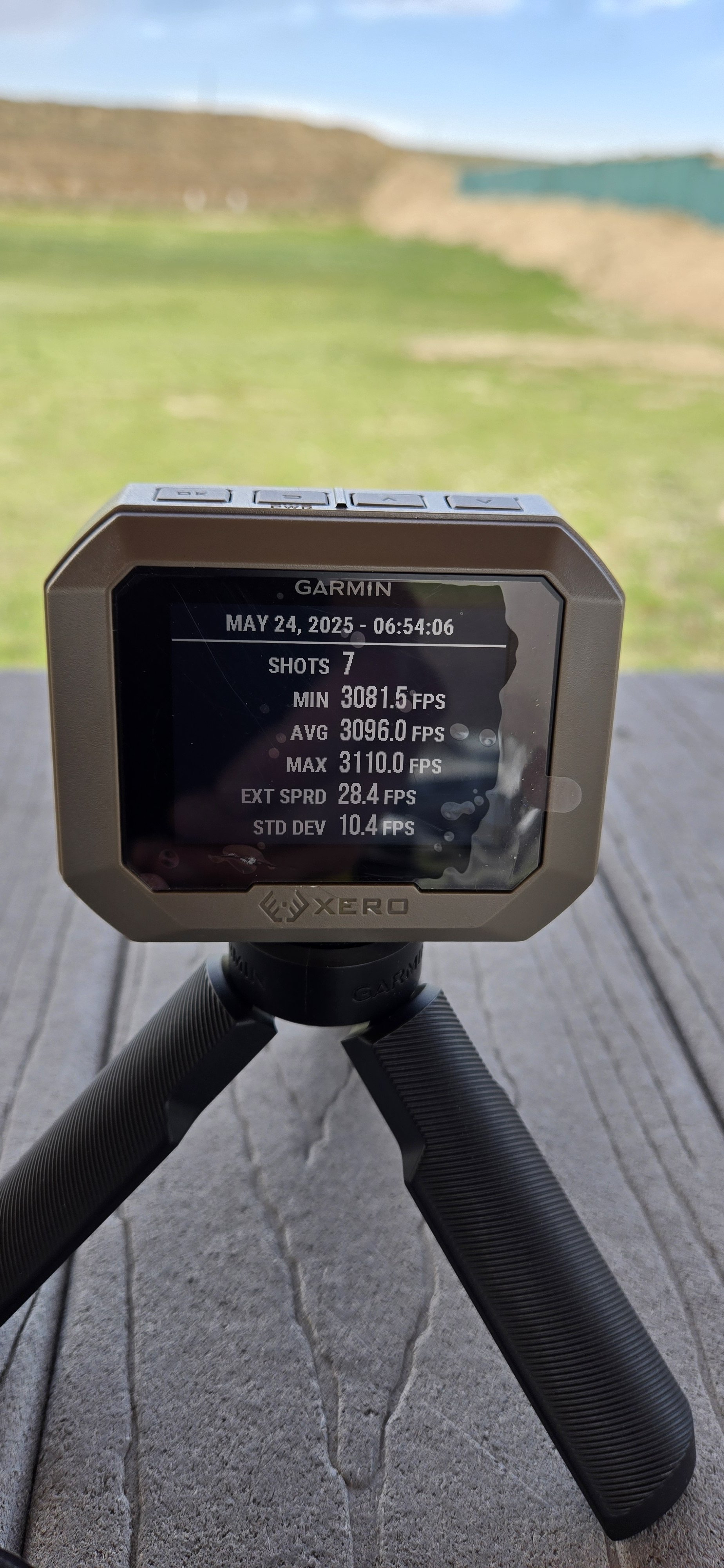

Very first few rounds though the rifle. Picked up from Fritz yesterday. 22" proof carbon barrel with TBAC on it. 3085 fps with the 170s. Only 3 rounds fired. 3110 fps with the 168s. Only 3 rounds fired of that also. Just a quick baseline number before I head out to zero it and shoot some groups. Guessing I'll end up easily over the 3150 box number pending how much this barrel speeds up.
Both of those loads are hauling the mail for a 168gr or 170gr pill.
I’m happy with 3150 out of a .280 AI slinging 140’s, so 3150 with a considerably heavier bullet is pretty impressive to me, especially considering the size of the case.

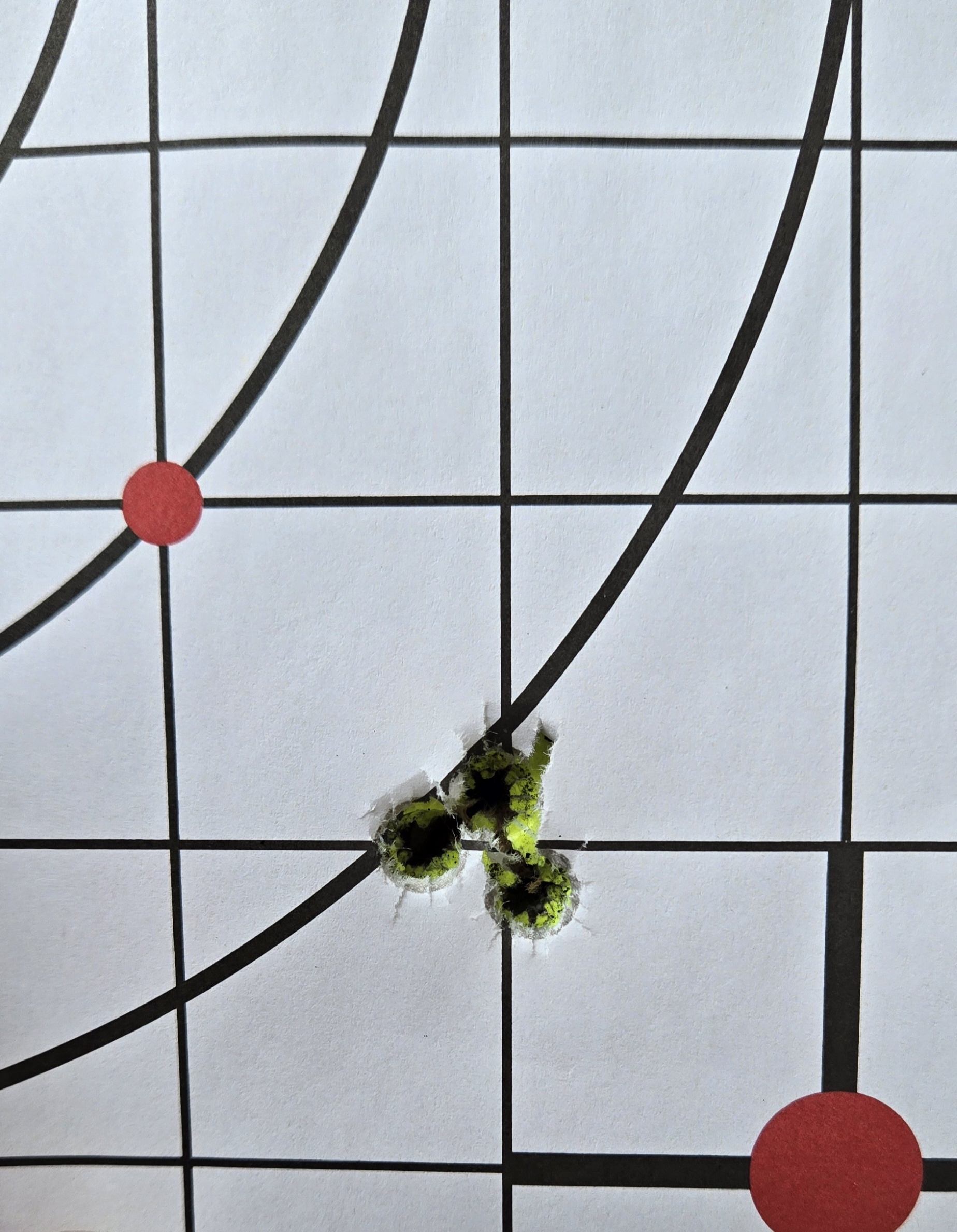

First 3 rounds of 168s are first pic. Second Pic are the first 3 rounds of 170s. Chrono pic is of 7 rounds of 170s.
Didn't have much time today and maybe shot 15 rounds total between the two.
