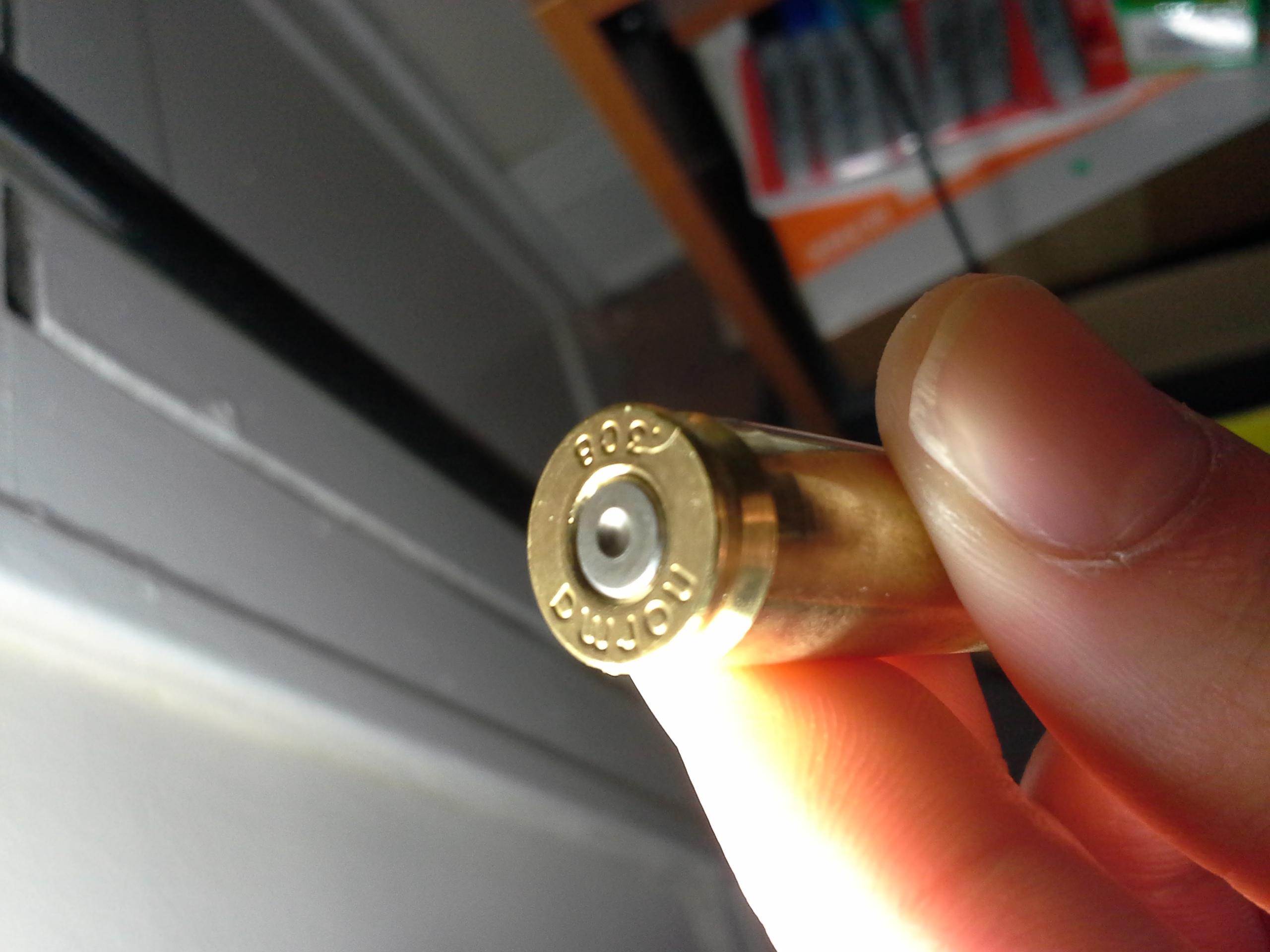

FGMM 175 @ 2430
Hornady 168 match

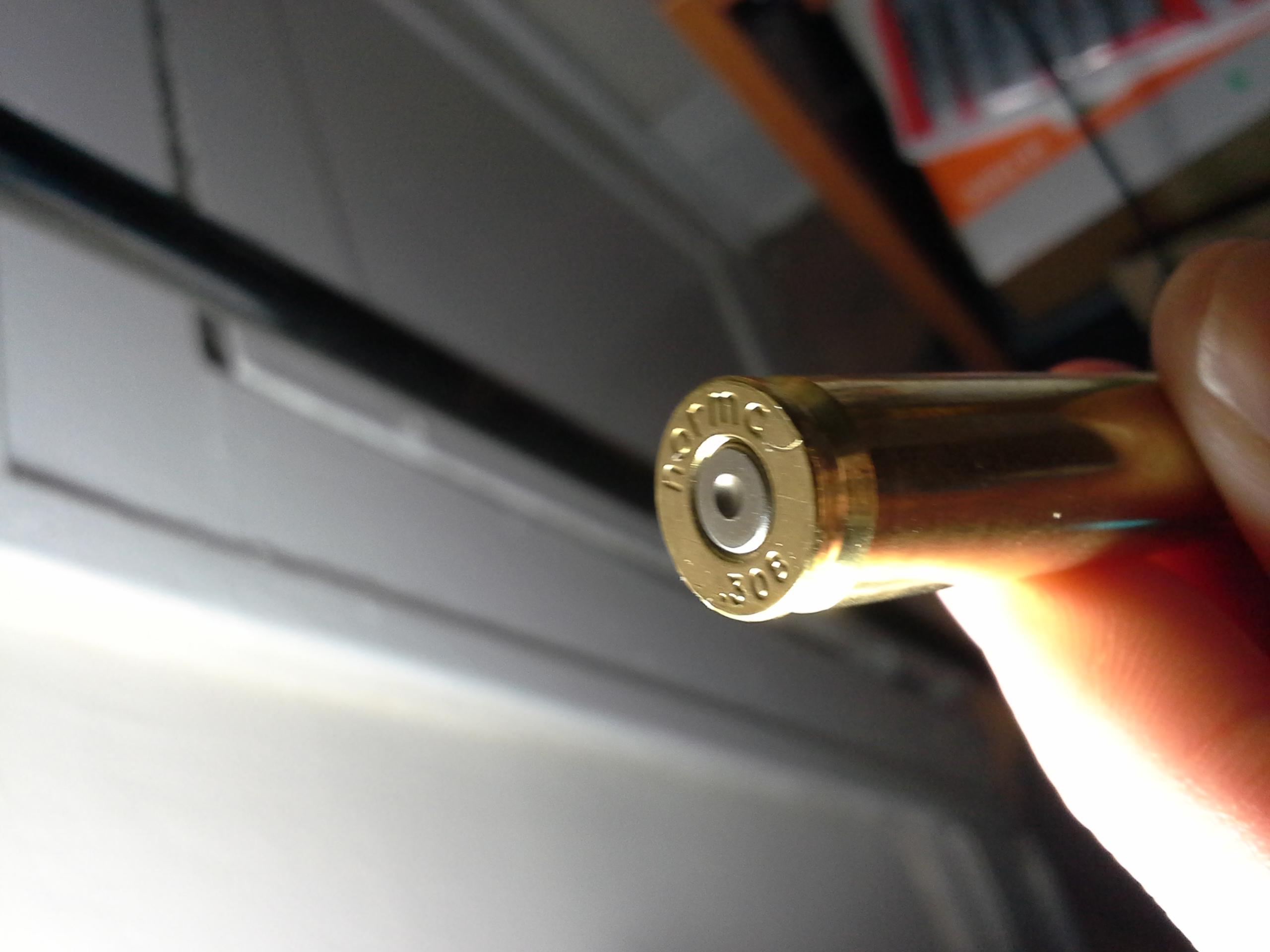

Brand new Norma brass with 185 juggernaut, 42.6 varget, CCI 200, 0.02 off lands @ 2430

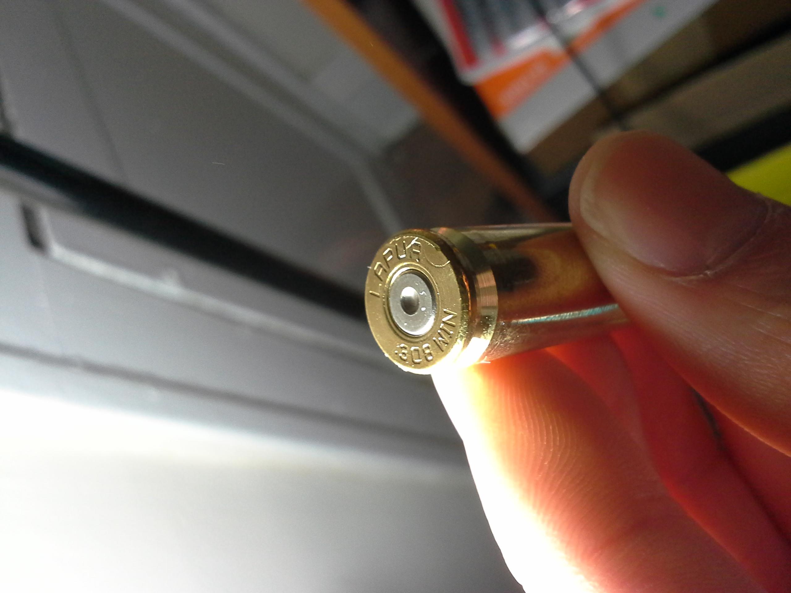

Brand new Norma brass with 178 HPBT, 43.6 varget, CCI 200, 0.02 off lands @ 2510

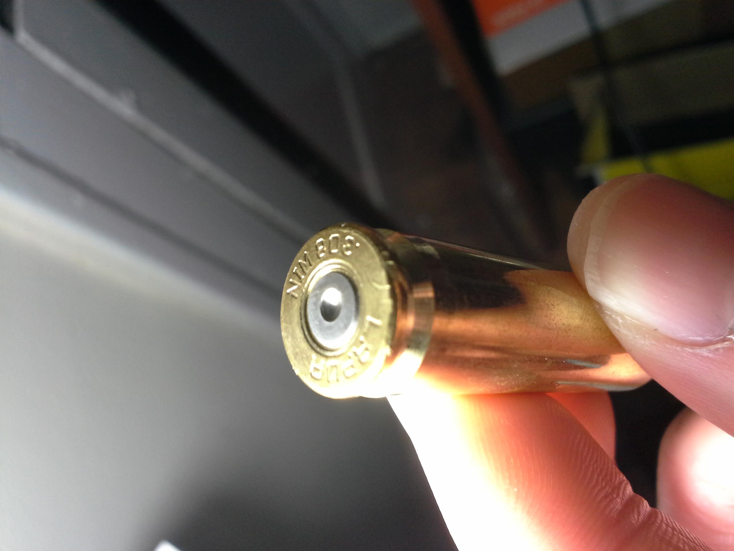

Brand new Lapua brass with 175 SMK, 42.2 IMR 4895, CCI 200, 0.02 off lands @ 2480[/QUOTE]

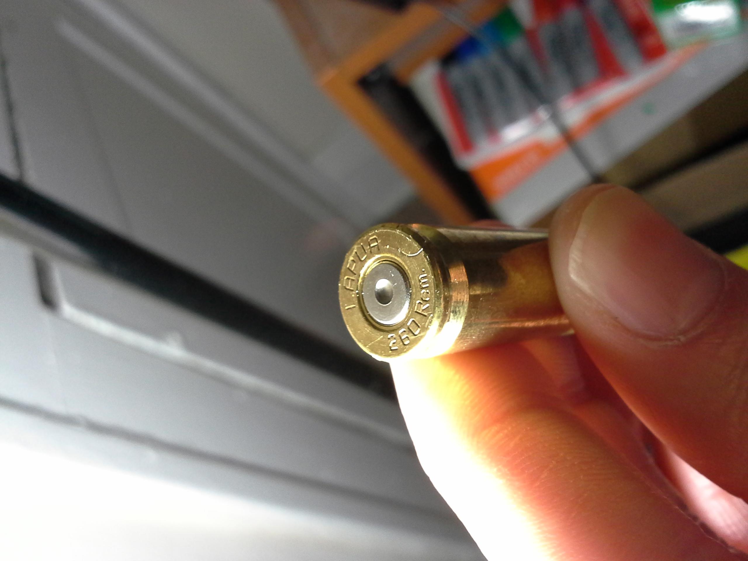

Brand new Lapua, 139 Scenar, H4350 42, CCI 200, 0.02 off lands @ 2750

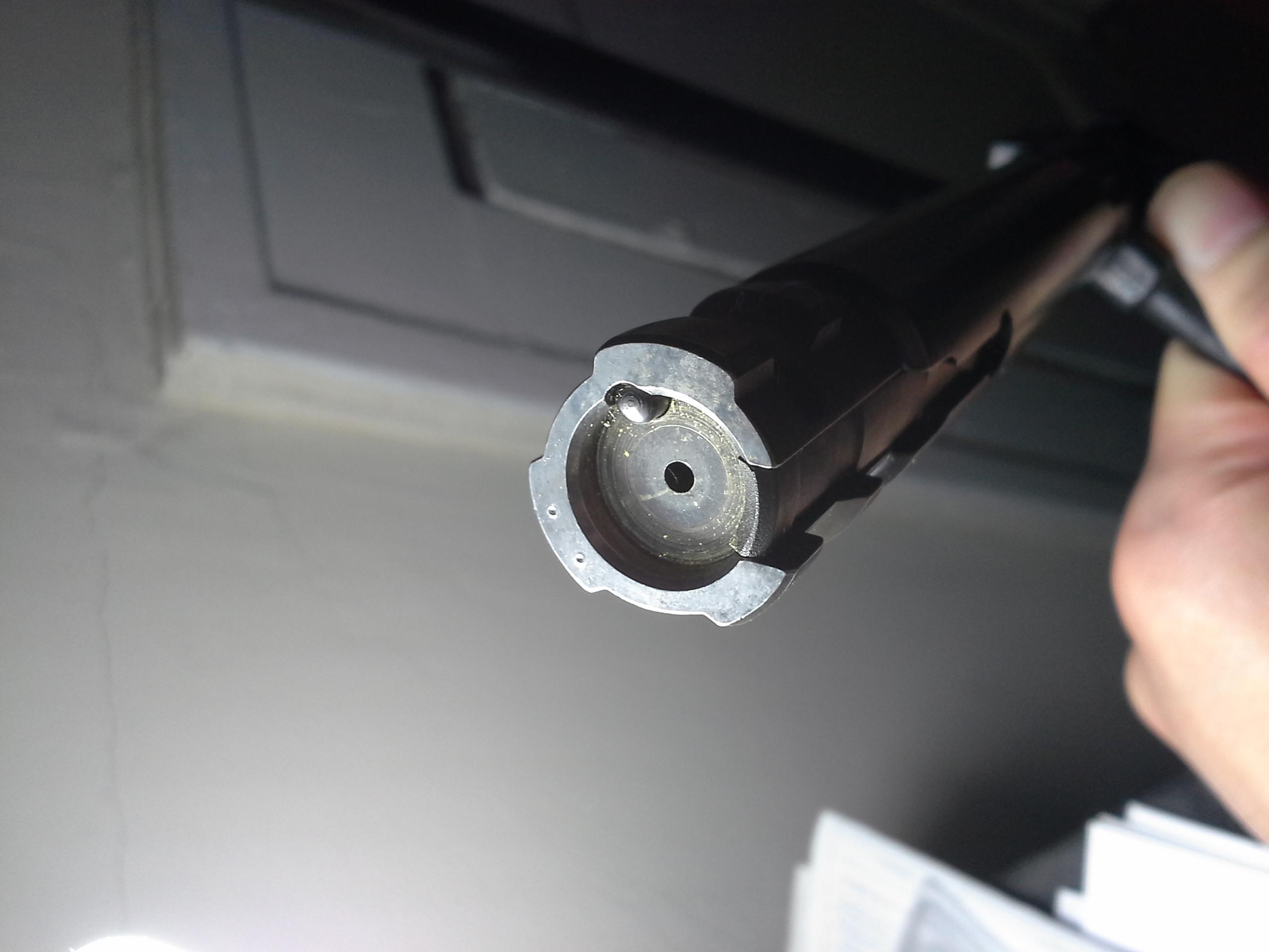

Bolt face
Are all the loads over-pressure? This is really confusing...Any thoughts?
Really strange, does your ejector have any spring tension at all? If the bolt face is not completely smooth and you have the raised edge in the ejector hole/spot as stated above the circle on the brass would happen. Just contact maker and send the rifle/bolt back to be repaired.
Its hard to tell from the pictures, are the marks raised like flow or just marks left in the brass? Is the bolt cutting any off?
I have seen this on factory FGMM in my AE MKIII, the difference is that is very soft brass. But the primers show no signs of problems,
As another measure of pressure, all of your primers look very conservative, clean radius on them.
The marks are not raised. Just sharp cuts. May be sharp ejector edge is a good explanation. I have been loading hotter loads without any problem. Thanks!
