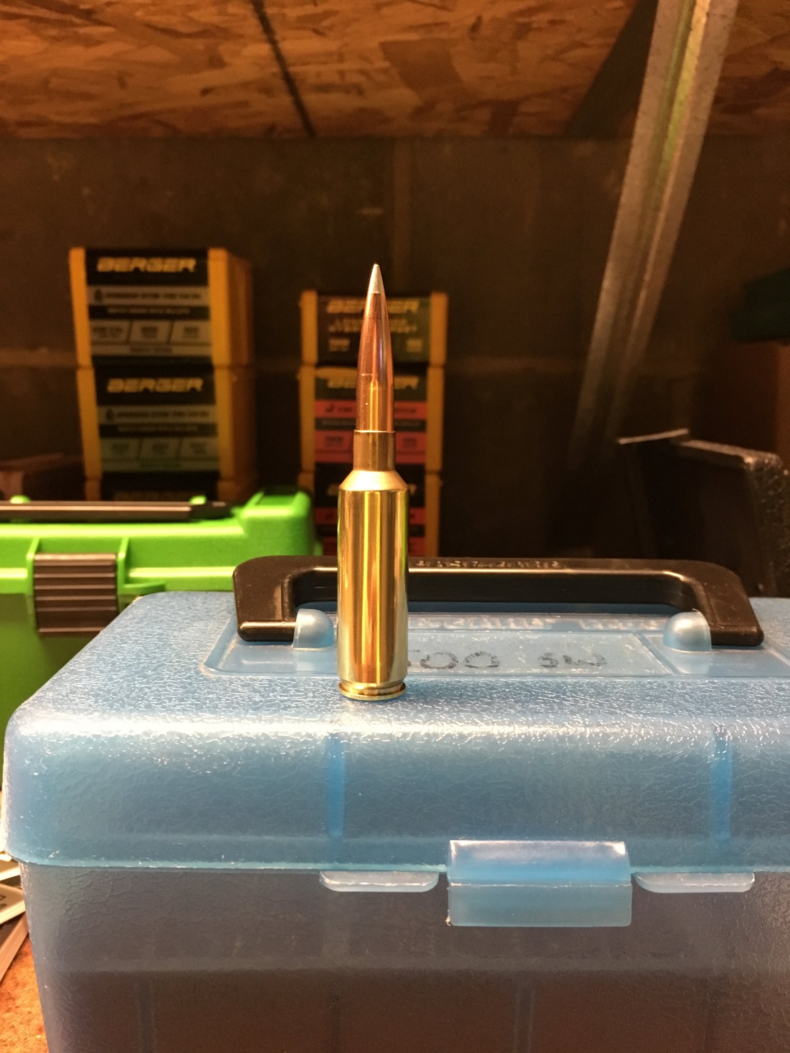

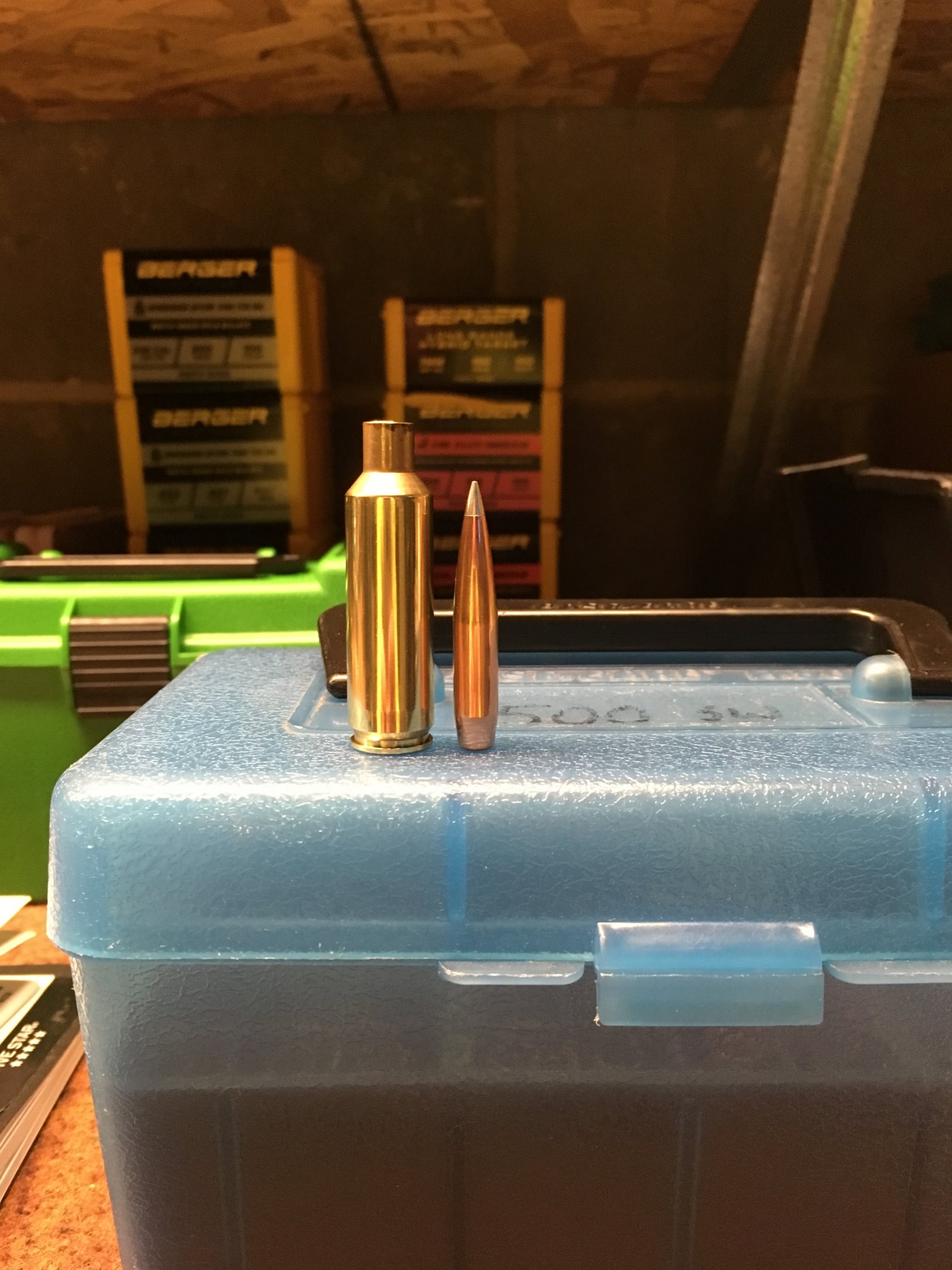

Glad to here someone tried what I thought would be a great round! Hopefully it’ll be my next chambering!

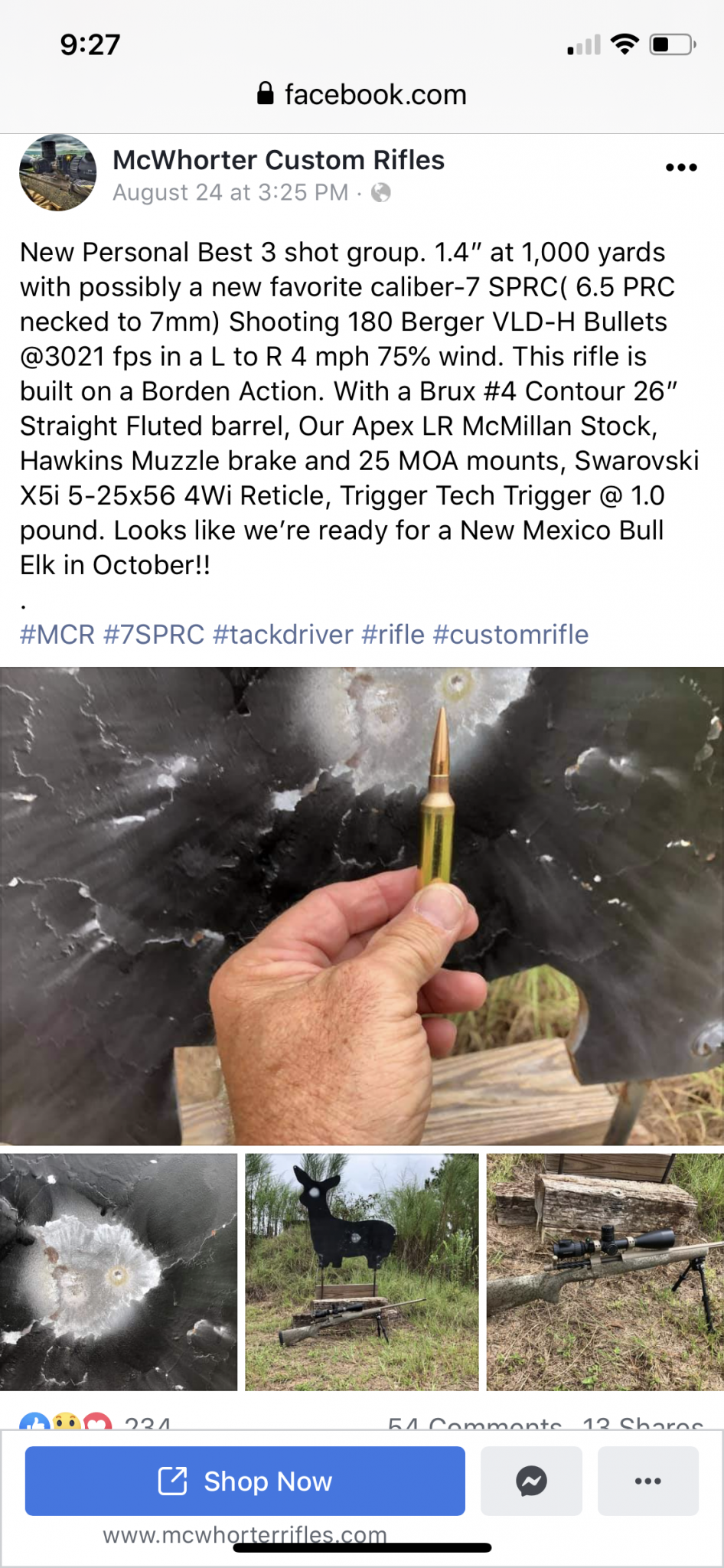

180g @ 3000 FPS in 6.5 PRC case? I could only get 2950FPS with 156 EOLs and it a pretty warm load.
That seems pretty fast given what I load my 7SS at.

58.6G H1000, 22" Proof, TBAC 7, 80 deg. Dunno fast barrel I guess. Didn't run into pressure signs till 59.4g.

Ya, it seems fast but who knows lol. I would buy a 7saum, actually that’s what I originally wanted but finding components for the saum was hard at the time and no factory ammo option when I ordered a 6.5prc. Now there’s all kinds saum components🤘🏻.
I had a 7 LRM at one time in a Desert Tech platform, did just what hereinaz said, bought all my components before hand and had enough to shoot out 3 barrels. The 7SS is one mean round! That will be my next build. 180g at 3000fps is some serious Elk medicine!

Is not a 1.4 inch group at 1,000 yards like bench rest winning groups for that distance. Like close to world record sized groups, if I'm not mistaken. Speed also is suspect for a case with the capacity of slightly larger the a .30-06.
Good Luck
Jerry
Good Luck
Jerry
1.068” is the current record, with a 6 BRA:
