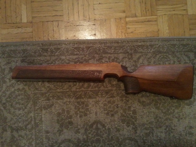

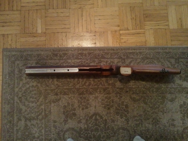

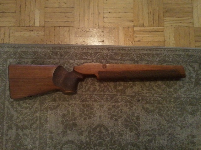

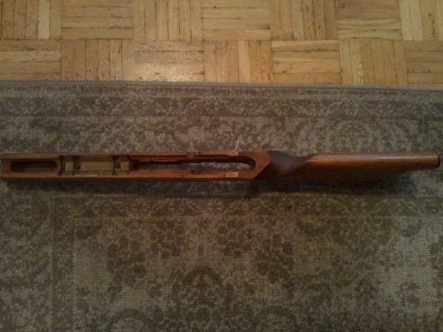

I got the stock in... a huge thank you goes out to Mike over at big gorilla for trying something new!!
Here are several angles of the stock.
I did a little bit of work on the stock, contouring the pistol grip to fit my hand... and added the texture that I'm sure you guys noticed. ;)

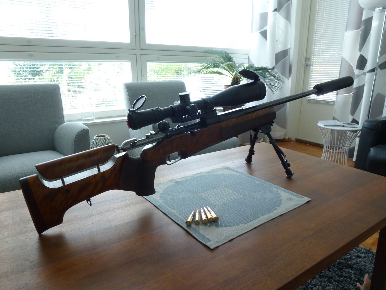

That piece is made by metal workshop, with high picatinnyrail and low burris xtremes, its bonded with tin to action.
Thanks for the info!! Where are you located?? I've never seen a stock like that one you have... and am I also correct in assuming that's a TKIV barrel block??

The M28/76 and M28/30 had .308 bores... One of the reasons I purchased this barrelled action was because of that fact. I have ALOT more options as far as bullets go. I've had great luck with IMR 4350 in this case, awesome accuracy and high velocities. I've honestly never tried another powder in this cartridge.
My location is Finland, so here is pretty easy to get parts for Mosin, especially those barrel blocks. Stock is also custom made by smith, from flaming birchwood, whole gun has came to cost a lot but i like the final result. :)
And sorry for my english, especially words and terms in guns are a bit unknown for me.. just registered here few days ago..

Hi there
I have noticed that quite a many of you guys are interested in the finnish made Valmet 7.62 Tkiv 85 sniper rifle (7.62 Tkiv 85 - Wikipedia, the free encyclopedia) and yes you can not buy that gun from anywhere but what you can do is build your own. So where I'm going with this is that I currently have one 7.62 Tkiv-85 stock in my hands that I could sell if someone would like to build their own Tkiv-85.
P.s I might be able to get more through my contacts.
Contact me if interested.
Hi there
[email protected]View attachment 32819View attachment 32820View attachment 32821View attachment 32822
Good looking stock there. Not sure if you know that is the competition stock for the Tkiv85 as opposed to the issued sniper stock.
I'm trained for that rifle and I served with it so I can share a secret with you guys, the cheek and butt adjusting inserts are just plywood pieces and the issued sniper stock is made out of the competition model by cutting the butt off and drilling holes to the butt for bolts so the inserts could be used and the same goes for the cheek rest.
That is very good information to know sacred-sheep. What are you looking to get out of those? Also, can you name a good source for match ammo with the 7.62x54R? All I ever run into is the "spam can" which isn't really too accurate.
p.s. What do you think of Martiini Knives?
