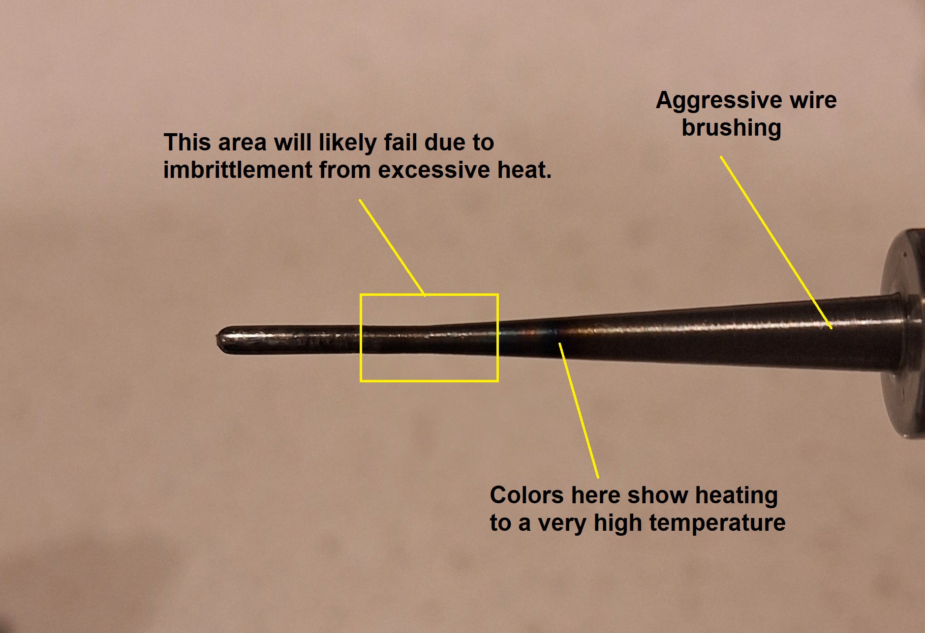

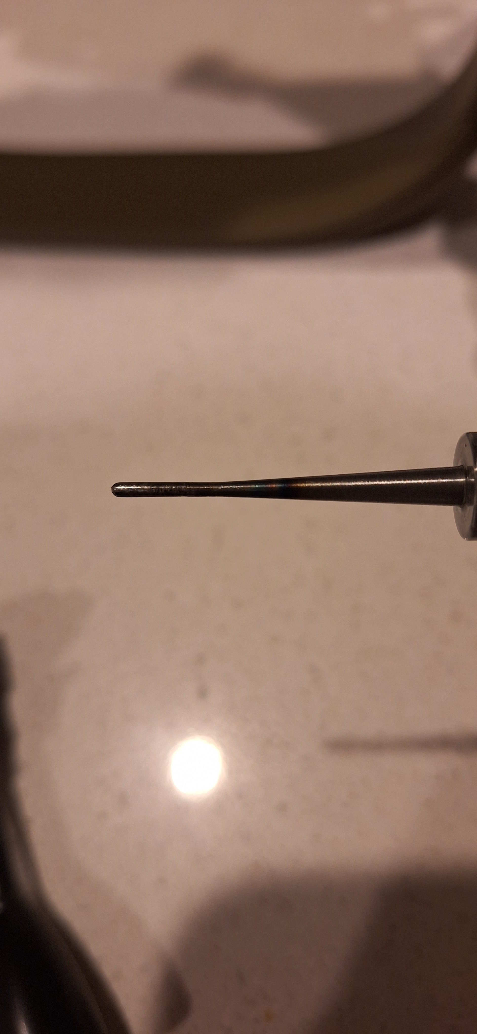

Hi guys, I'm looking for some opinions on this firing pin. Without going into too much detail I just want to know if you think that the obvious asymmetry (zoom in) is something that could cause issues with light strikes. I feel like it's dragging and binding on the bolt body. I'm getting way too many clicks and with 3 different primers.
Is it dragging or do you just feel like it is?
Honestly man, I can't tell. I just know that a brand new custom action shouldn't experience on average 20% light strikes between 3 shooting sessions and primers. I cant say ive tried 'everything' but it doesn't look right to my eyes.
Yeah, maybe some sharpie on the pin and cycle it a few times to see if the pin is rubbing. I’m not sure of the wobble in the pin really accounts for light strikes unless it is dragging. It’s odd though.
What brand/model of action is this firing pin out of?
It looks like shit.
Somebody molested the hell out of it at some point after manufacturing (. . . .unless Tactical Rifles.net started back up and is making actions now.)
The color variance makes me think it has been heated. Like really hot for some reason.
It was so hot that they actually experienced some of the material being ablated away from the torch blast (see inside yellow box above). Even more importantly, I would bet money that the composition of the remaining material in that area is altered. I would guess it is now brittle and prone to a stress crack/failure.
It also looks like it has been unevenly ground or aggressively wire brushed. I say unevenly because it appears to have some really distorted geometry to the point I would predict a failure somewhere down the road.
All that being said, the tip of the pin looks to be in good shape.
Even though the firing pin looks like it was made from scratch in some cave in Pakistan, that may not be the source of your ignition problem.
After looking at this altered part, I would question any of the other work to the point I would double check everything else about the barreled action.
It looks like shit.
This. I would check the headspace (maybe just a bit too much?) and replace that firing pin and the spring.
Hi guys, I'm looking for some opinions on this firing pin. Without going into too much detail I just want to know if you think that the obvious asymmetry (zoom in) is something that could cause issues with light strikes. I feel like it's dragging and binding on the bolt body. I'm getting way too many clicks and with 3 different primers. View attachment 8654690

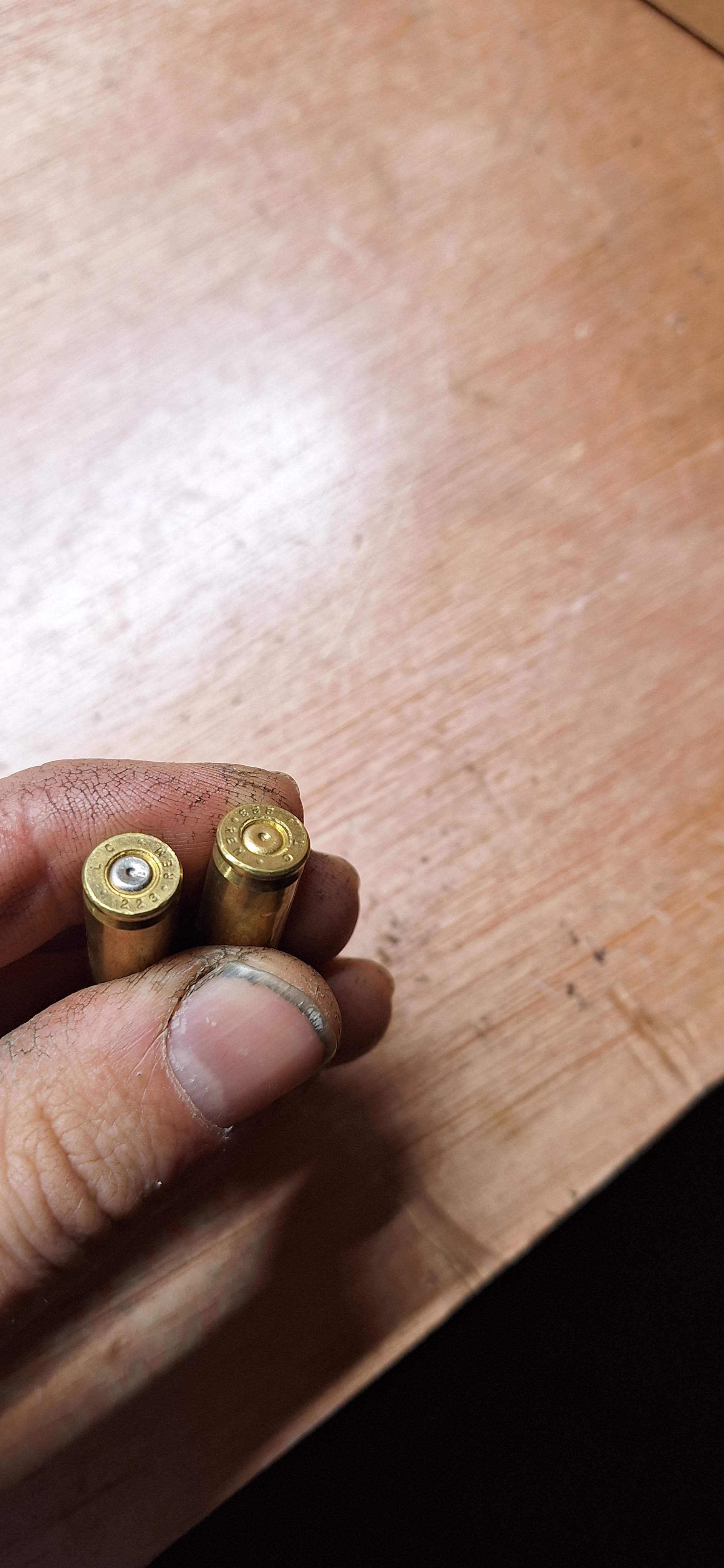

How many primers have you popped?
There's heat marks and the tip looks less than round.
Standard chambering or improved variant of some sort ?
I ask because I made a bone head mistake one time with the first rifle I set headspace on. In my case it was my 243AI. I had been led to believe you used a standard go guage to headspace an ackley which I found out later was only sort of true.
Anyway, I headspaced it tight on the go guage and with factory ammo I had a good slight crush when closing the bolt. Fired a whole box of factory ammo just fine. The problem came when I resized some more once fired (in a straight 243win) brass for further fire forming. I sized down too much and I had excessive headspace leading to light firing pin strikes just like the OP.
Headspace verified good to go ?
Measured fired cases against the ones that didn't go boom ? Based on my own experience that's where I'd look.
By popped, do you mean pierced/blown?
If it is a new action with only 3 range trips and barely getting ignition, I'm betting he comes back with a "zero" answer .
Yep.
I'm thinking the answer is the same, yet that's what it sort of looks like.
