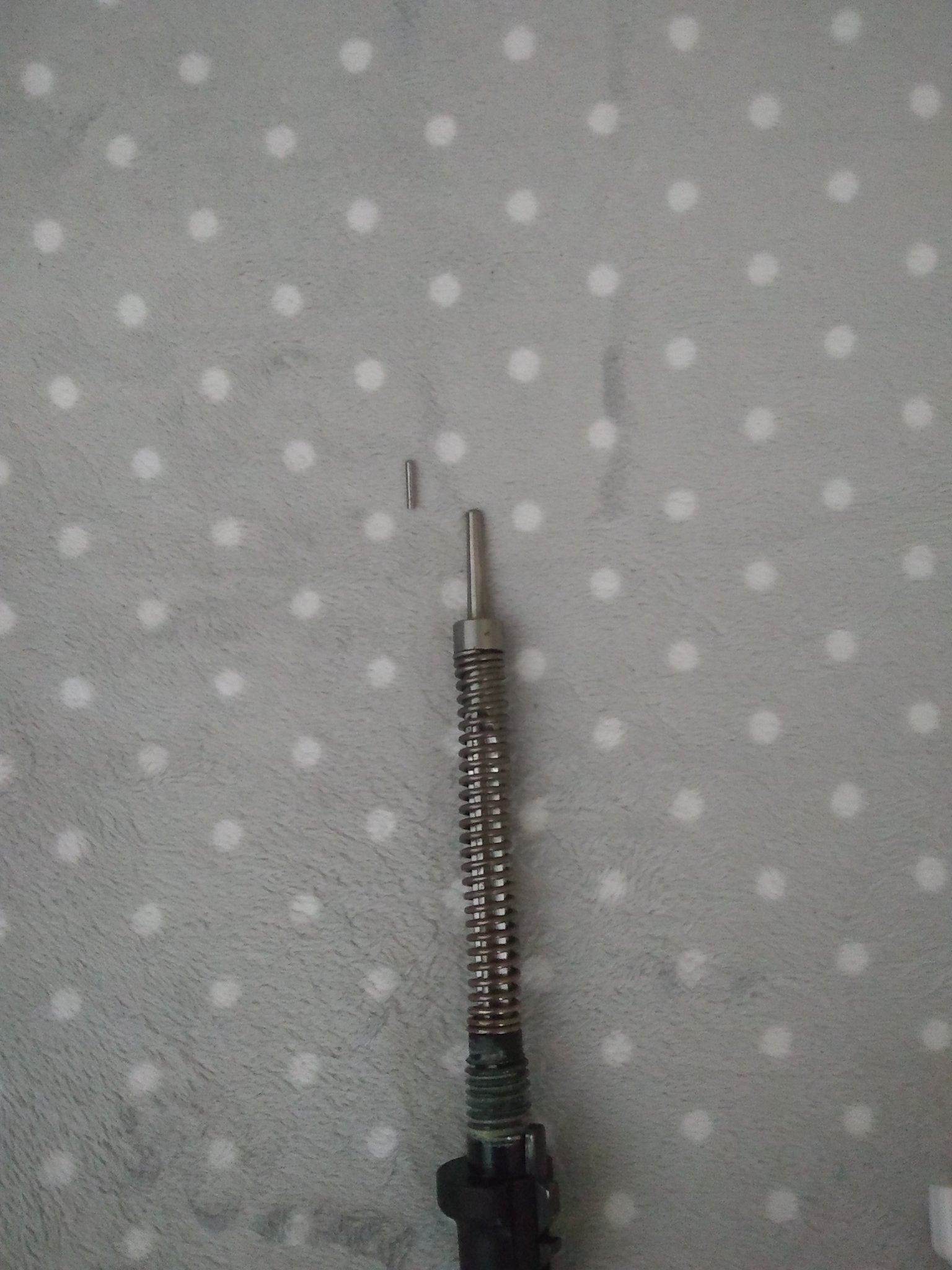

It would be interesting to see some photos of the failed firing pins to try and determine why they failed, what part of the firing pin failed.
The thinnest part of the tip breaks off, usually right where it meets the thicker firing pin body. You don’t usually notice it until you get to the range and your first round goes “click”. That’s why I carry a spare firing pin and shroud assembly.
Here's a pic of mine. The piece went into lug recess and I couldn't close the bolt. Otherwise I wouldn't have known.
