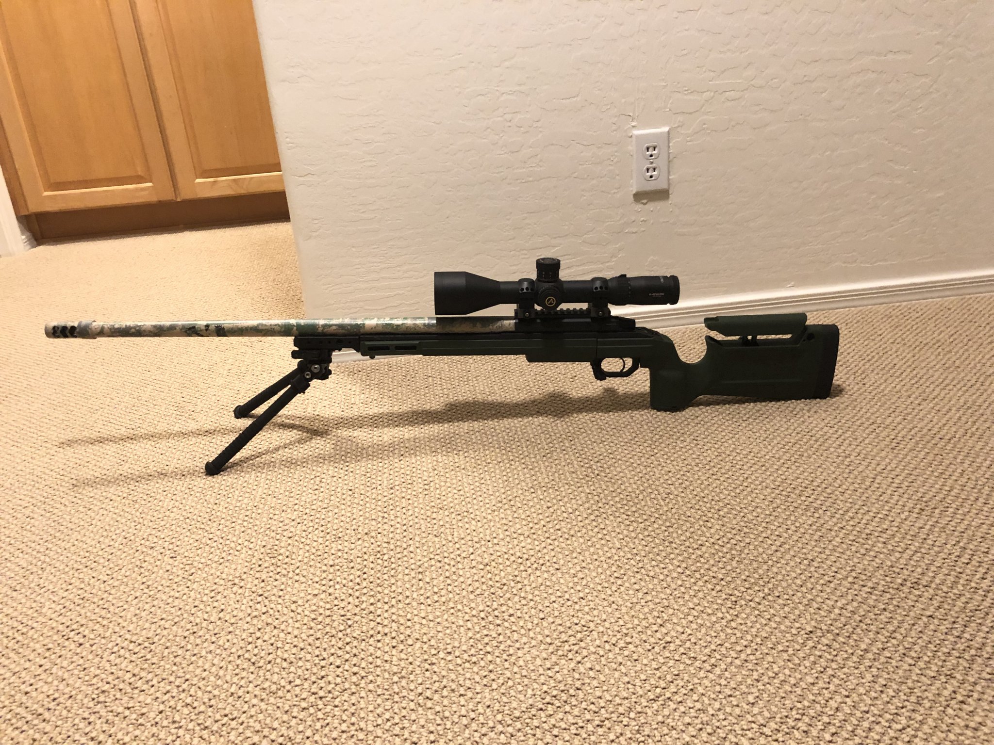

4-here’s my nice rifle.

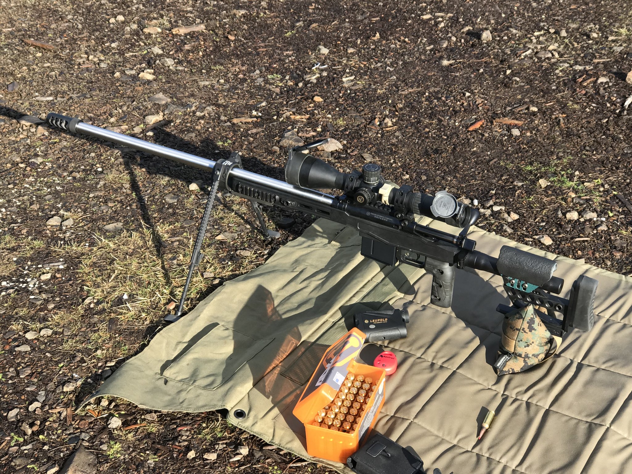

I looked at Defiance, Impact, Bighorn and for a short action.......Impact won. Off the shelf pre-fits, runs dirty and damn smooth. Honestly think that I would be happy with the other two as well but I couldn’t afford 3? The boys at ALTUS put it all together for me but I look forward to taking care of future barrels myself.
6.5CM
Impact Action
Trigger Tech special
Bartlein 8.25-7.5 gain twist M24
Hellfire brake
KRG Bravo w/spigot
Atlas QD
Look like adg brass is that your saum
