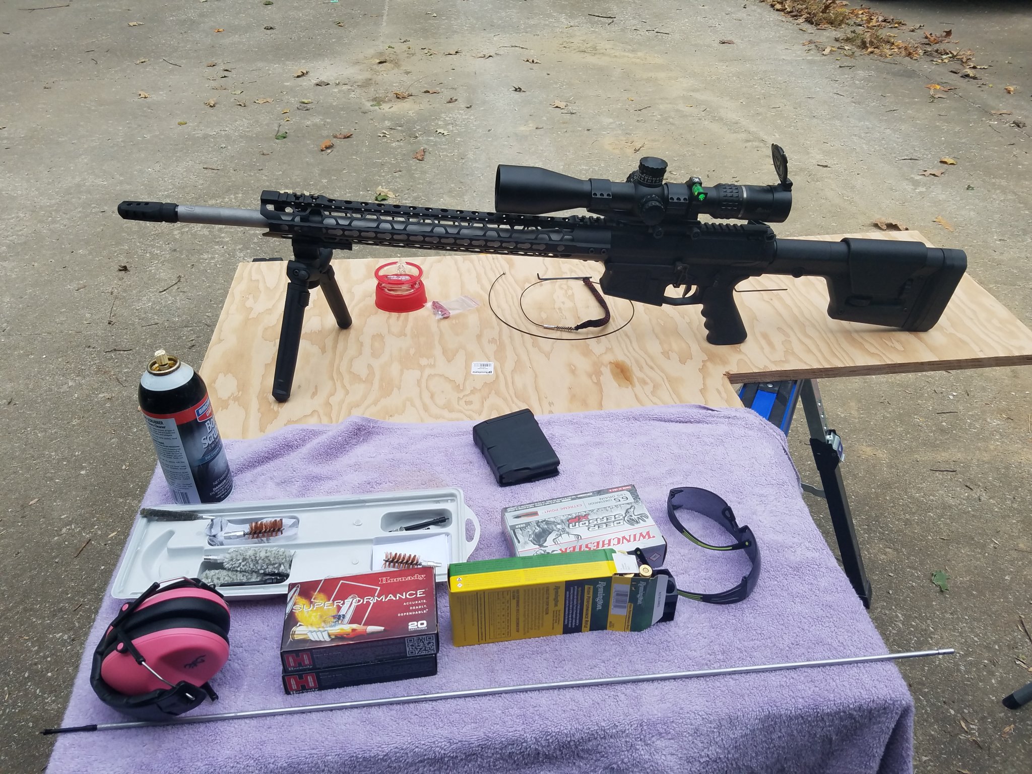

This was my first attempt at a long range AR build, Areo upper/lower, Craddock 22” barrel with head spaced bolt, Geissele SD-3G trigger, Magpul gen3 PRS and Bipod, Odin works Adjustable gas block and Handguard, Scope is Burris 4-20x50 XTR 2. Started breaking in the barrel took 1 shot than clean 5x followed by 5 shots and clean 5x. My first ever 5 shot group turned out the best I switched to 3 shot groups and always screwed up 1 shot. Basically got the gas block tuned, scope zeroed, and barrel broke in. I need to get a sand bag setup for under the stock, I felt like I was chasing keeping steady followed by focusing on the target with brief moments where both were good and I could fire. I will post some pictures from today off my cell phone.
