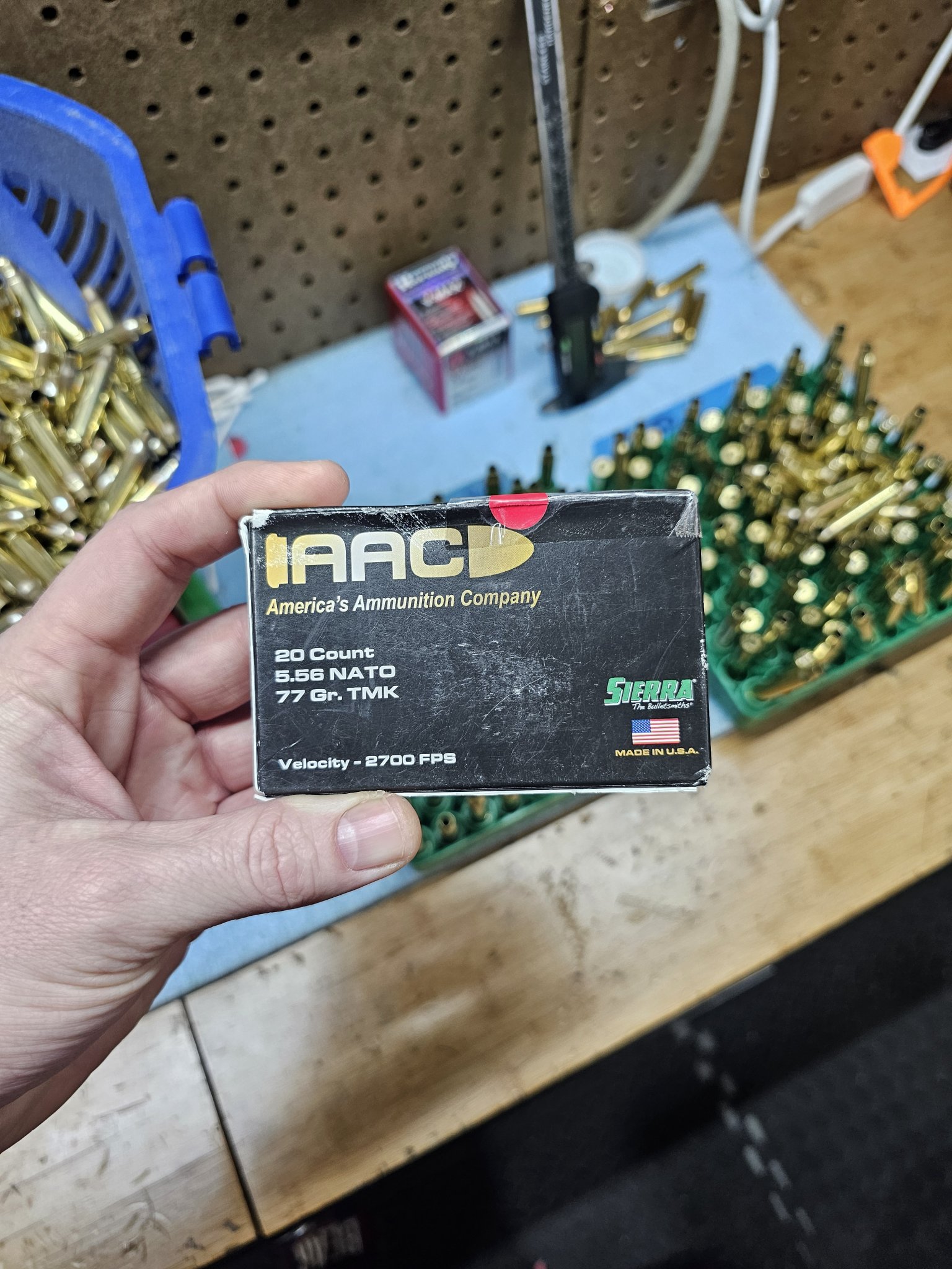

Any aac 77s on hand ? Think G had that group as part of their promo.
It was the AAC 77gr TMKs, but I'll shoot if again just for you😉
I put the 1/2" red dots I shoot at 100rds on the boxes of ammo that don't work out, it also hated the 69gr AAC SMK's

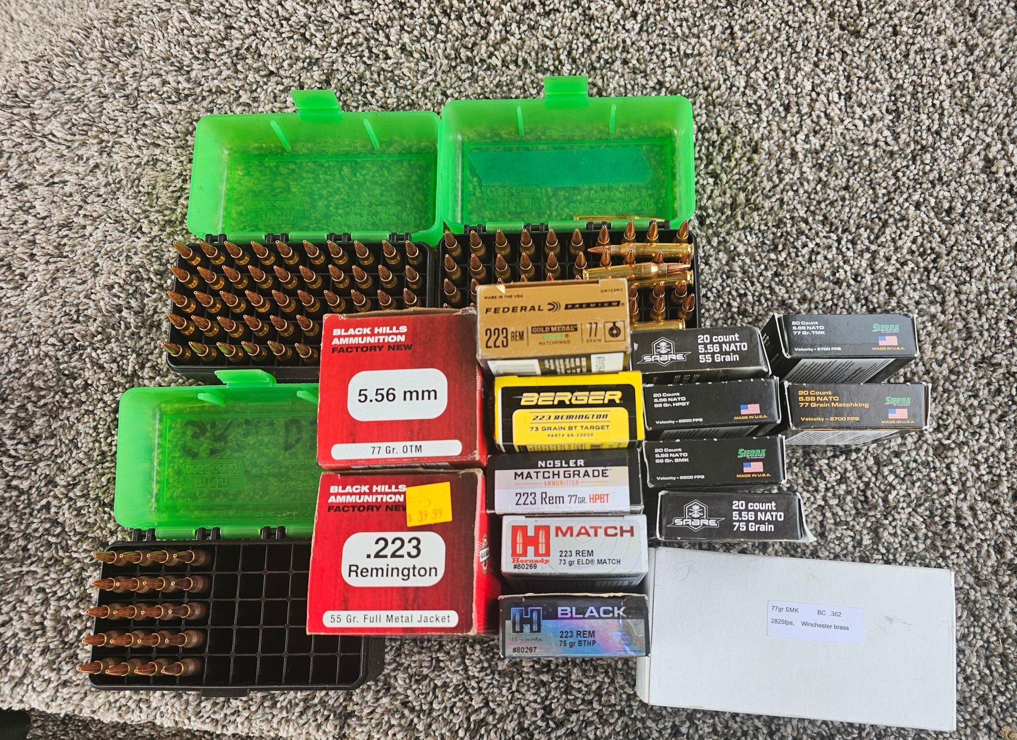

When I take the 18" SPR out for load development I'll shoot every type of factory 5.56/.223 ammo I have on hand so y'all can see what she like and hates.
Keep in mind the AAC stuff isn't what I'd call consistent.

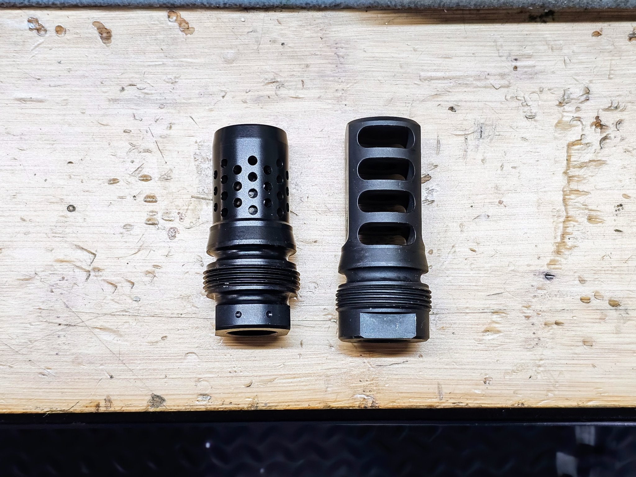

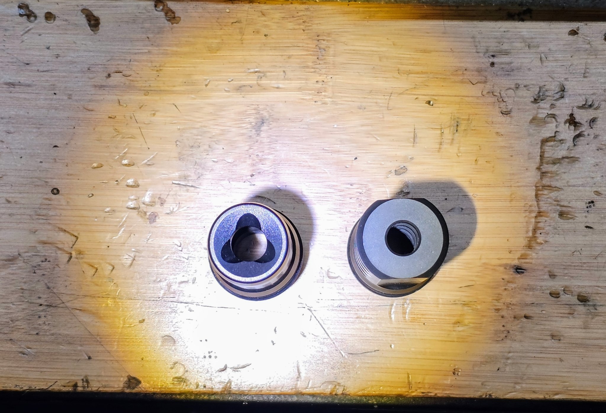

@Bigjake83 how do you like the Xeno muzzle brake? I have one now that came with my Nomad, I made it direct thread, but thinking of moving it to my B&T to use on my semis for easier can swapping. See any downsides with the brake/can interface?
No Sir, no down side at all.
I started off with the Keymo Hub and Dead Air Muzzle break Set up and initially I really enjoyed it although it did add on a good amount of weight.
As time went on I started noticing that the CAN would come loose off of that last click creating just enough play to throw off the barrel harmonics and effect my accuracy.
I’ve swapped all my muzzle devices to Xeno now, the two Muzzle Devices that I run are extremely effective at what they do.
The Xeno utilizes left hand threads, I haven’t had one come loose yet on any of my Cans.
The Dead Air Muzzle Brake is a hybrid style muzzle brake that also does a great job at reducing Muzzle Flash, all of the Xeno muzzle devices are compact and lightweight.
I was initially a little skeptical because they all run a .30 caliber bore so I wasn't confident they would be effective at reducing felt recoil but they do a great job at it.
When you switch over from Keymo to Xeno you get to ditch that Ratchet Style Hub adapter that adds a significant amount of weight, the Hub Adapter for the Xeno is the same weight as a standard direct thread hub.
Dead Air Muzzle Brake: LEFT
LMT 4 Port Muzzle Brake: (NOT LEWIS & TOOL ) RIGHT
I use the Dead Air Xeno on all my SBR's in 5.56 and 6 ARC with 10.5" to 14.5" barrels.
The LMT 4 Port Muzzle Brake is extremely effective at reducing recoil, it lives on all my Large frame Rifles and a few Small Frames with 20" or longer barrels. You'll want the LMT 4 Port Muzzle Brake away from your ears 🤯
Hope this helps.
Jake.

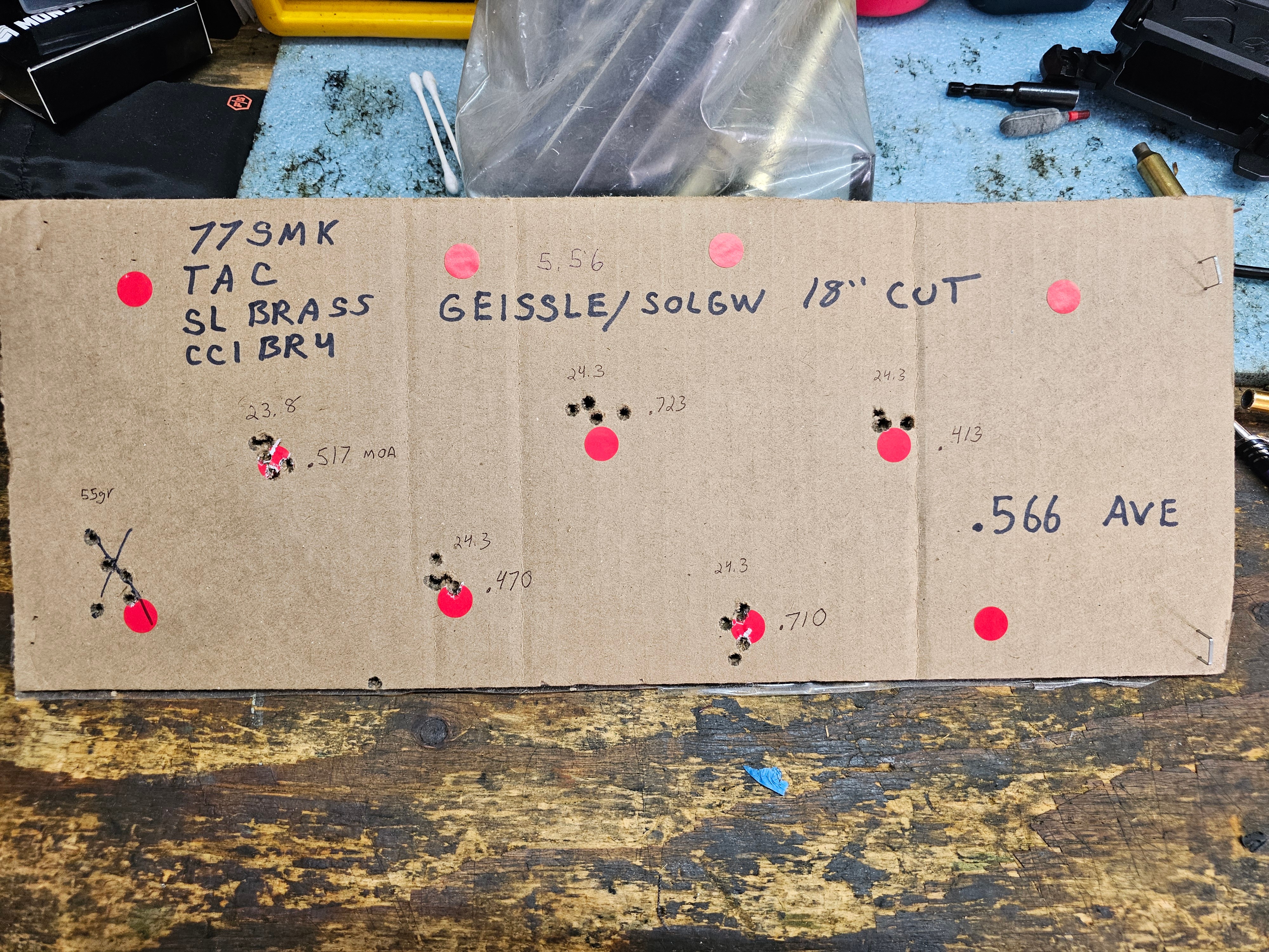

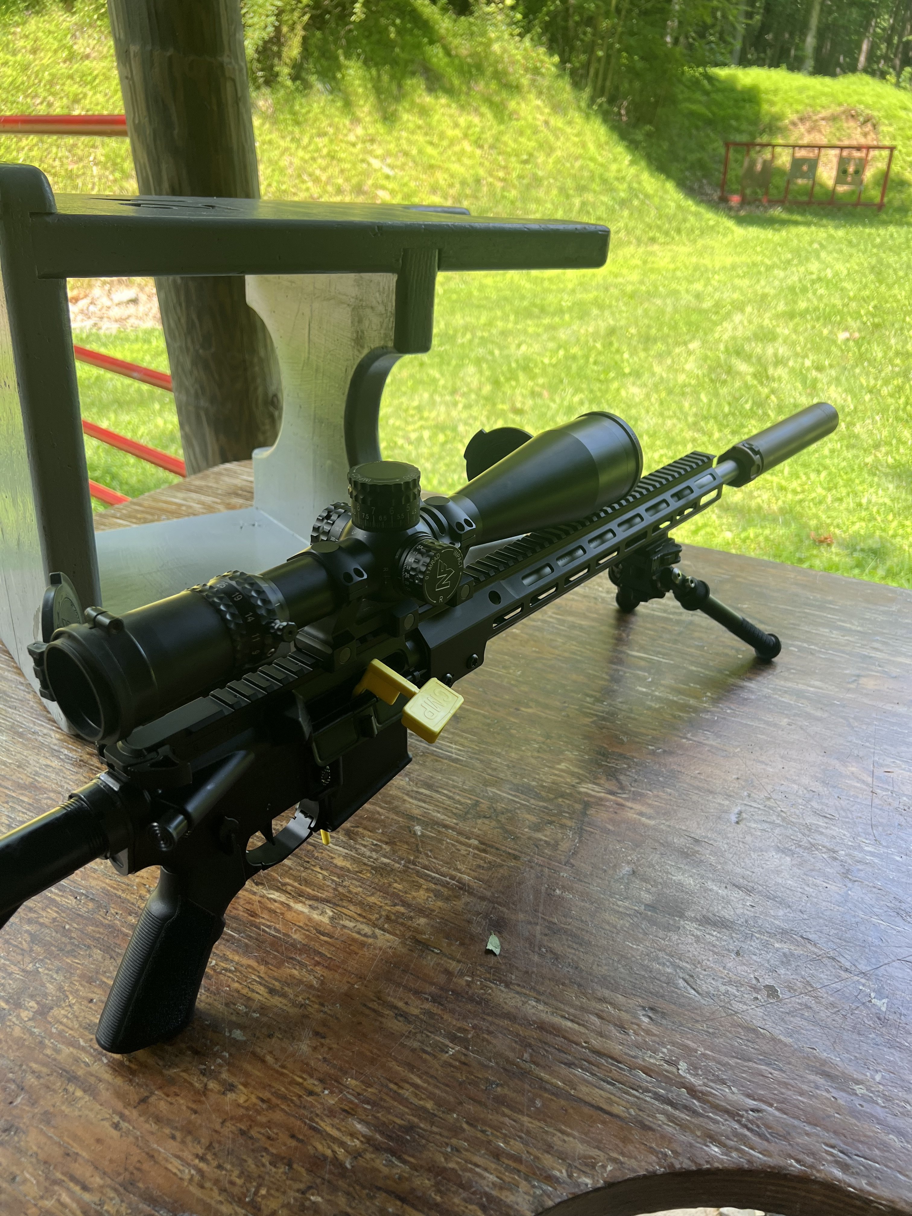

Part 4: Load Development and Factory Ammo Testing

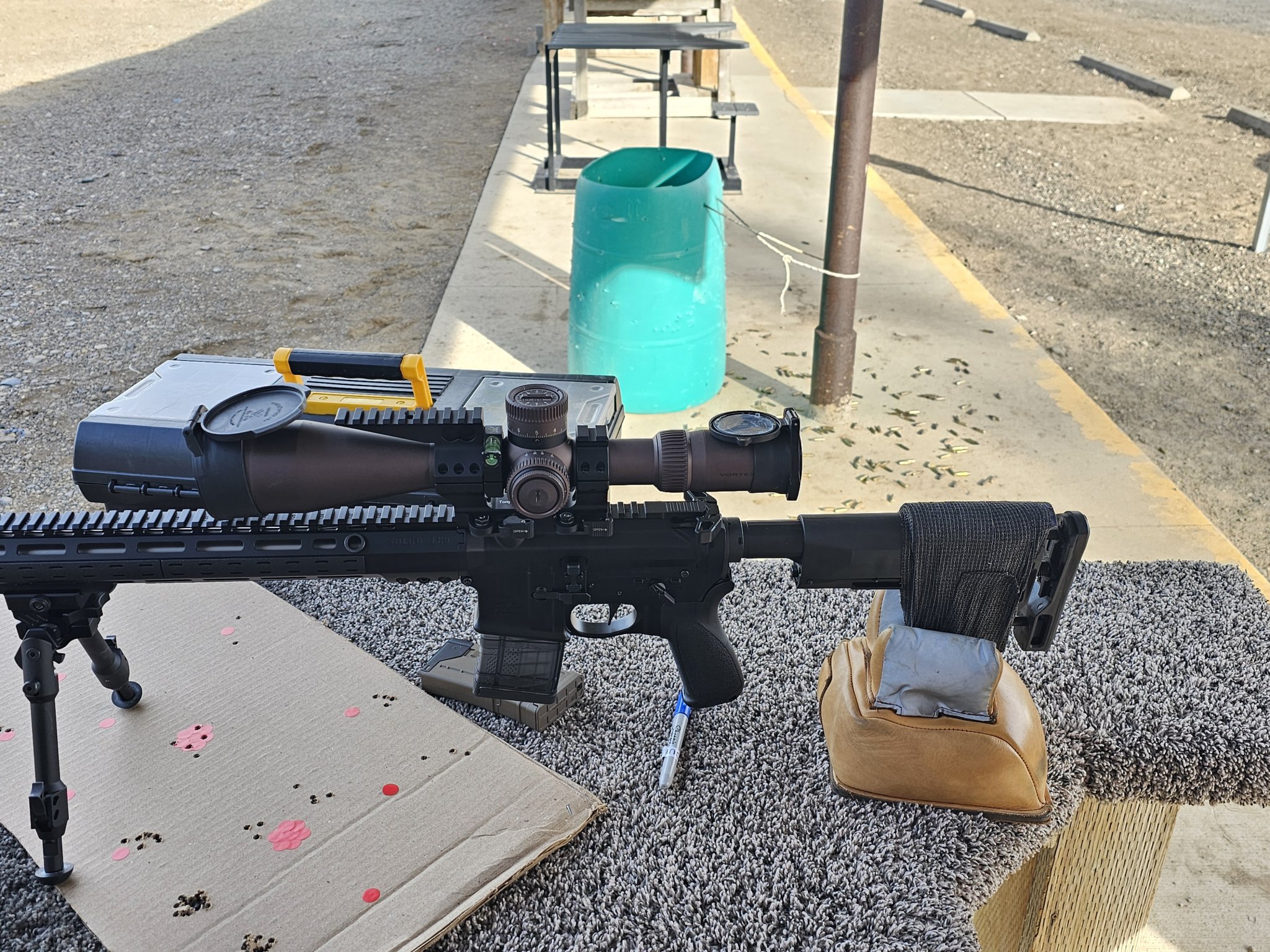

I've got my first round of Handloads to shoot today along with a good assortment of factory ammo.
HANDLOAD COMPONENTS:
77gr SMK
RAMSHOT TAC
STARLINE BRASS
CCI BR4 PRIMERS
Good Ejection pattern.

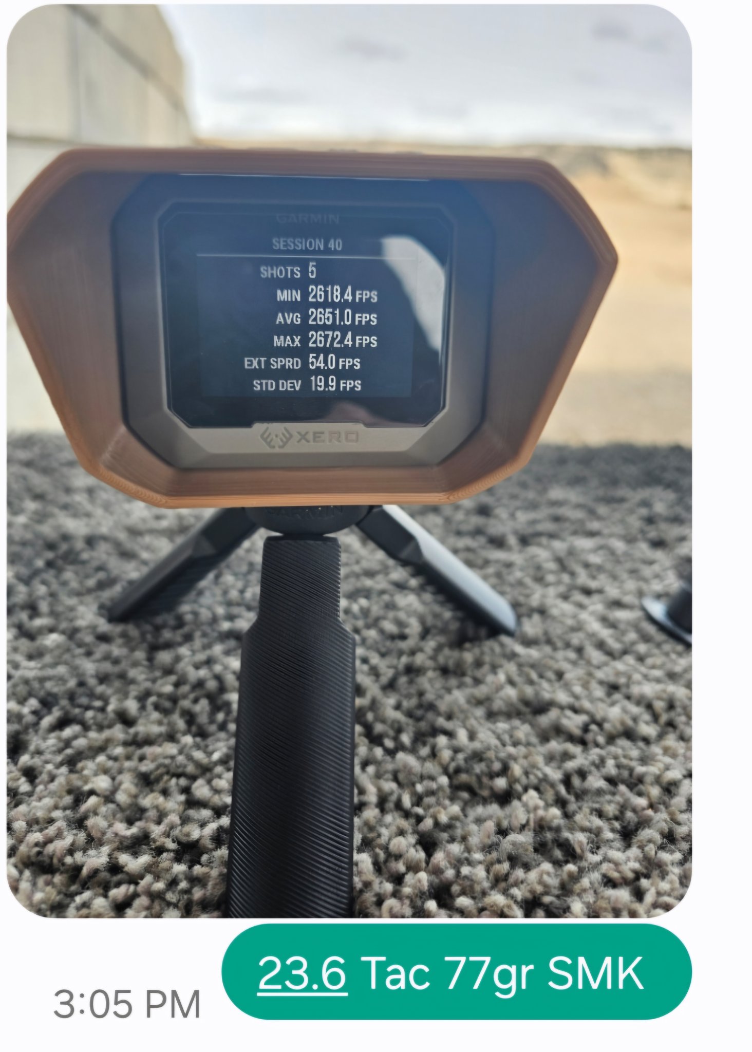

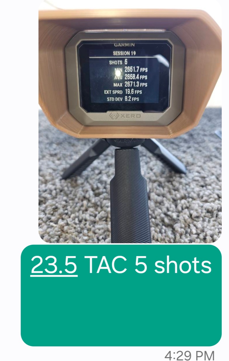

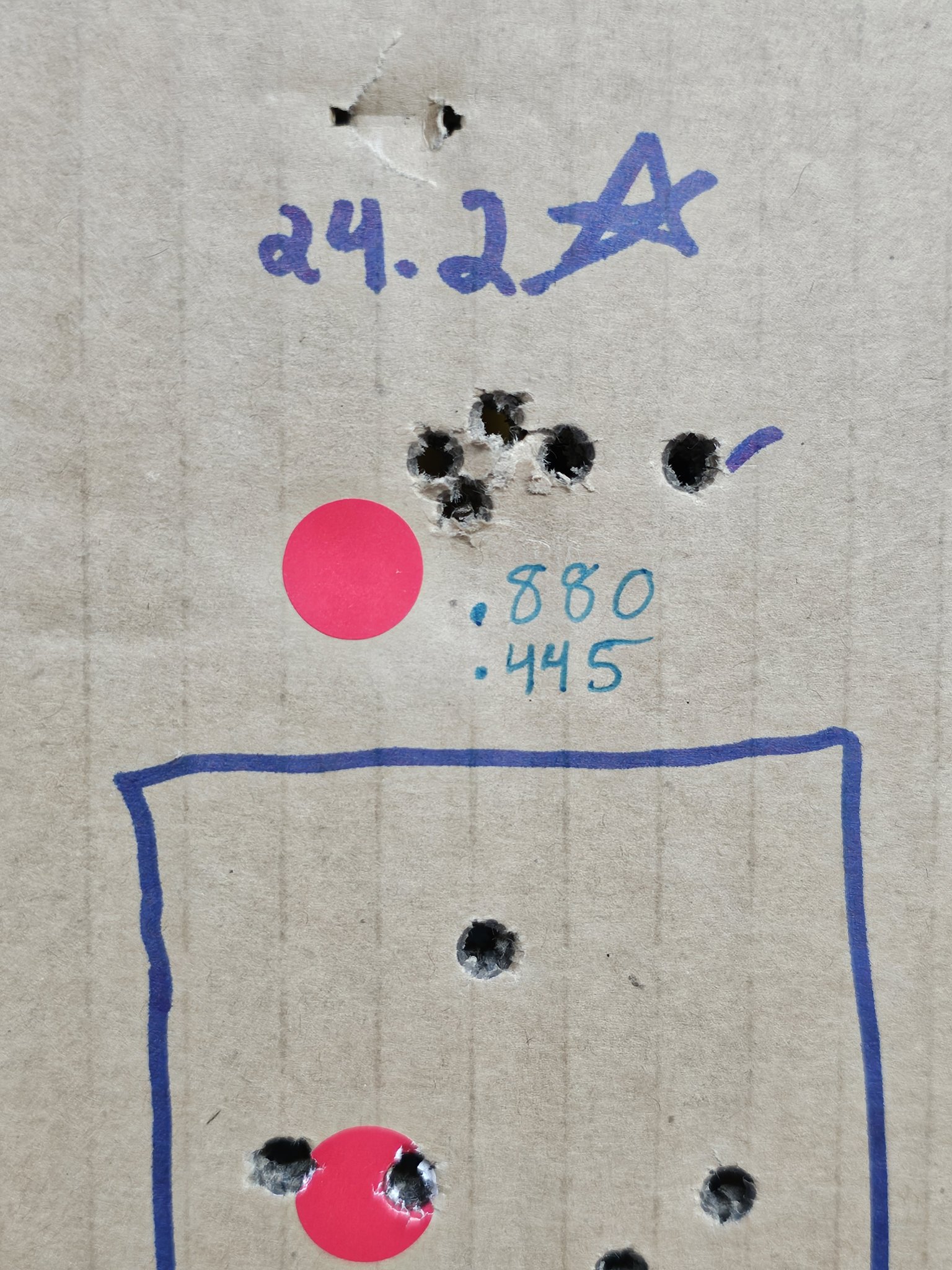

23.6gr TAC

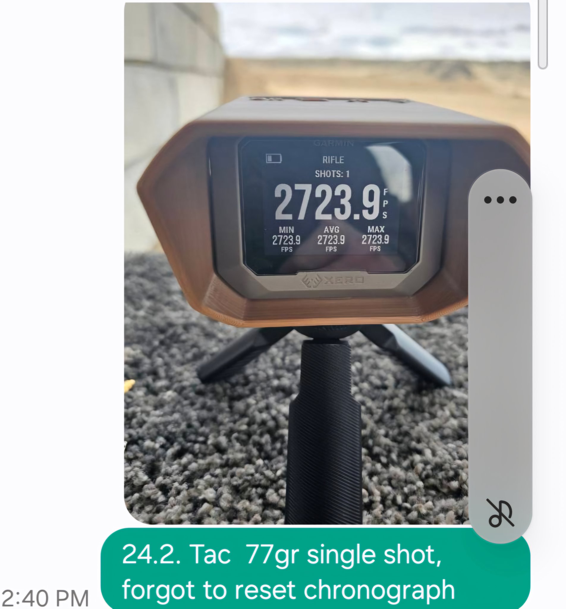

24.2 TAC
Didn't realize I forgot to reset the chronograph until I was on shot #5🤬🤬🤬

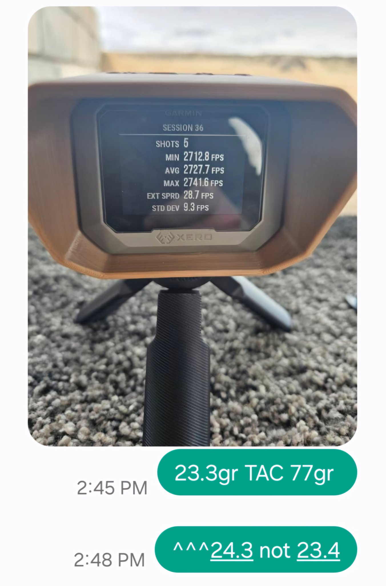

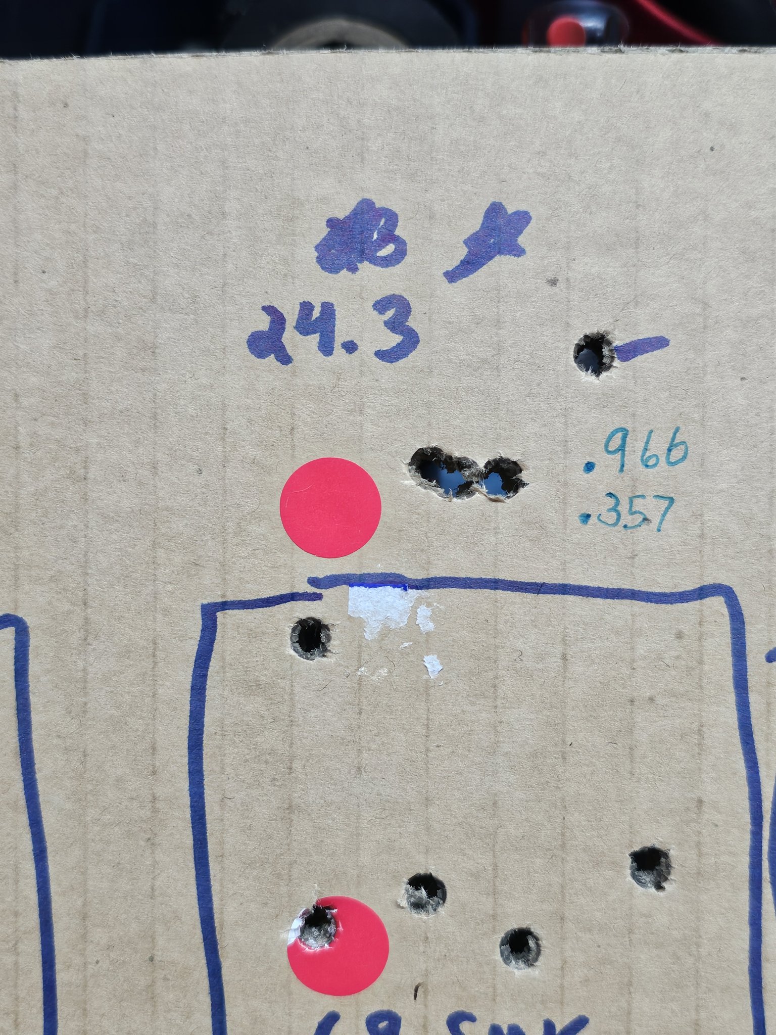

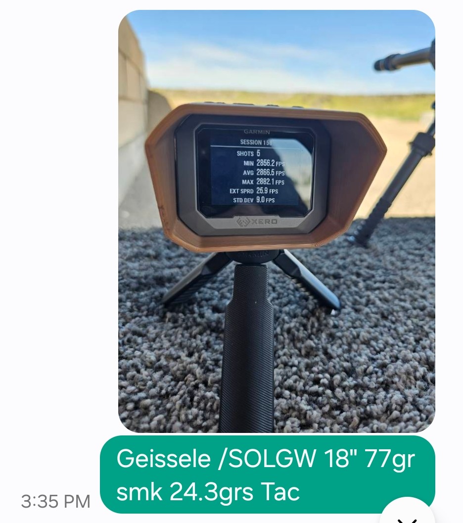

24.3 TAC

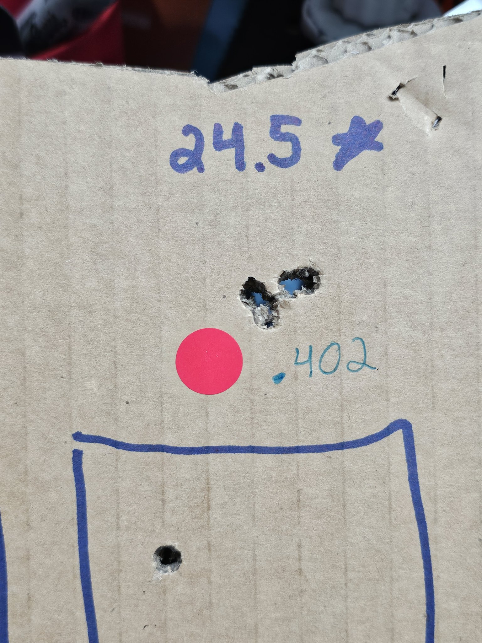

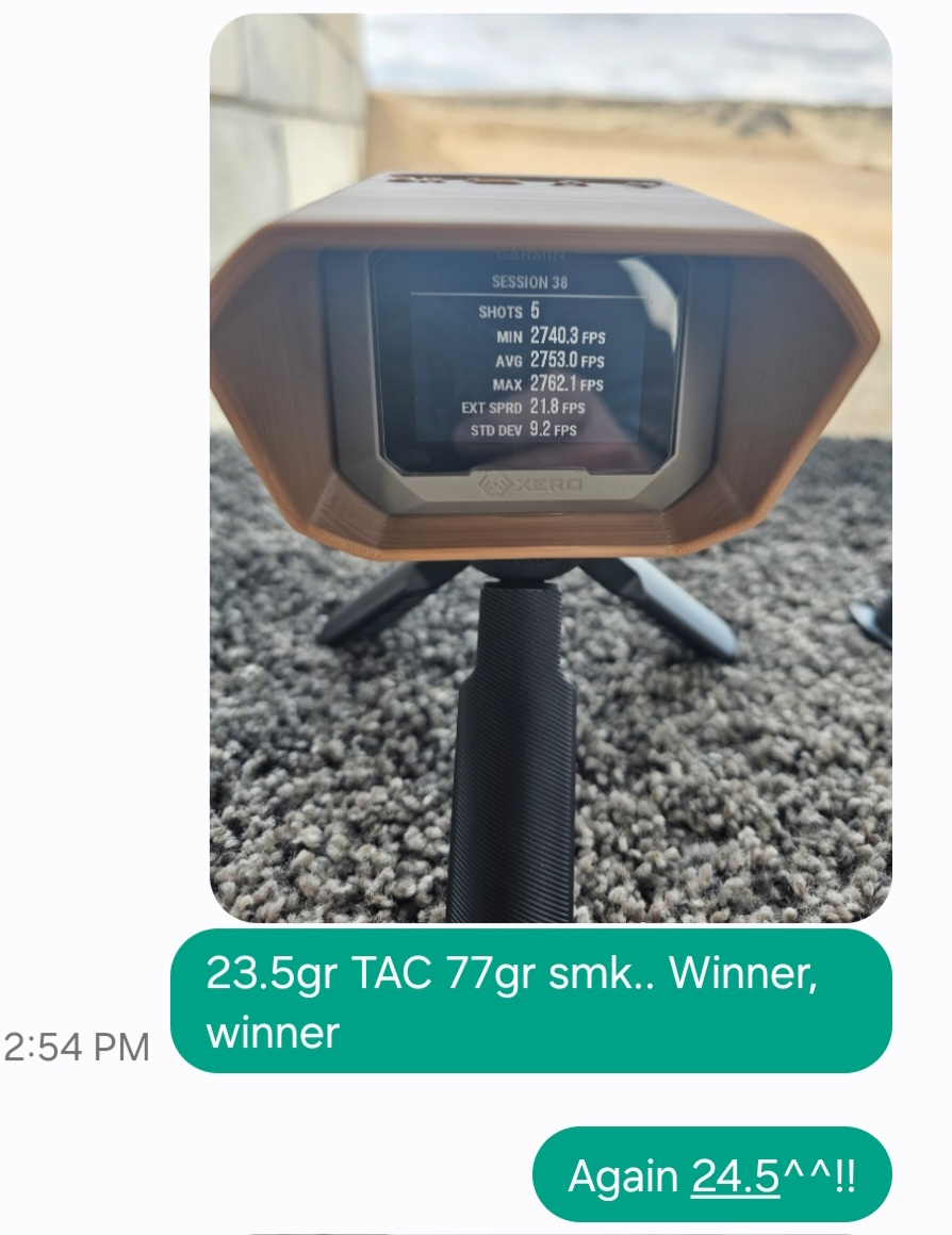

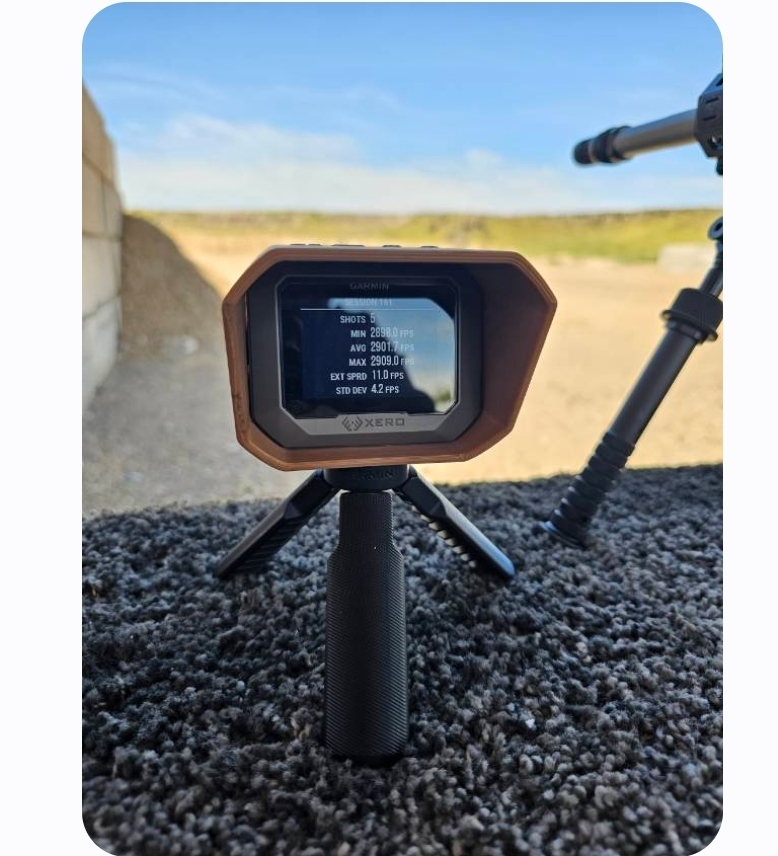

24.5gr TAC

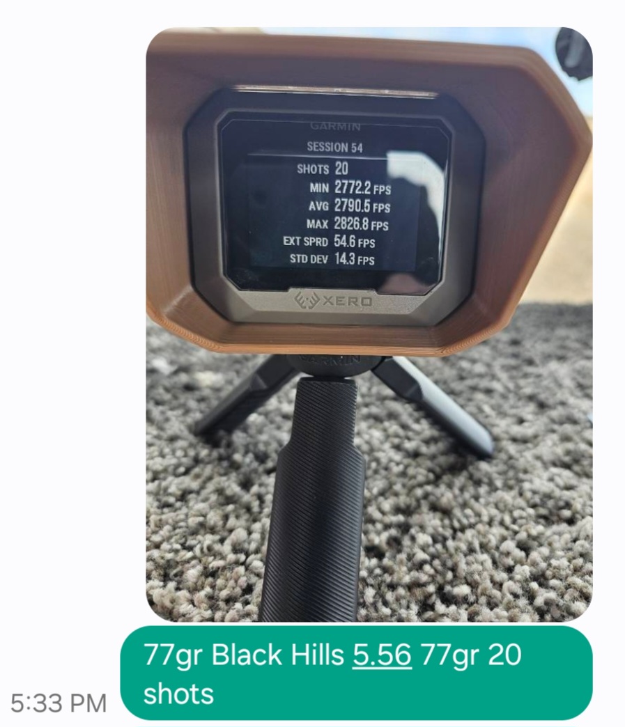

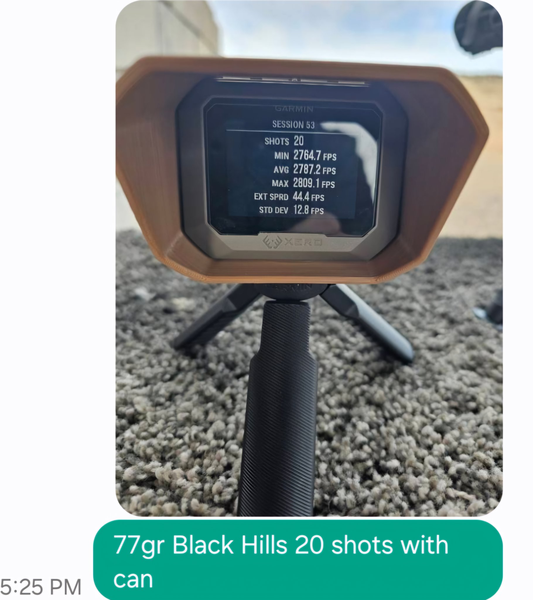

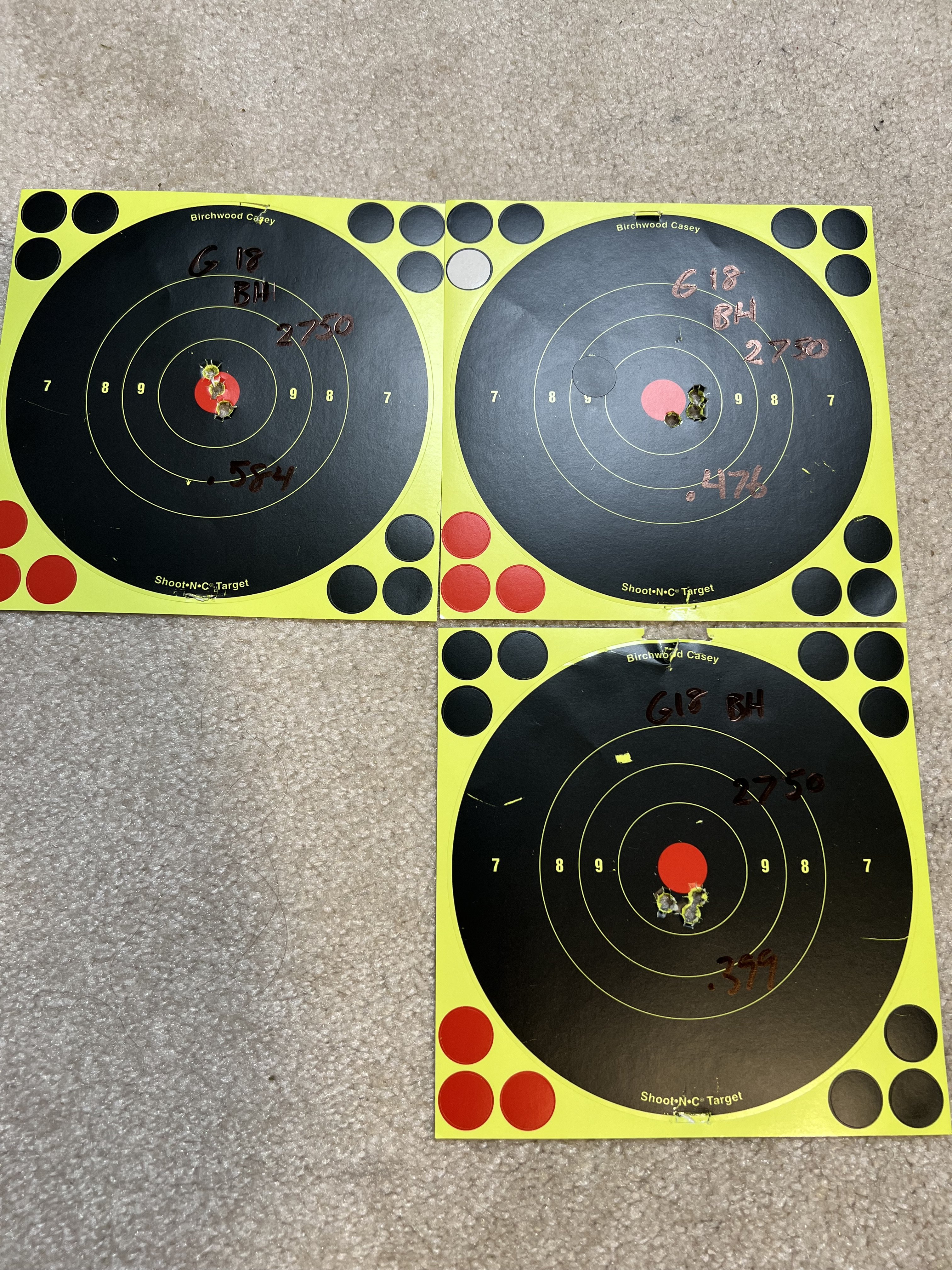

Not sure who asked but here are two 20-round groups of Black Hills 5.56 77gr
I'll repeat the following loads for next Range Trip with 20rds of each.
I had a few flyers, shit happens. Should make @dms416 happy😁 knowing that I'm a mere mortal.
All groups were shot unsuppressed besides the last two 20rd Groups at the end.

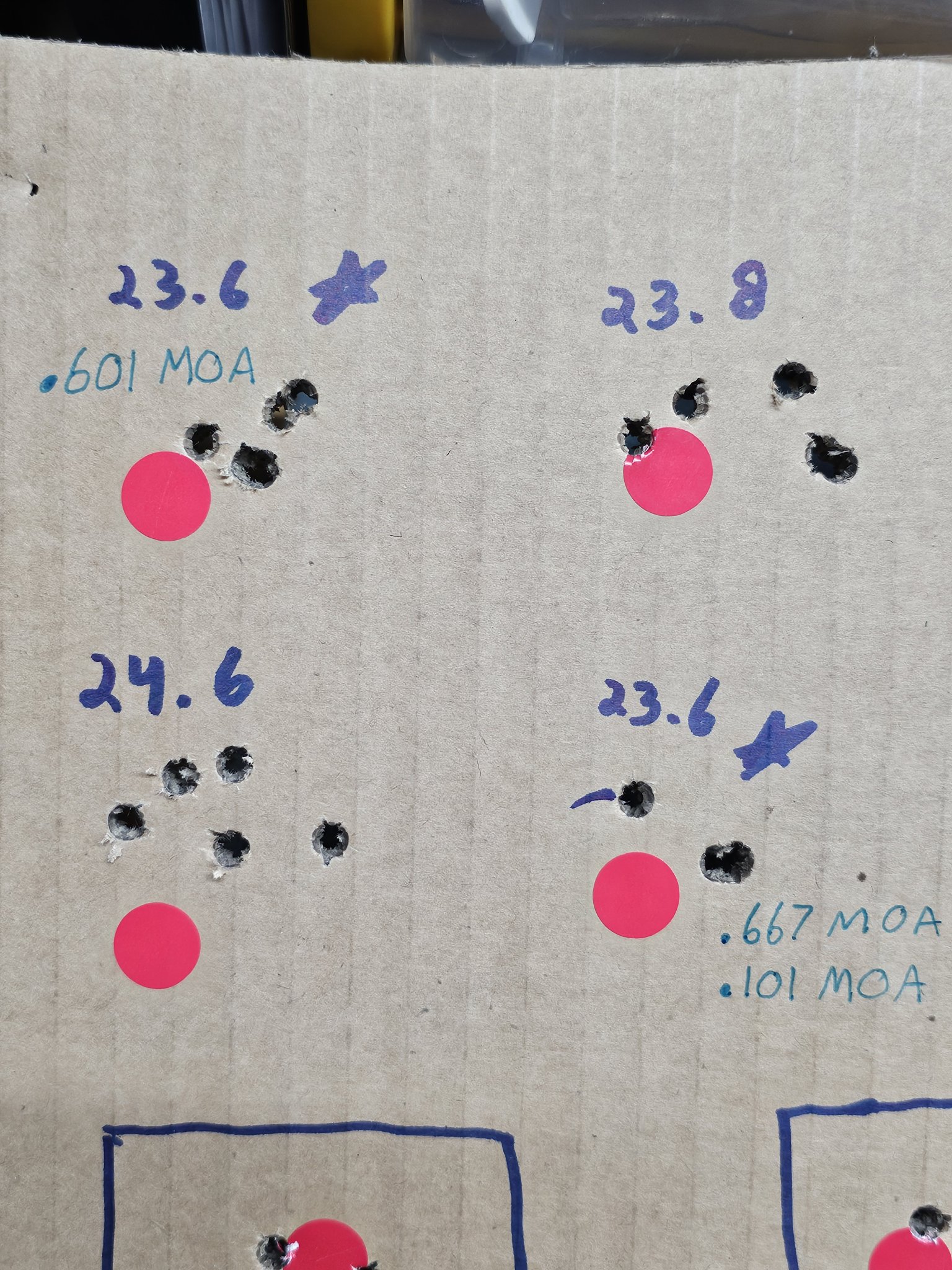

23.6
24.2
24.3
24.5** 2753fps SD 9.2 / ES 21.8
And yes it still hates the AAC 77gr TMK's!
The 24.5gr of TAC really hit the sweet spot for Accuracy and Muzzle Velocity, matching the Black Hills 5.56 77gr.

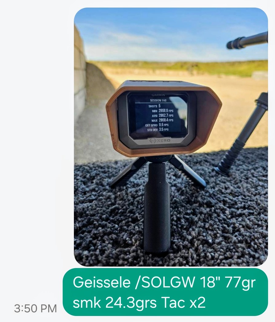

Here is the data for the 24.5grs of TAC, just broke the 2900fps barrier but starting getting ejector swipes.
Those are definitely impressive numbers, if you look in the other thread I just Updated with a 22 ARC Build (The Green Goblin) the 20" 22 ARC barrel is pushing the 75gr ELD's around 2950fps.
The Geissele 18" SPR Cut Barrel is definitely among the fastest .224 Cal Barrels I own. Looking forward to the results of the 73gr Bergers and ELD's.

And those 20rd groups of BHA 77gr are a thing of beauty.

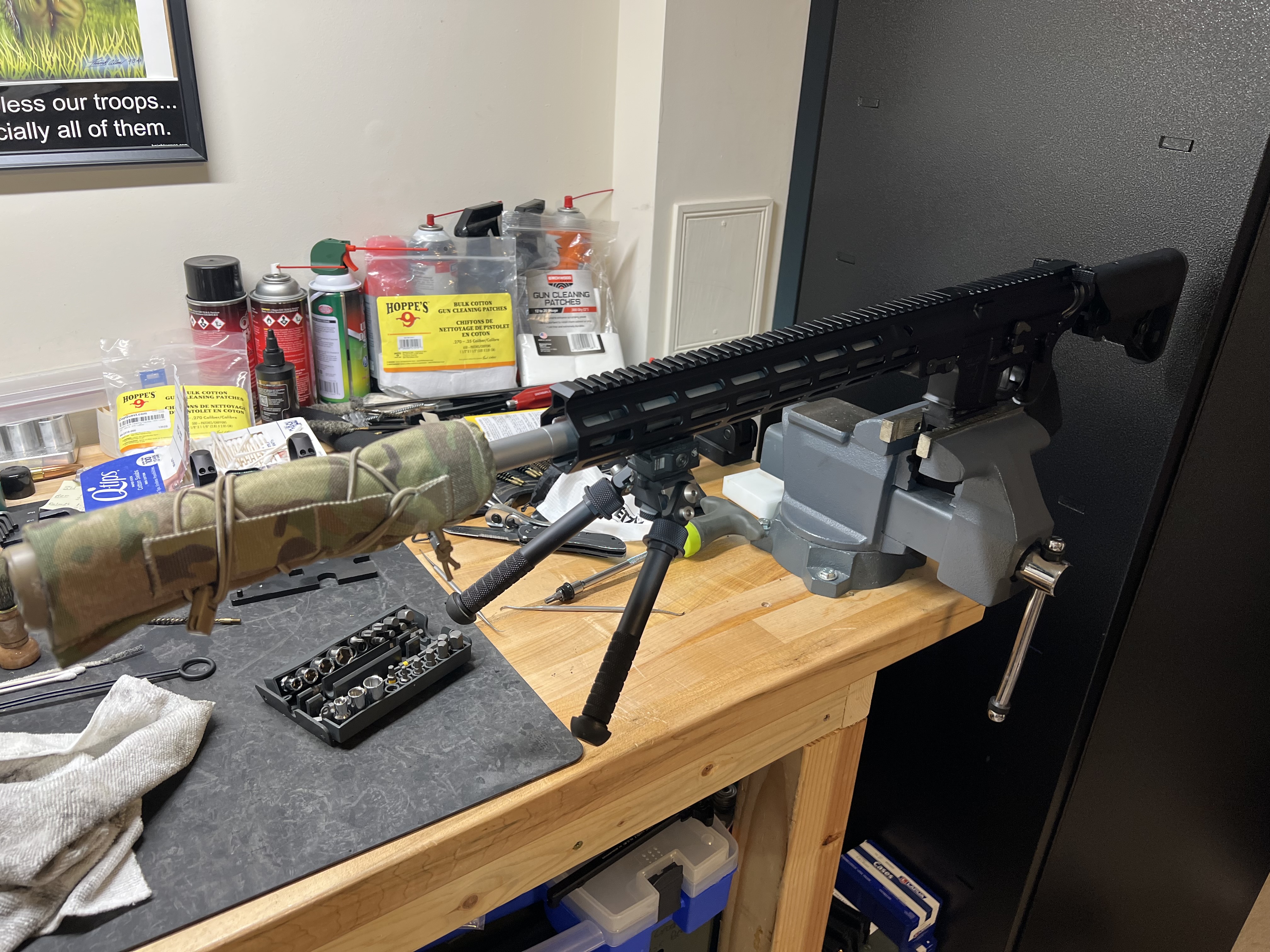

Here are my initial groups with the barrel. I am pleased thus far with the results. I used Black Hills mil pack 77gr - measured ave 2750
The felt recoil is lighter than other similar rifles and ejects at 3-4 o'clock. Some gas leakage using the Geissele gas block...but not too bad. You can't pin the gas black as designed since the "bomb" proof pin is not drilled on the barrel.
