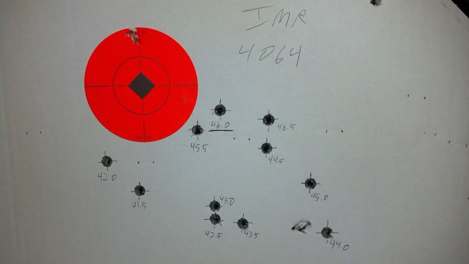

All ladders were run at 300y firing one shot per charge while recording the velocities with a crono about 10' downrange. All shots were fired ~2min apart checking for pressure signs along the way.
This is IMR 4064, the wind was gusting to 13mph. I am thinking 46.0 which gave me 2807fps .

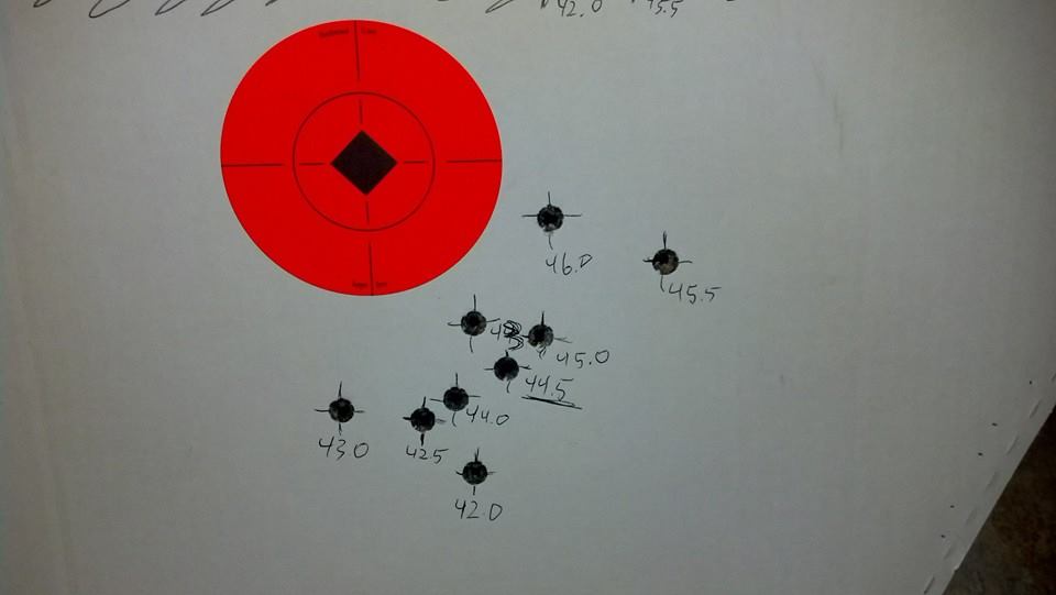

For R-15 I am thinking 44.5 which was 2721.

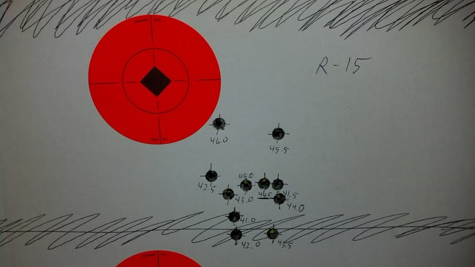

For Varget, 44.5 which was 2704.
With all this I am thinking 46.0 of IMR 4064 will be the one to go with because I am getting the best velocity (2807) within an accuracy node.
