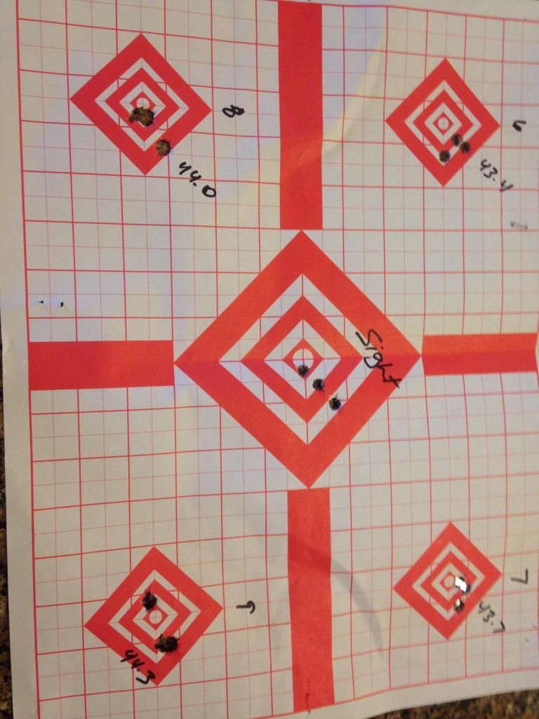

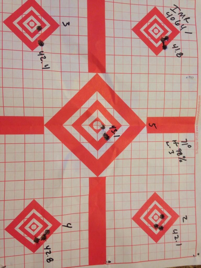

I recently started reloading and loaded my first rounds for OCW testing. My loads are as follows...
308
Lapua Brass
Fed 210 primers
imr4064
175 smk
All rounds were loaded to 2.800, I loaded these rounds from the tip of the bullet to the base of the cartridge. At the time of loading I didn't have a bullet comparator to measure, ogive, I do now. When I measured ogive on these bullets it had quite a bit of variance due to me adjusting my die to get close to 2.800. Next time my reloads will be more uniform as my measurements will be better.
Any advice on the pics below would be appreciated. I'm thinking I have a node somewhere around 42.8-43.1 and 43.4-43.7
All groups were 3 round groups.
