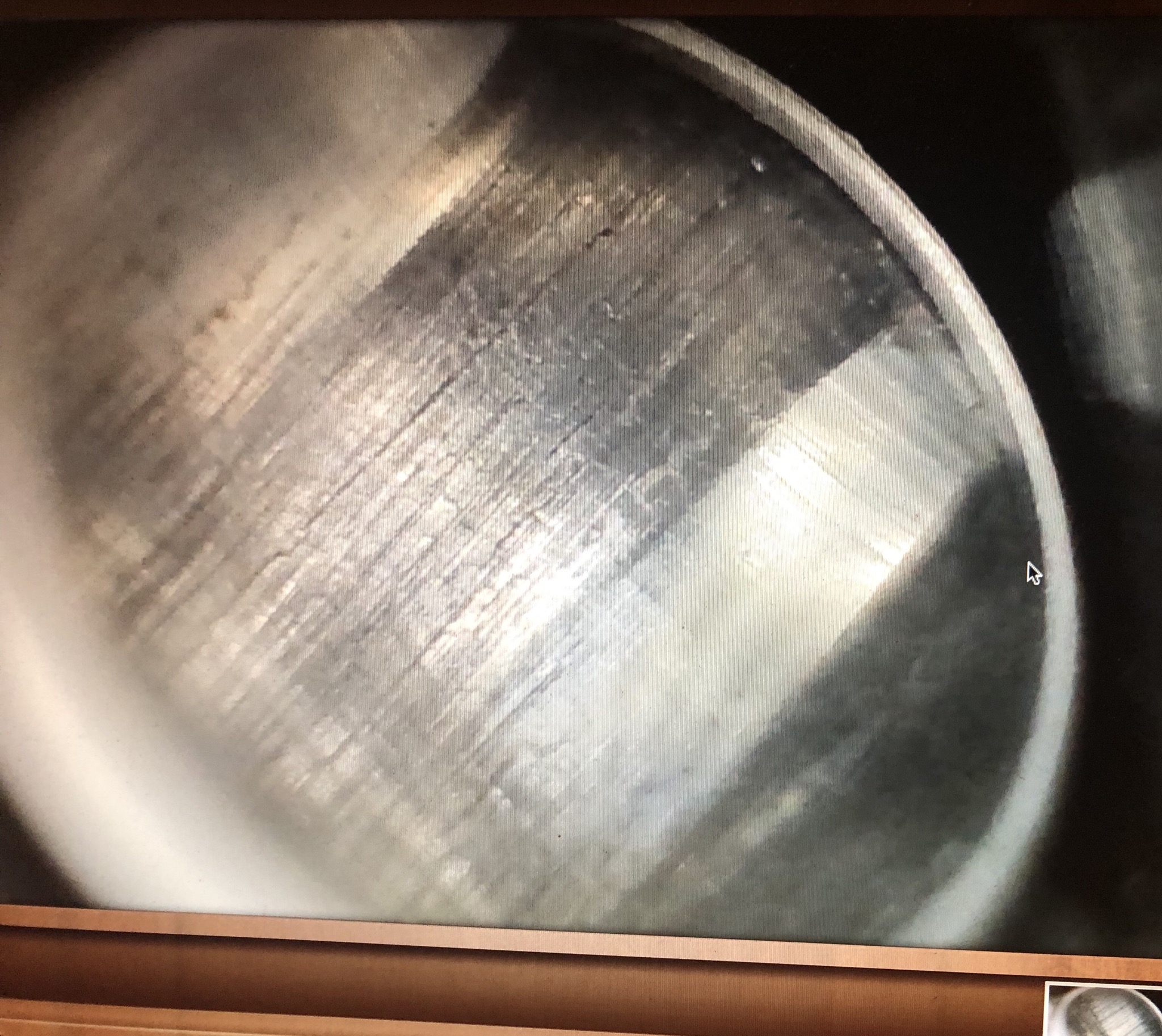

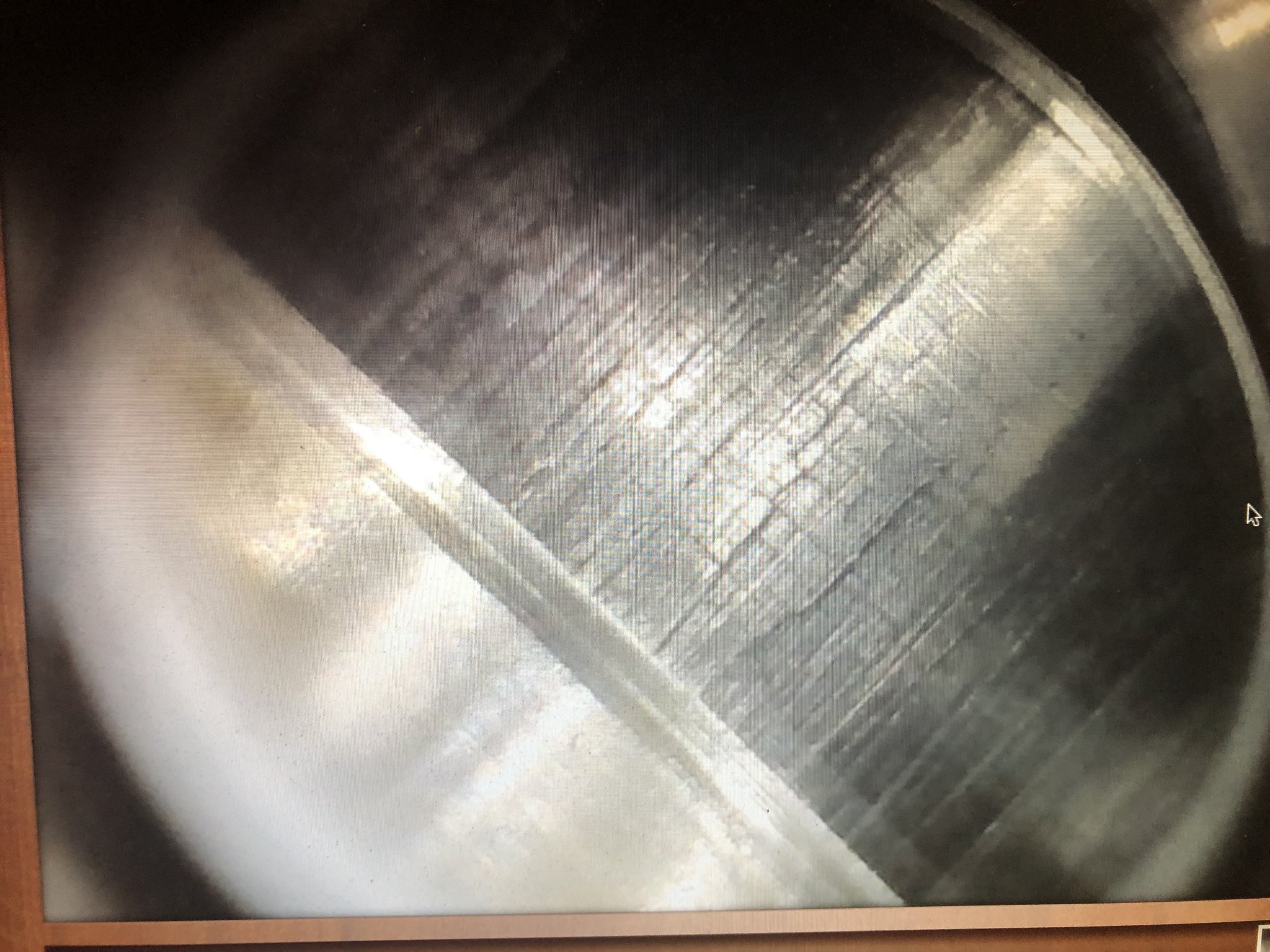

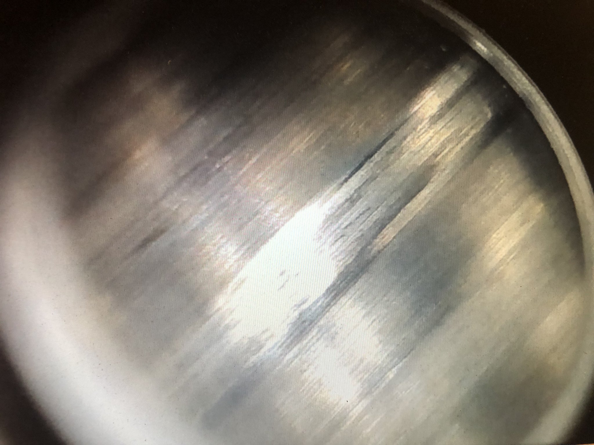

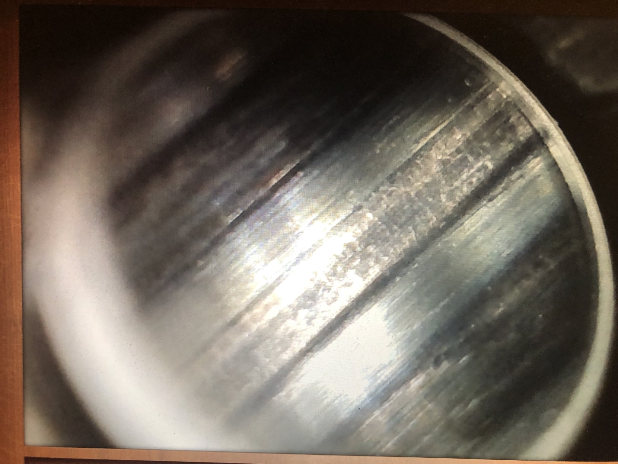

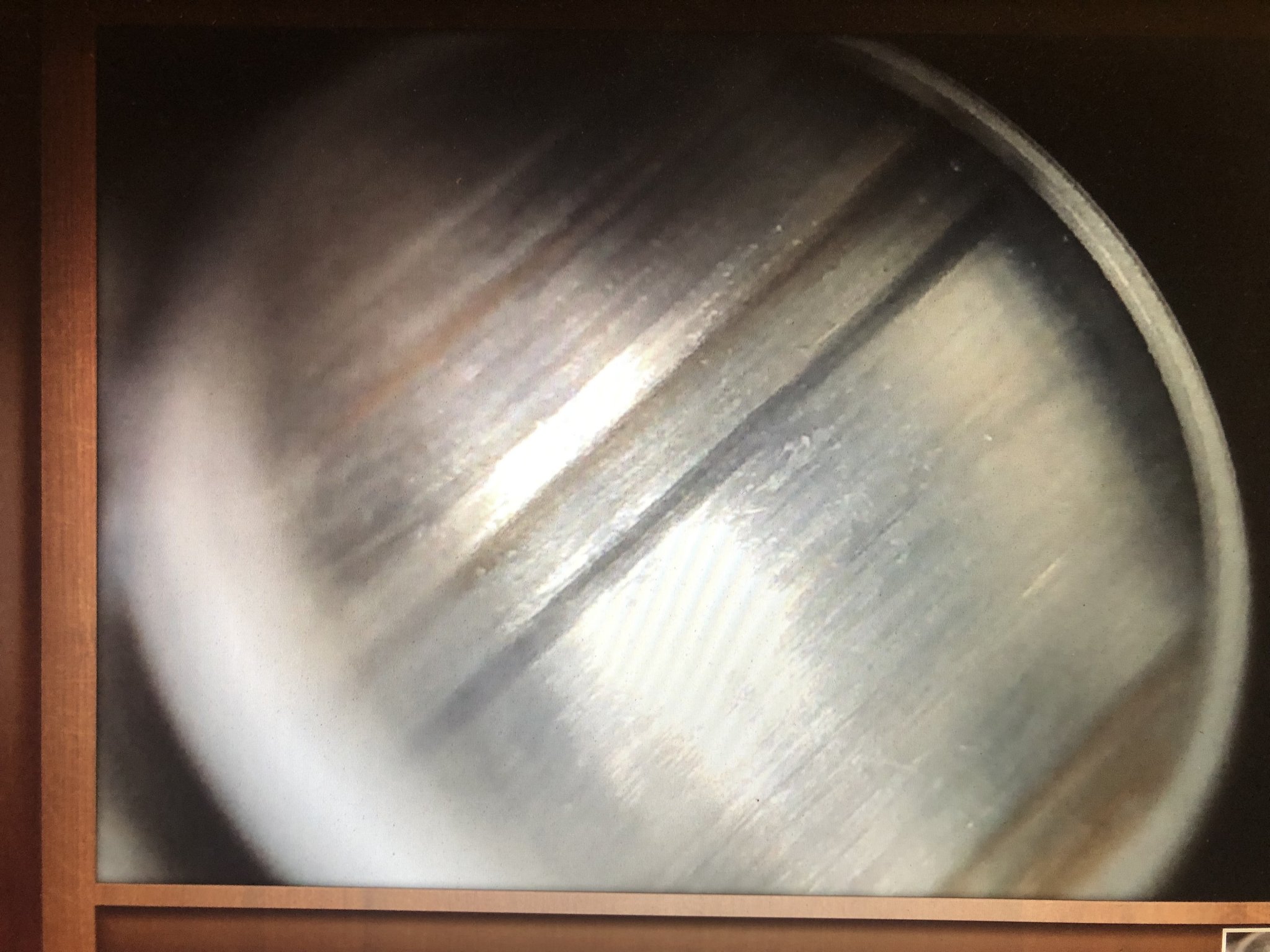

Picked up the old 6 Creed barrel yesterday, set back .200”, basically wiped out the freebore...hit it with 100ish passes of JB bore paste
Gunna try to get out and shoot it with the old original load and check velocity/accuracy next week, hopefully
Some bore pics below...
At the end of the neck
7120630
Start of lands...
7120635
2-3” in front of the lands...
7120637
Halfway down the bore...
7120638
At the muzzle...
7120639
