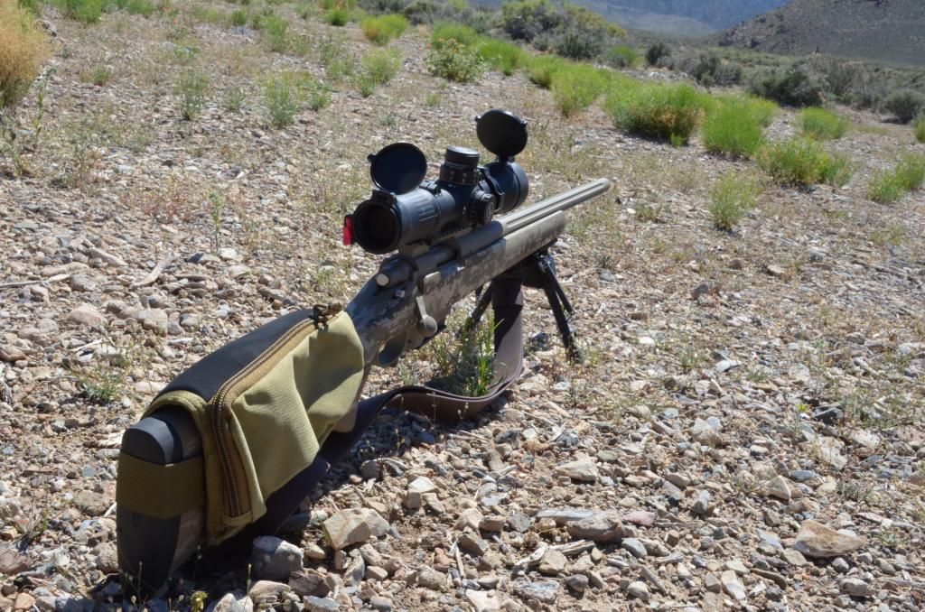

    I finally made it home long enough to put everything together with my new LRI build. My rifle is typical of all of them that you see here done by Long Rifles. Fit, finish and function are exceptional. The bedding job is especially impressive to me-- the process and the results. I took it out today for the first time and got so proud I grew the motivation to share.
    M700 Stainless short action
    Bartlein 1:8" twist barrel, 22" long, Rem varmint contour. LRI straight 7-flute pattern
    Manners MCS-T
    PTG bottom metal & AI mags
    EGW 20 MOA rail, Warne 34mm rings (low), Vortex bubble level
    Leupold Mk 6 3-18x44 w/TMR reticle
    Turner Saddlery sling
    Triad tactical stock pack

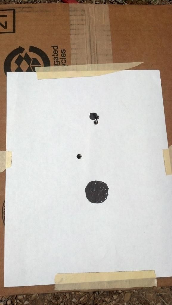

    50yd initial bore-sight check. 1st round was 1.2 mils low, .7 mils left. 3 more shots in a cluster. Checked for pressure on the brass after each shot. Nothing at all.

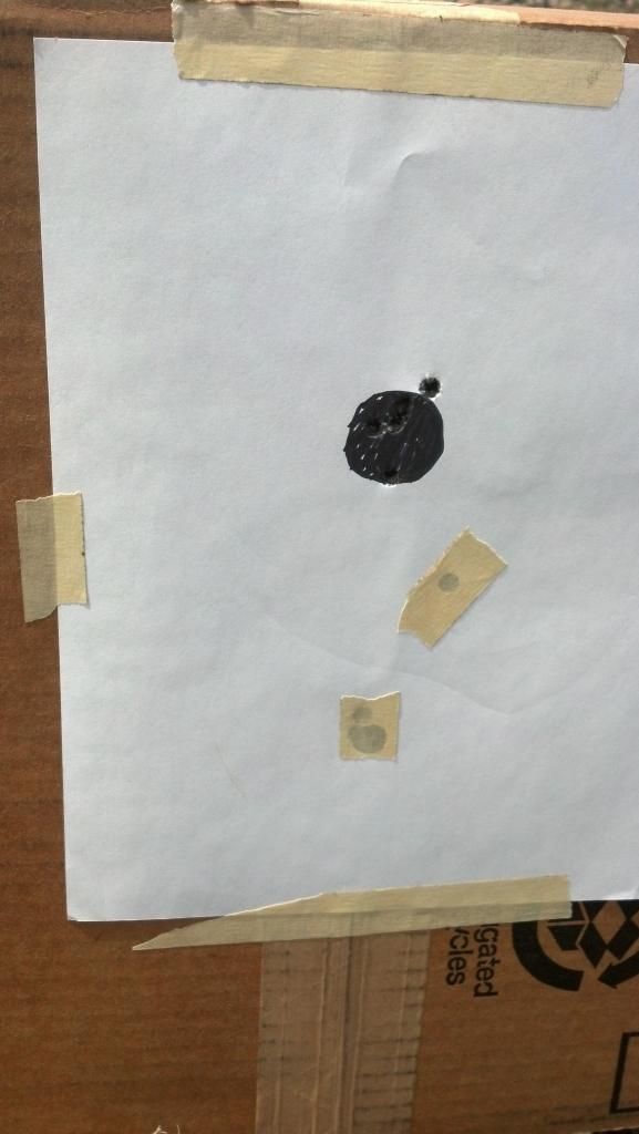

    Then to 100yd. First shot was low, went up .2mils, and shot 5 more (there are six un-pastied shots on that paper). The 2nd to last one I pulled and went out of the black. The other 4 are on top of each other. I had to take a few minutes to calm myself after I went down range and saw that cluster.

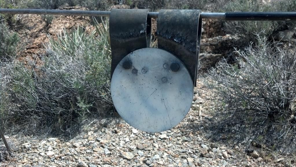

    I reset the turrets to reflect the 100yd zero and started hiking my 8" AR500 plate and stand out for some longer range "testing". I found a spot, set it down, and walked back. Ranged it at 433yd. Used a guesstimate from Strelok on my cell phone for 2.1 mils and shot at a rock face near the plate. Impact was about .2mils left (wind) and .2 mils low. I set the turret to 2.3 mils and held on the right edge of the plate for 5 rounds. Anticipated the last shot a bit, but still produced this. The wind was shifting a bit and I didn't account for it. I was going for elevation data.
    Again. It was hard to restrain myself when I went down range. Sub MOA vertical (pushing 1/2 MOA if I could shoot) with a BS random load about 20 rounds into a new barrel.

    Eta: Rifle is 9.0lbs empty/stripped and 12.6lbs as pictured
    The Mk6 is a great scope. I was trying to keep weight down to make this rifle a sane choice for hunting where I may have to hike. I was going to use a NXS 2.5-10 but found the Mk6 and saw how light it was and thought I'd give it a try. Overall it's pretty impressive. The glass is comparable, if not a touch better than the NXS's I own. I can't see anything with one I can't with the others. The reticle is a bit thin below 6x, and thick above ~15x, but still usable. The only real complaint is there is a bit of "asthetic" slop in the elevation turret. You can wiggle it without pressing the lock tabs about .1 mil worth of rotation. It doesn't move the reticle, but it does make it easy to put the wrong dope on by .1 mil. Everything else has worked great.
