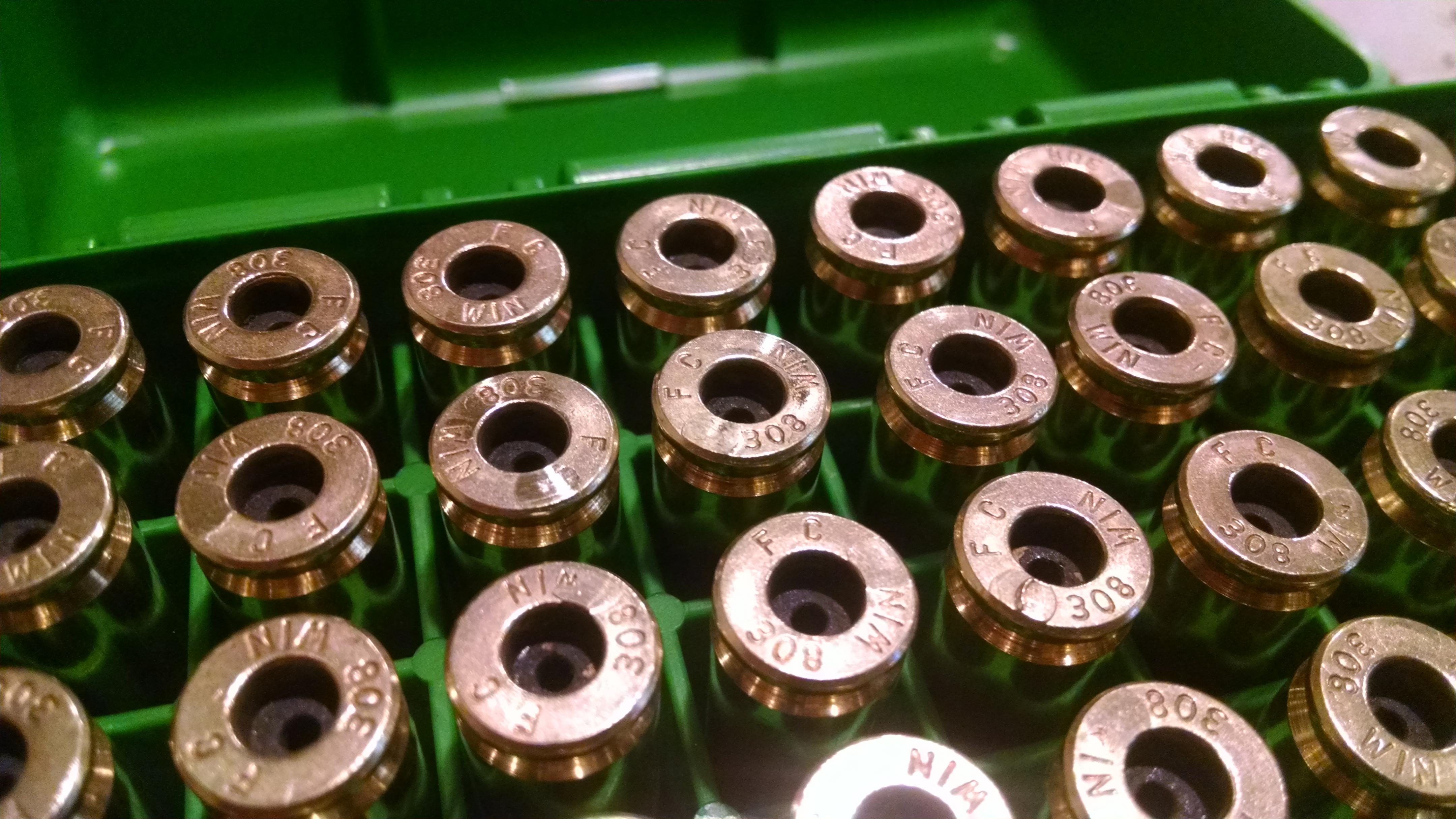

First time out with my thunderbeast 30p-1, all I can say is dam this is nice. No POI shift, no loss in velocity, I simply screwed the can on and shot. Dope out to 1k was exactly the same as previous times out. Only problem I did encounter is my load which is .308 cal 47gr of varget with a 155 amax seated .030 off after about 4 to 5 shots things started to get warm and I started to get a sticky bolt. Ive used this load the last 3 or 4 outings with no problems with out a can. My other load which is 43.5 gr of varget and a 178bthp .030 off never experienced this problem even after a string of 15. I went back to the 155 load after the rifle cooled and same thing, 4 to 5 shots and a sticky bolt. I probably have to back that down a bit, but thought I would get some input from someone who has experience this same problem.

My bolt also got sticky after using my 30P-1, but I think its just the nature of the beast shooting suppressed. The super tight tolerances of my BAT actions I'm sure doesn't help. Just keep some grease on your lugs…that helped me run smooth with the can on. Where your groups just as tight with the can on vs off?
The best I can describe what was happening is that the case was swollen so it didn't move in the chamber. It also distorted the case so it pushed the rim back into the ejector button. When I lifted the bolt the case did not move which sheared off the brass that was pushed into the ejector button. The brass is still tight even after resizing. length is 2.010-2.015 on about 5 I checked. The bolt is greased as well as the lugs. Groups were just as good from what I could tell didn't spend a lot of time at 100yds, but was grouping at distance seemed just as good. If there is other input from the pics or someone else has seen this I am all ears. For now I will not use that load.
