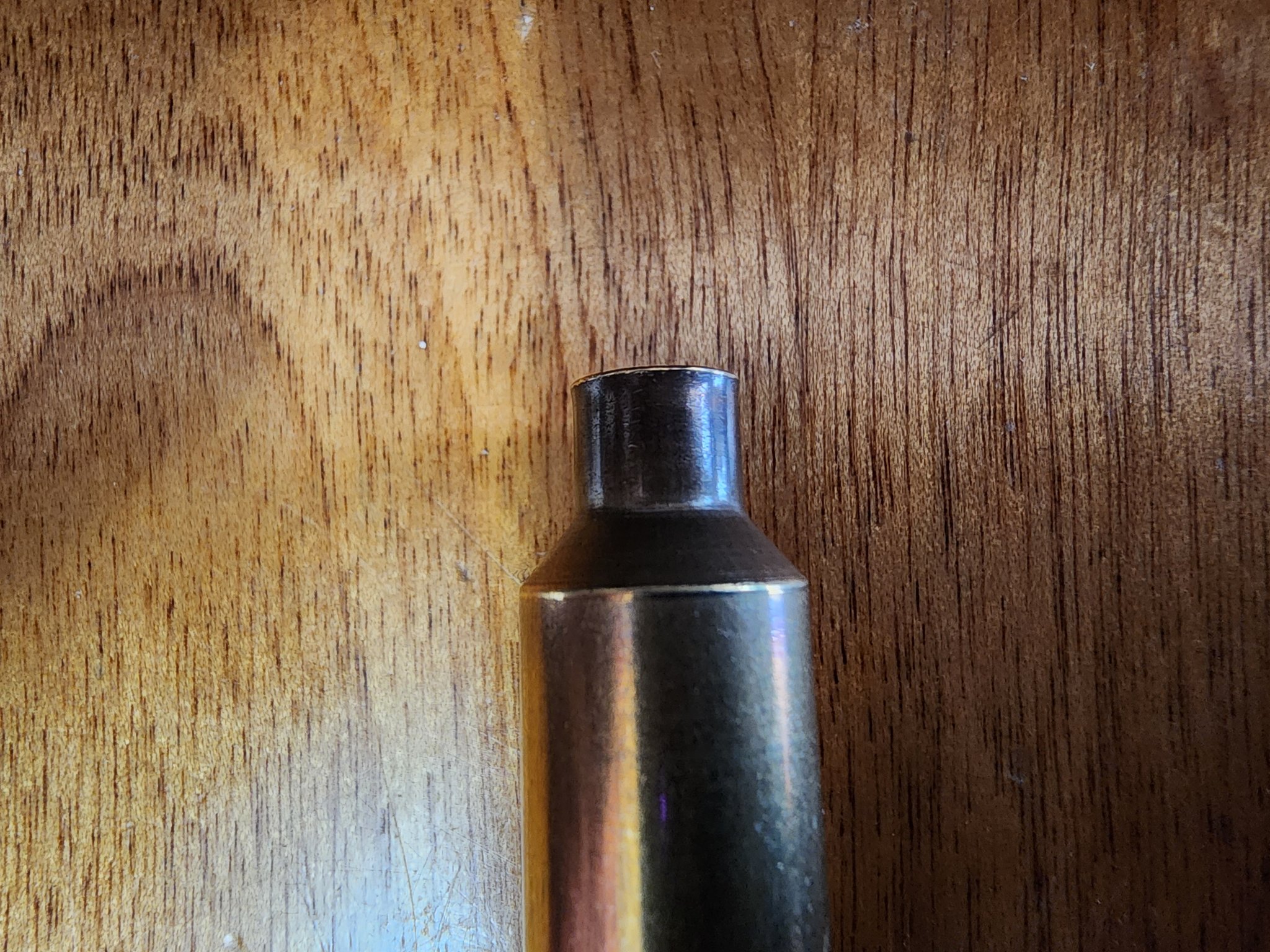

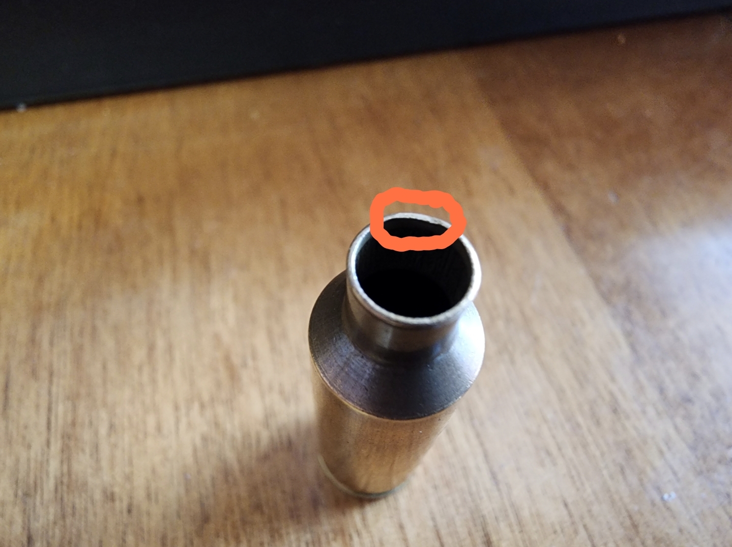

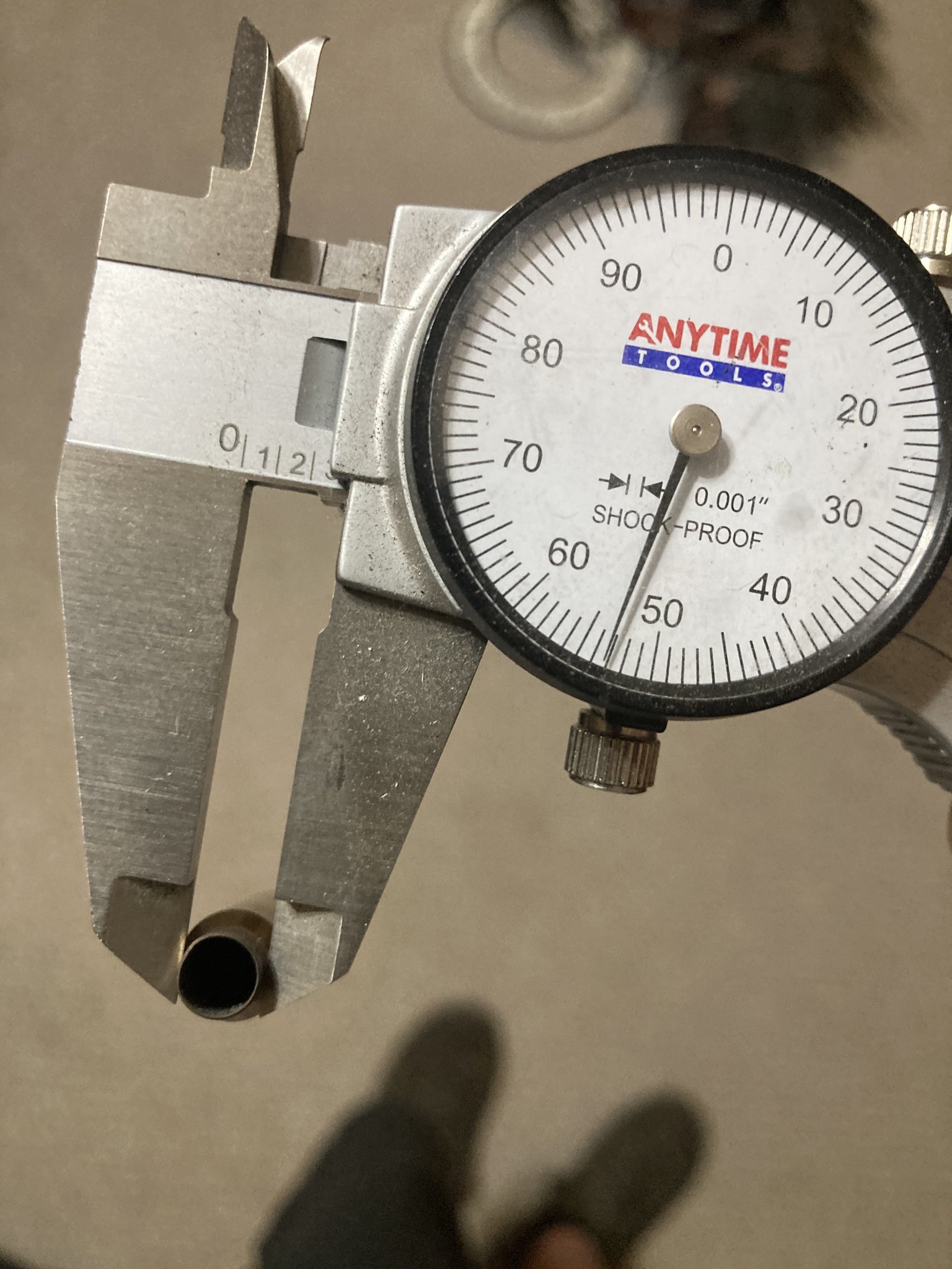

I have approx 20 cases that have a belling on the lip. While I am still trying to figure out the cause (likely too long case size or too much neck tension from what I read), is there a way to fix these cases so I can still use them or chucking them is the only option now? I have tried chamfering the lip but it still wouldn't chamber.
Also, these cases have a slight "dent/chipping" at the lip, likely due to me applying more pressure than needs to in an attempt to close the bolt (it didn't close).
The size difference is as follows:
.268 at the neck
.271 at the bell
The cases are Alpha 6mm Dasher
Thank you

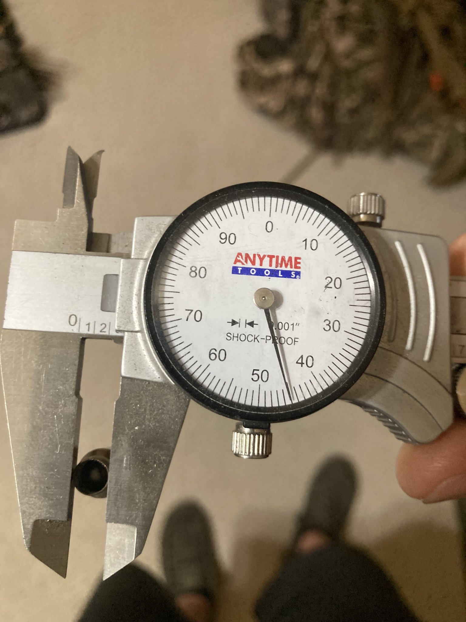

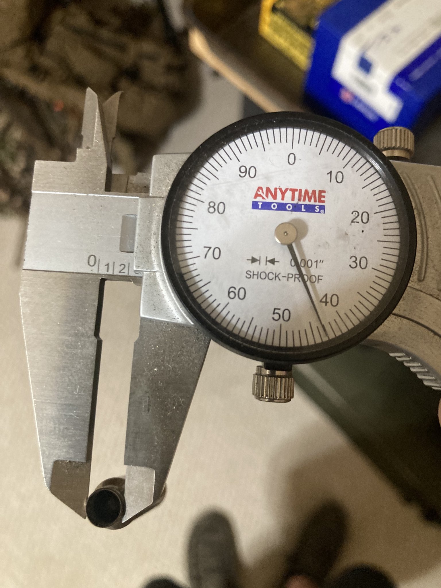

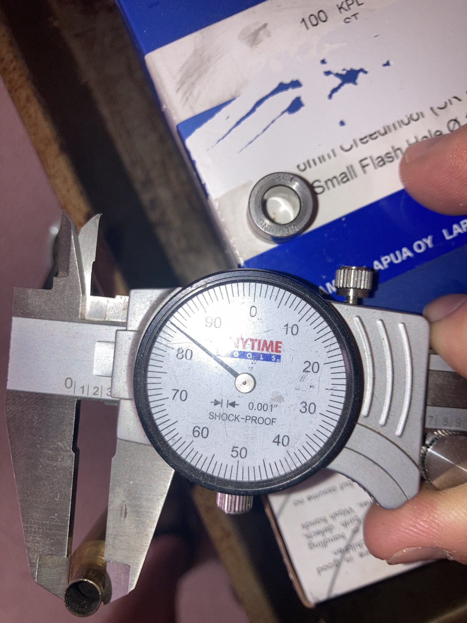

This is what the problem Diggler asked about looks like…
Fired 223
Sized straight to .245 bushing @ mouth
@ Neck

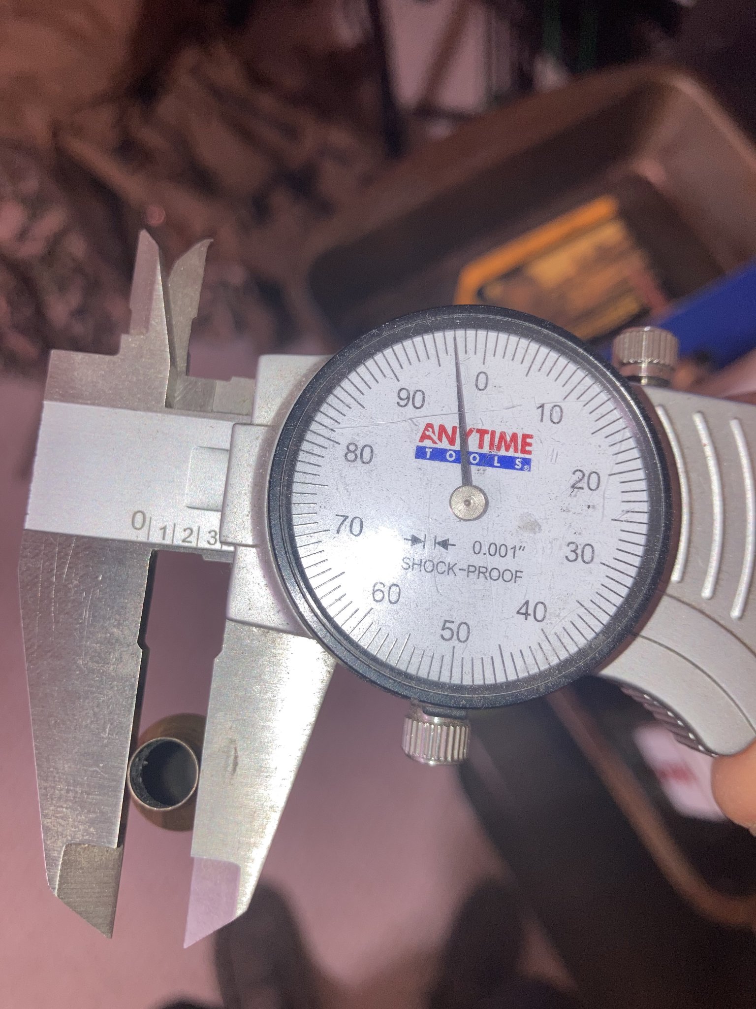

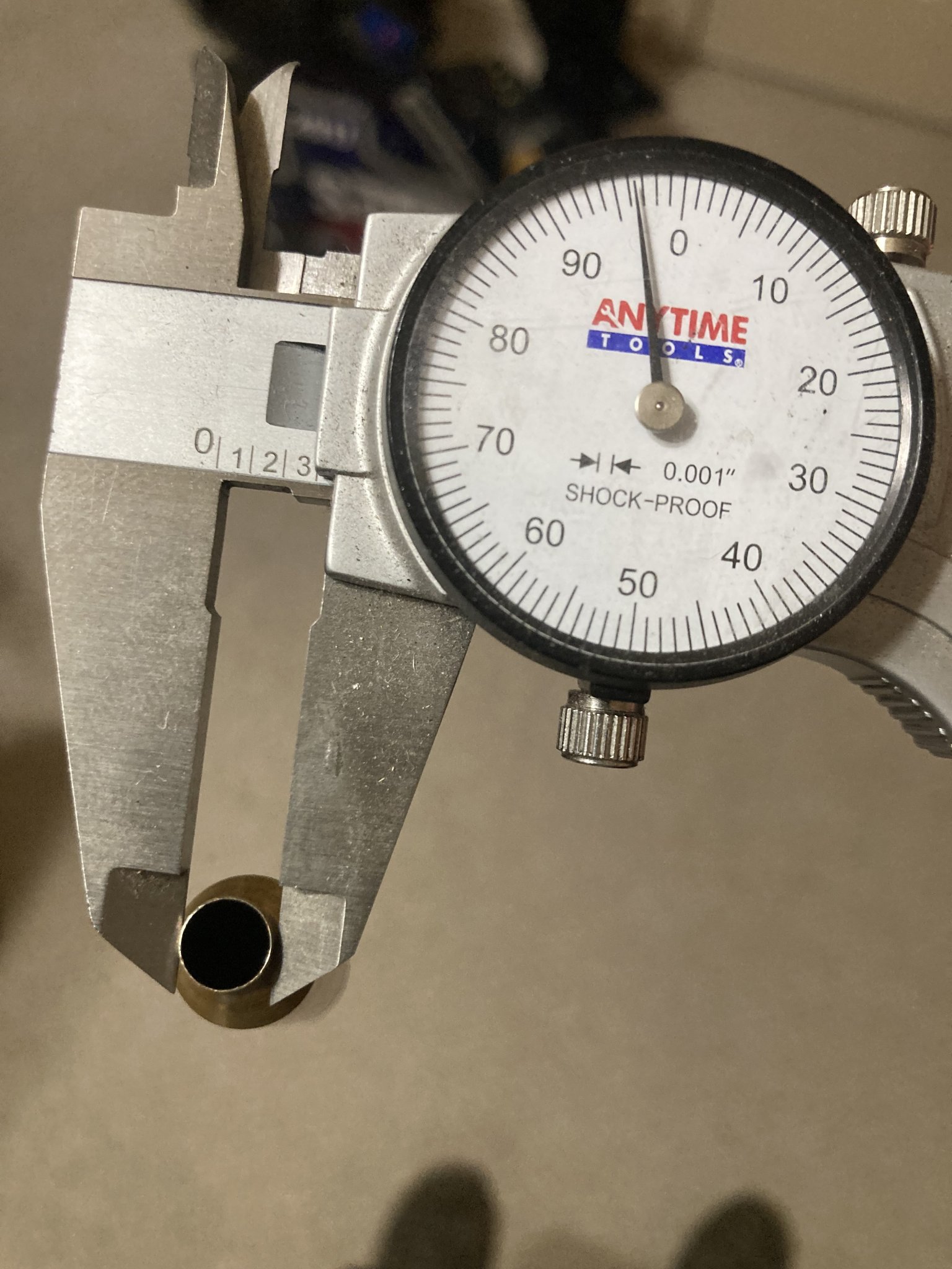

Here is the same thing done on 6.5prc brass
Fired
Straight to .287 bushing @ mouth
@ neck

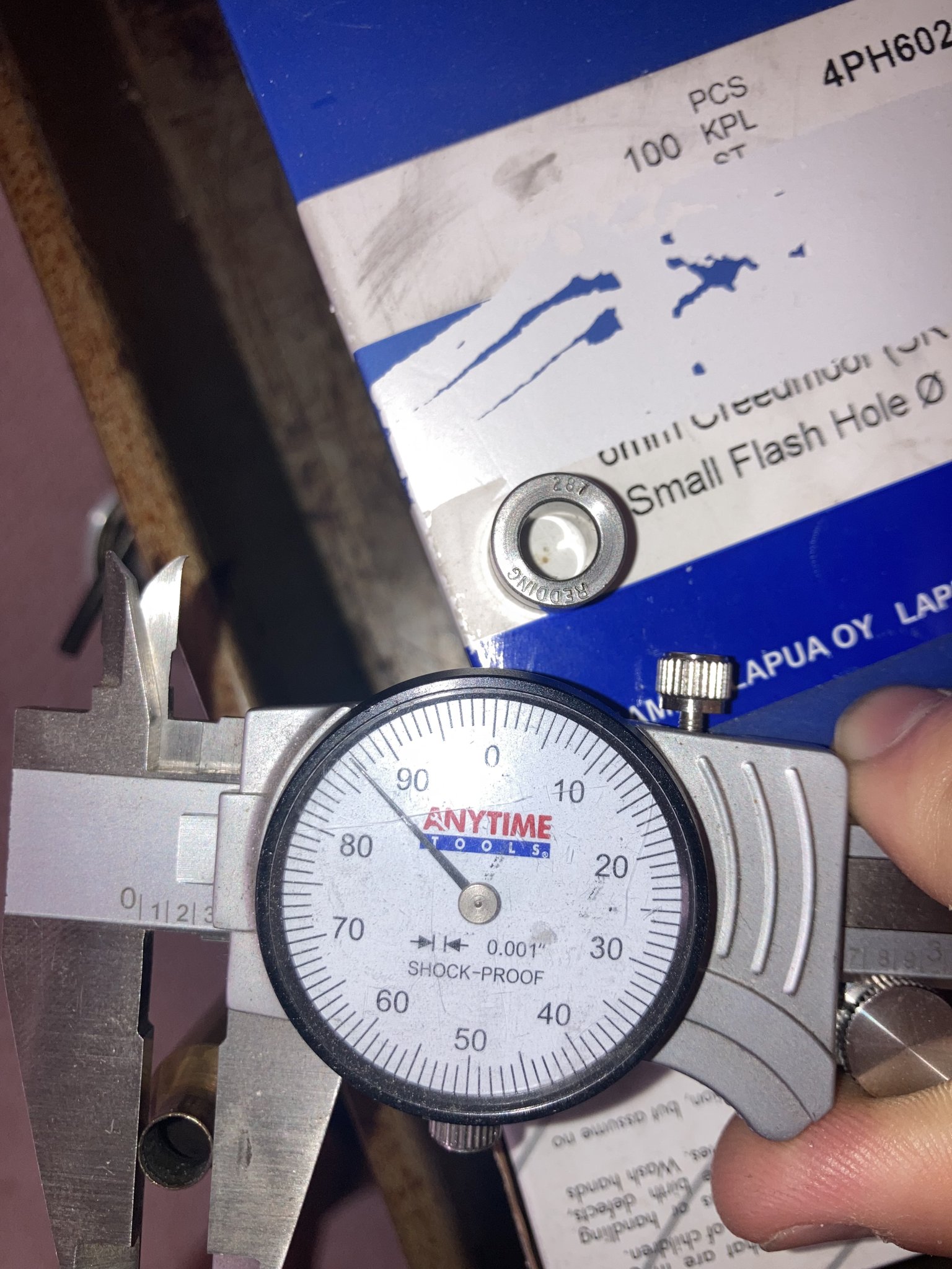

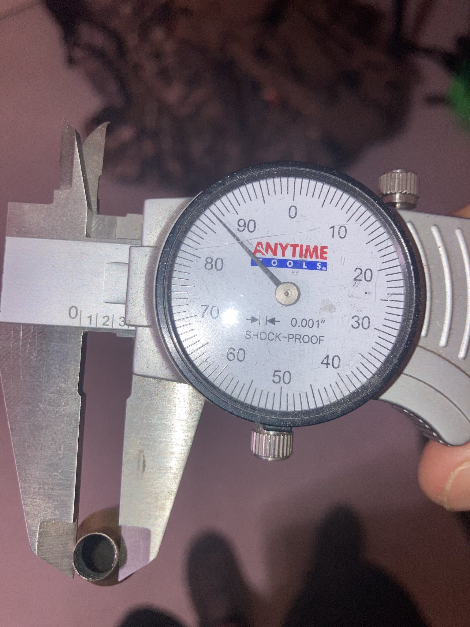

And another piece of fired 6.5prc, stepped to .291 first and then .287…
Fired
.291 then same .287 bushing @ mouth
@ neck
