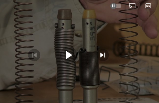

My main reason for wanting to try a flat spring is because it is shorter when fully compressed. I have one rifle with a specific buffer setup that could benefit I think. It's worth a shot if for nothing but academic reasons.

It shoots super nice now. It's way smoother than before, however because of the spacer and the spring, it will bump the bottom so to speak from time to time. If you look at the picture I put up earlier in the thread it shows how much shorter it is when compressed.
I know it can't travel too far back because of the spacer, but I think it's going to full compression every now and then. I think the flat wire will open up a little bit of space in the buffer tube.
