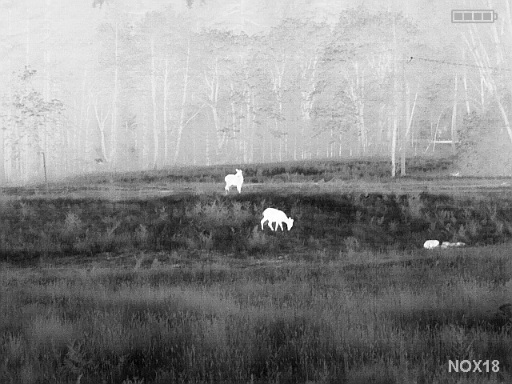

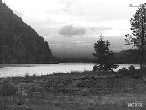

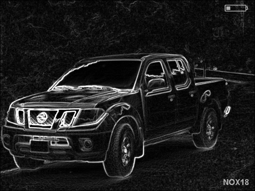

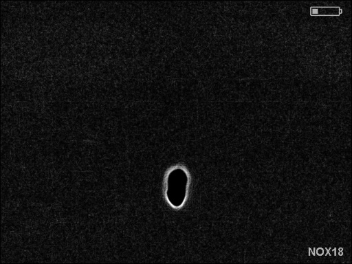

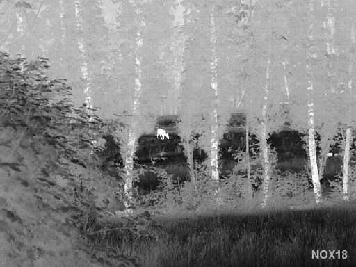

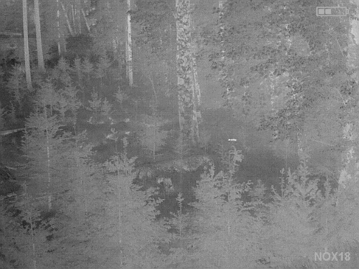

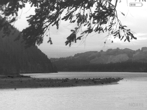

Nox, no question.
I'm really happy with my nox. For the price I was expecting a lot and it exceeds those expectations. I try not to be too much of a fan boy because I don't have anything except the coti to compare it to but we are sold enough we will be getting a second without seriously considering alternatives.
The nox is ready to go out of the box. We put batteries in it and stated using it and haven't made any adjustments other than flip caps. This has been great since getting everything else sorted has been so time consuming. I'll eventually dig into the menus and play with the settings but for now it works great as is.
