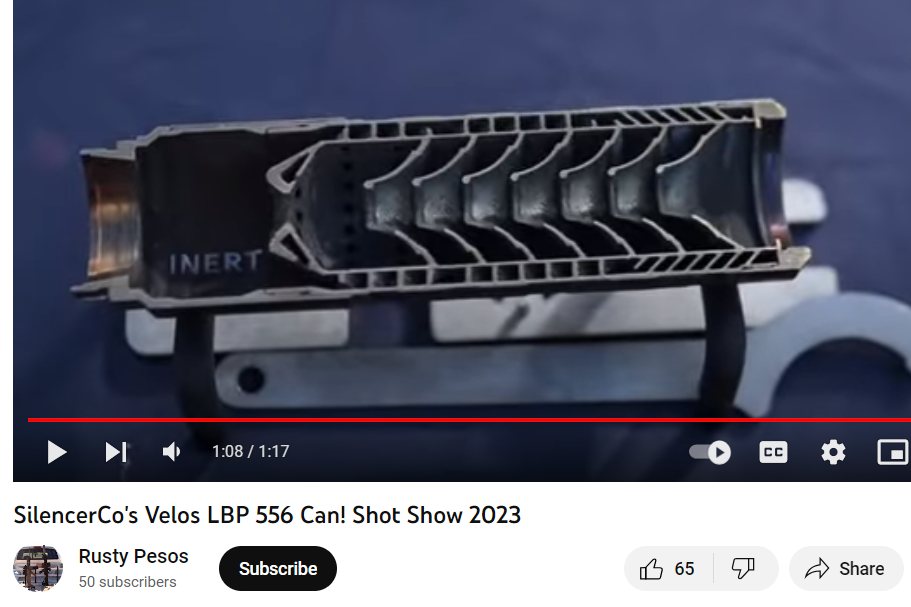

That seems to be a similar approach to the new SilencerCo Velos LBP. It's a hybrid, 3D printed and welded flow through design, with more durable materials and blast baffle than the fully 3D printed Huxwrx.
I would assume a company like SilencerCo has more money to throw at this than a smaller company, so I expect the Velos to be decent as a first go at flow through.
