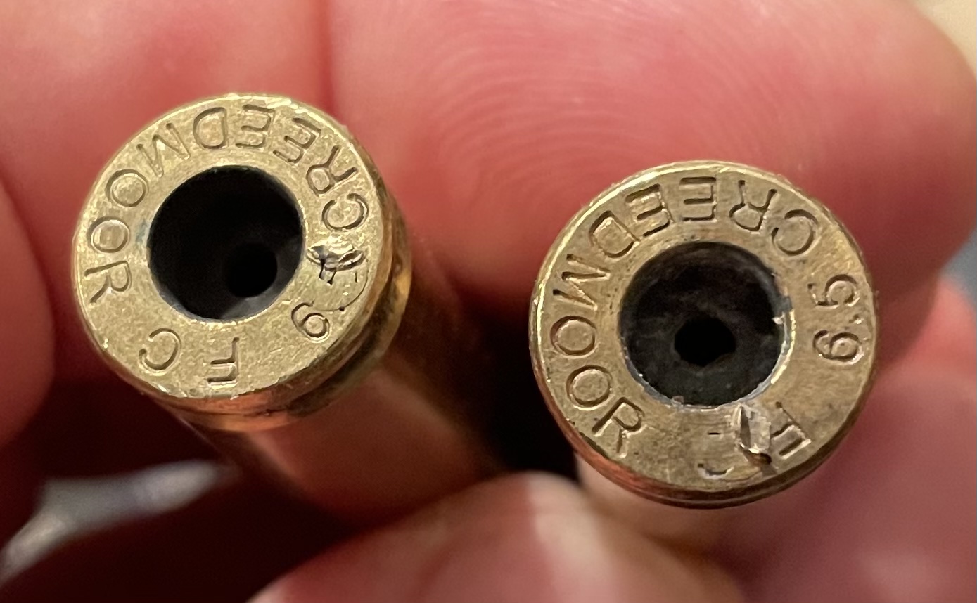

I’m not thehun but I have my single experience in this. My 20S 6.5 is back at FN as I write this for piercing primers, and in the case of the 130gr Bergers, completely blowing them out of the case.
I wish I kept some of the 140 ELD cases to take pics of too, but those appeared to have the firing pin punching a perfectly round hole in some primers. Only fired maybe 25 rounds from my rifle before I sent it in. Sucks because it was expensive and I figured FN would have learned all the lessons about 6.5 that other companies have by now (JP, LMT, etc).
I’m hoping they can fix it, and if not, just swap me a .308 barrel. I could accept that I guess. Anyway, not dumping on FN. Optimistic they will make it right.

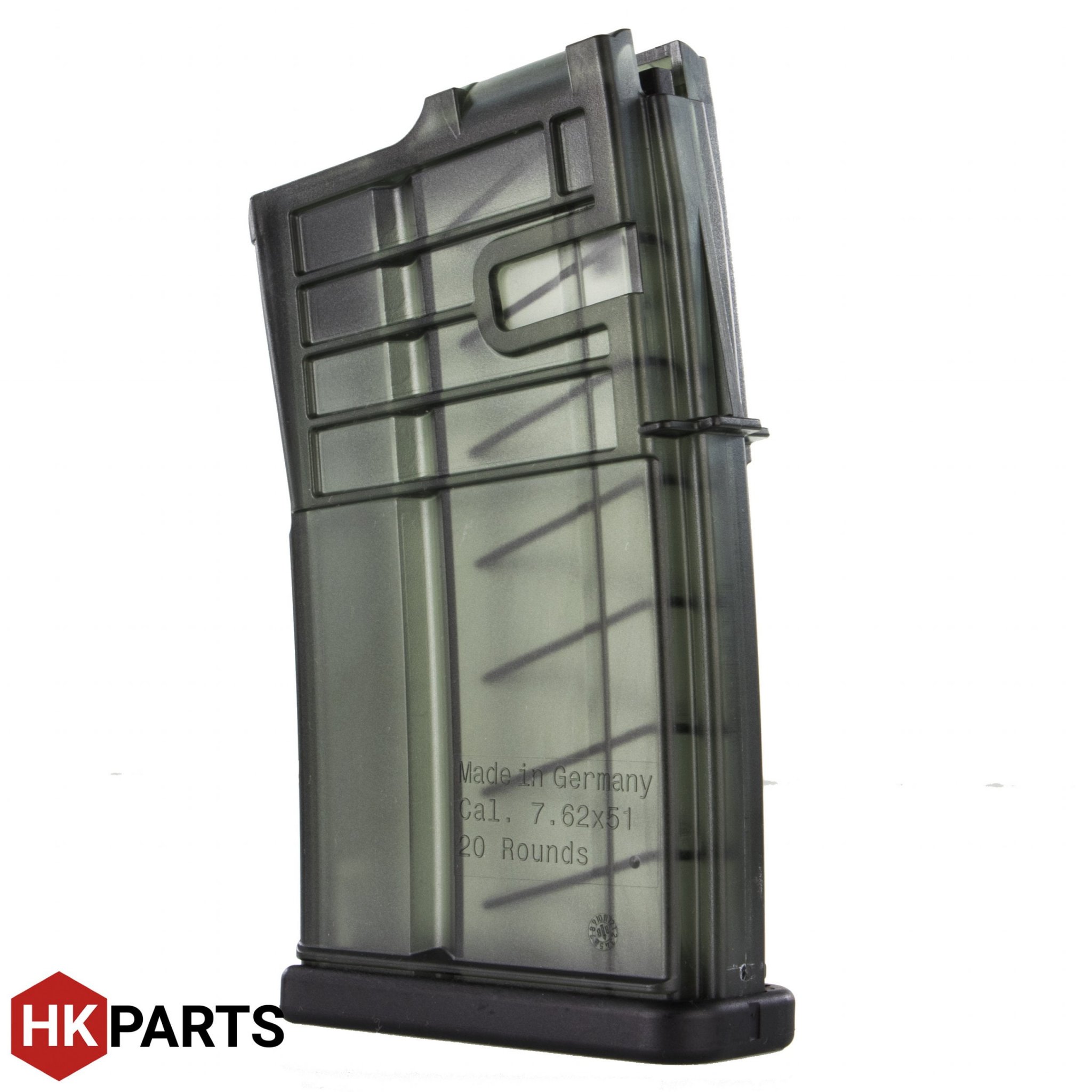

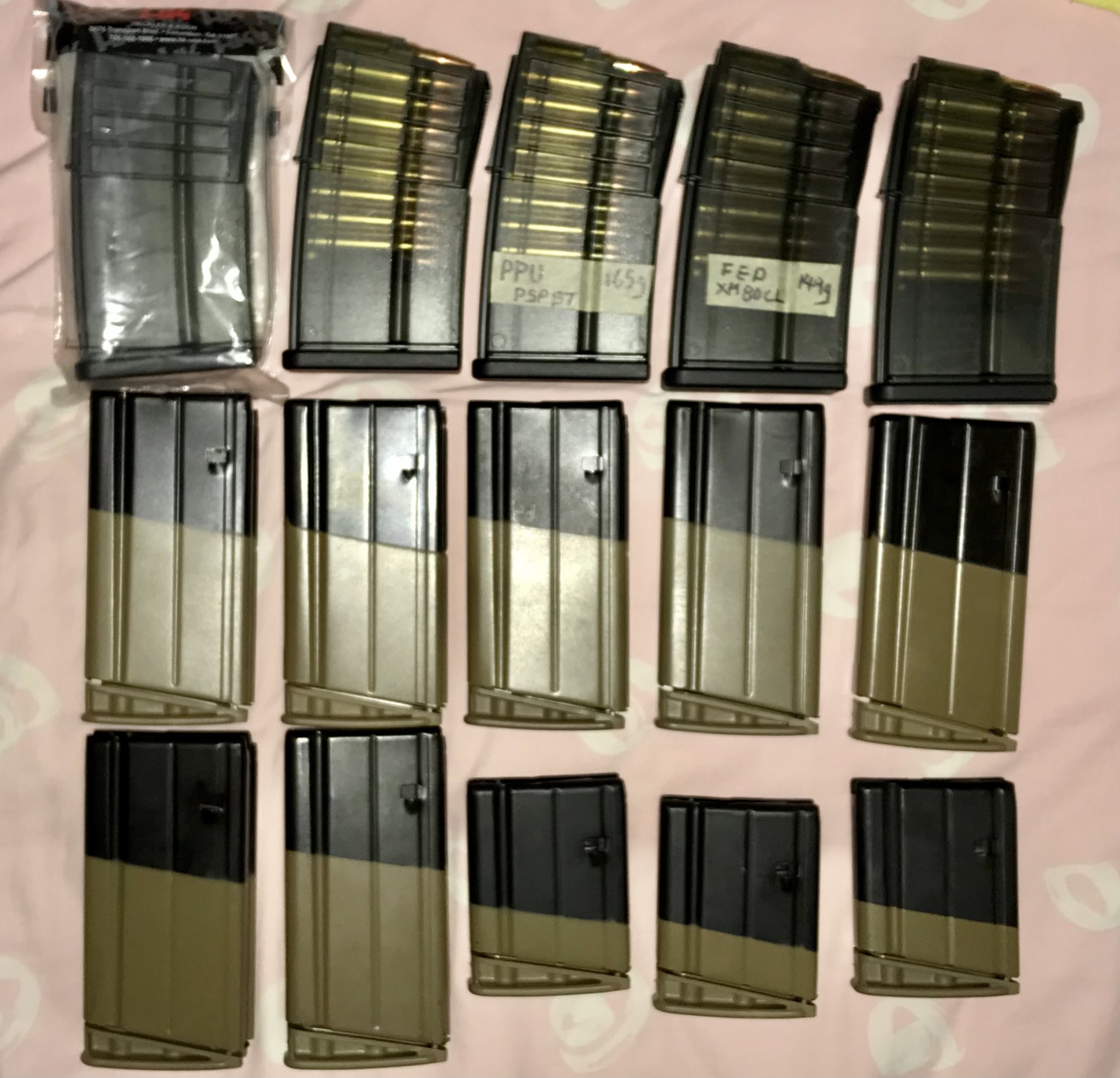

HK MR762 20rd mags are $90
FN SCAR17 20rd mags are $49
Magpul PMAG-LR 20rd mags are $20
