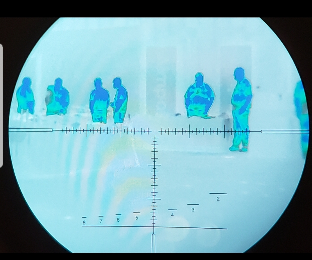

T3 reticle in L&S Mk6 3-18x behind UTC-x on 3 power. Click on the pic to make it larger.
So, even in the crappy thru lens pic, you can see the cross hairs fine and with mk1eb I can see the 1 mil hold lines fine. Can I see the .2 mil hold lines ? No.
