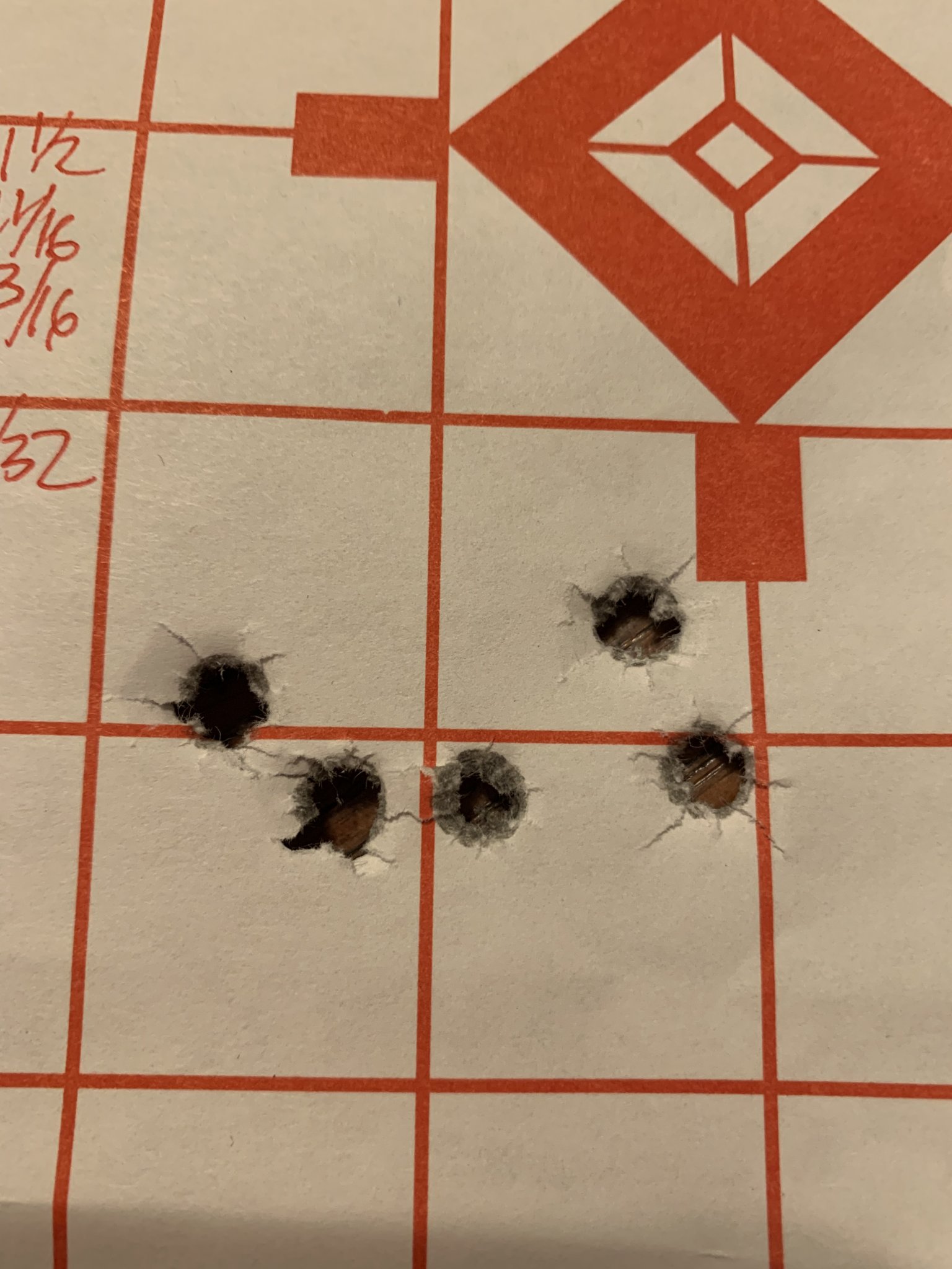

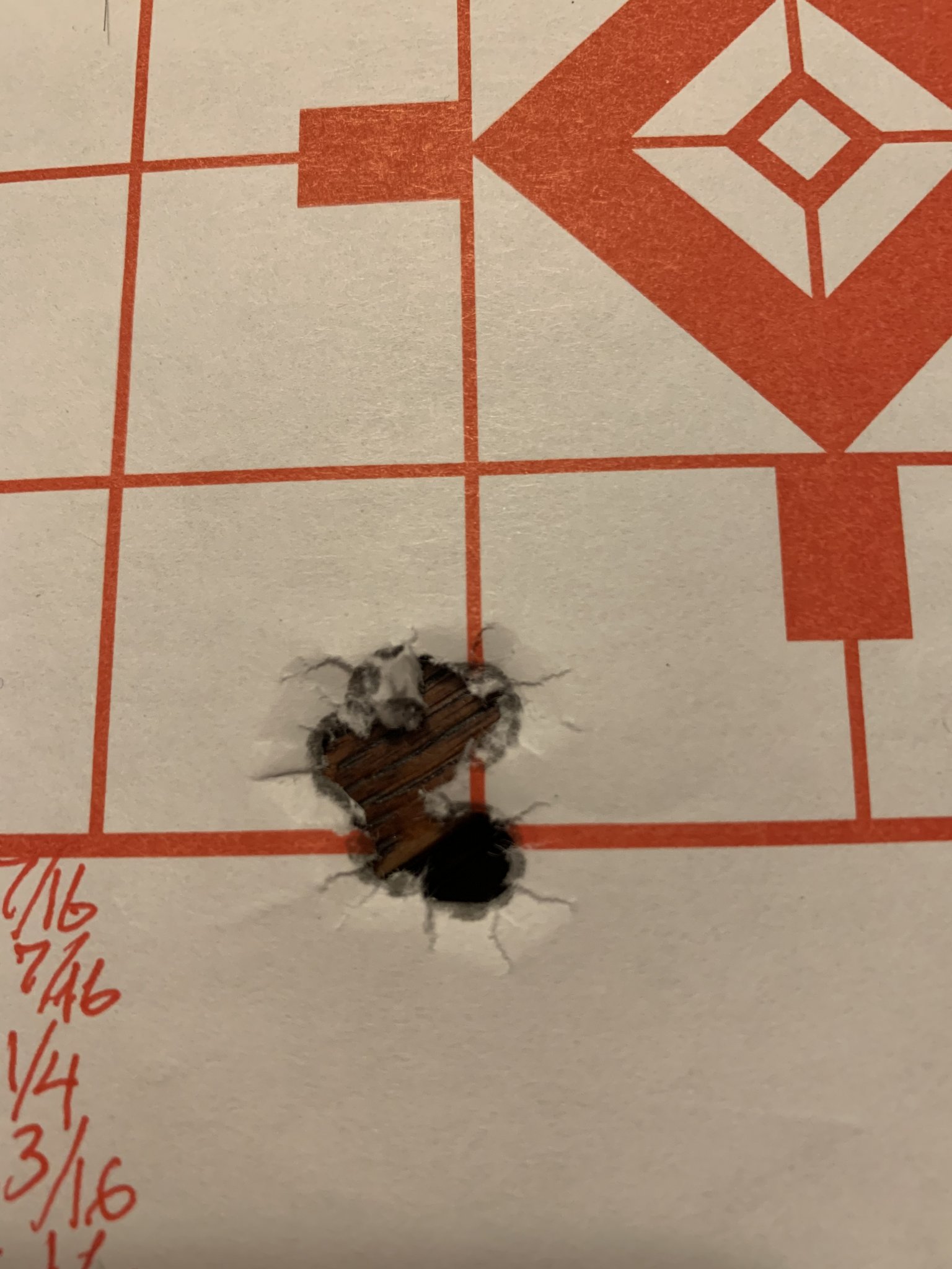

This is a follow-up to an earlier thread of mine. Remington 700 rifle in 308…reloading 185 grain Berger Juggernaut with Varget and H4895, Lapua brass, CCI primers. Shooting at 100 yards off bench, bipod and bags.
I’m trying to develop a load for that bullet. Last week I loaded 11 rounds with both H4895 and Varget at .2 grain increments to look for a ”node” of similar velocities. The Varget…loaded with 11 rounds from 43 to 45 grains (in .2 grain increments) yielded a group for all 11 rounds at different velocities…of 1.25 inches at 100 yards.
Yesterday was quite different.
The first photo is 42.9 grains of H4895. SIX rounds in 7/16 of an inch. Ave 2624 FPS, SD = 18, ES = 48. I love the group size but don’t like the SD and ES if stretching out to long range.
The second photo is 44.4 grains of Varget. Five rounds in 1.5 inches. Ave speed 2579 FPS, SD = 7, ES = 20. Lousy group (worse than with 11 rounds loaded at different charge weights) but acceptable SD and ES.
To add to the information/confusion, with 41.7 grains of H4895 I had another six shot group at ¾ inch but an SD of 13 and ES of 34.
Why the heck is such a GREAT group coming from such lousy SD and ES? And vice versa, such a modest group from a very nice SD and ES?
What gives?

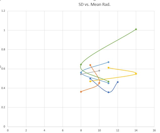

ES/SD and group size only show correlation in combinations that are absolutely awful for the given cartridge. For the vast majority of 'popular' combinations, there will be no correlation between group size and ES/SD, all else being as equal as possible.
Group size opening from velocity variation doesn't begin to show up until after 400-500yd.
Mean radius on the left at 200yd in inches. MV SD in fps on the bottom. This is 6mm ARC with 110 A-tips, each color a different powder in 3x 1.0gr increments, each dot 20 shots worth of data.
No real correlations to be found.

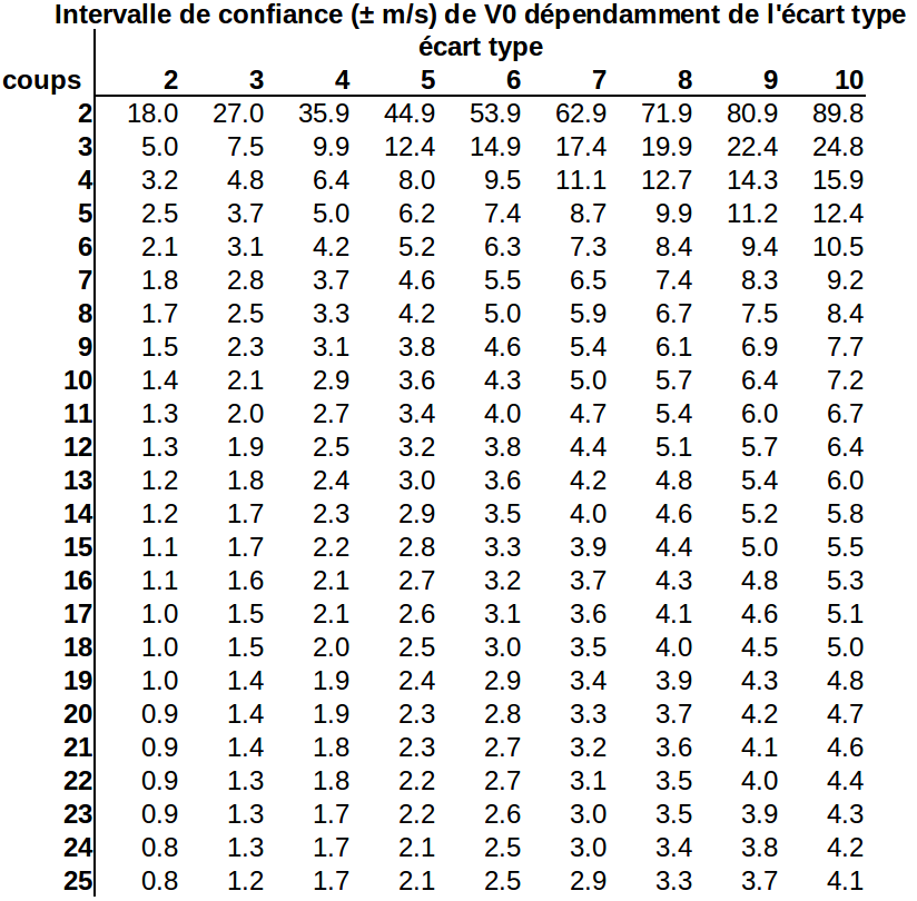

ES on small samples is an extremely poor measure, as it is too much subject to random noise.
SD is way, way better, but then again, in order to have something meaningful, you need a certain number of shots anyway.
Here:
rows = SD in m/s (to convert to archaic units, multiply by 3.3)
columns = number of shots
values = 95% confidence interval (+/-) of the values obtained
Example: on a string of 10 shots, SD is 3 m/s (roughly 10 fps). Well, the confidence interval is [0.9 .. 5.1] m/s, that is ~ 3 .. 17 fps.

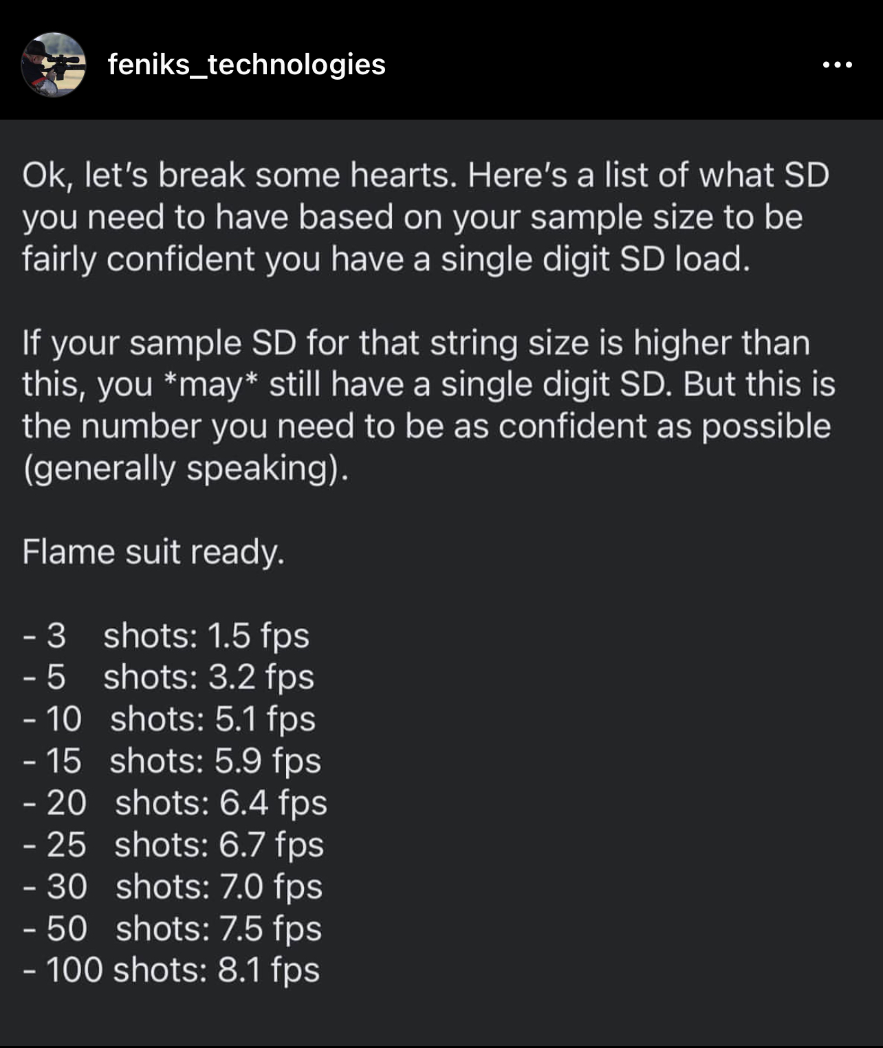

With the 408 and 416 Colossus our average group size is around.500 standard deviations was Final developed load has been an average of 2 feet per second on five shot strings I had several five shot strings that were 0
Here’s a screenshot of a post I made in a few platforms.
It gives you the SD required vs the sample size to have a known true single digit SD in the long run.
Obviously there will be some exceptions. But this will cover roughly 95%.

So, a 2sd on a 5 shot string:
Could be as high as 5.7sd which would be around a 24 es 95% of the time. Obviously that is the highest. It could be as low as just over 1fps sd which would be under 5es 95% of the time.
on the last test I did I did not have an extreme spread that was four feet per second. And that was last week
@Feniks Technologies
Here:
So if this is real data then I'd point out that the three shot number is awfully predictive of the 25 shot number.
-Alex
