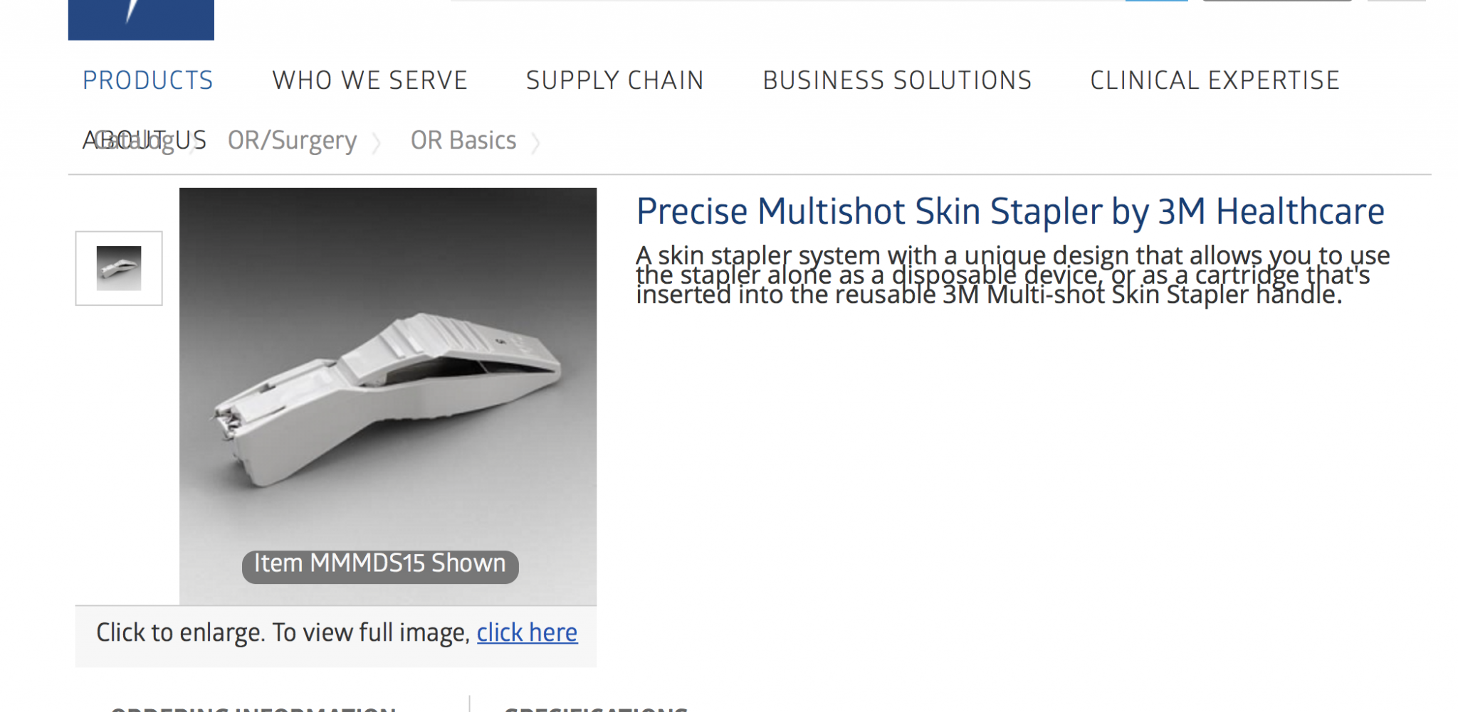

A simple 3M surgical stapler, e.g. AKA "the cricket", with 5 staples each cost $10. Staples applied 1 cm apart would close a 7 cm laceration without any of the device bulkiness and can apply closure more effectively in areas of tight skin closures e.g. hand, curvatures of the shoulder etc. FYI- pretty handy to have in your outback first aid kit, even if you do know how to suture wounds.

The cricket stapler.
