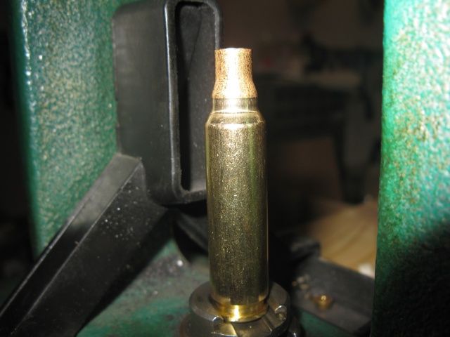

Here's a Rem case after die #1

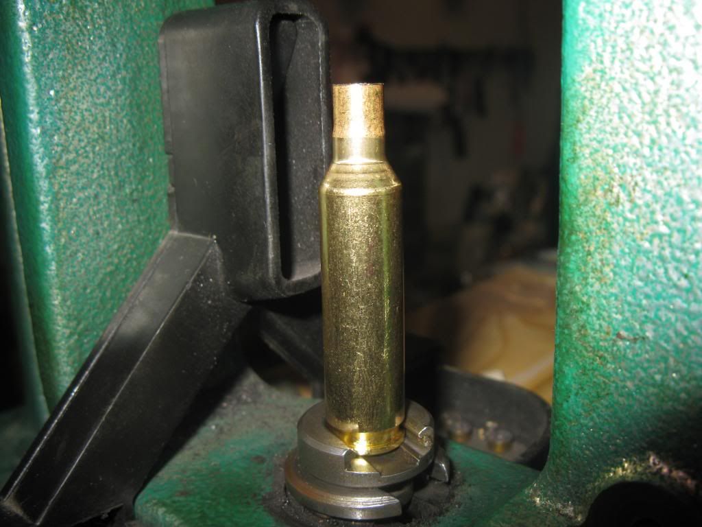

and after die #2
I'm going to fireform these with Unique and Cream of Wheat, so that's as far as I needed to go with the forming.

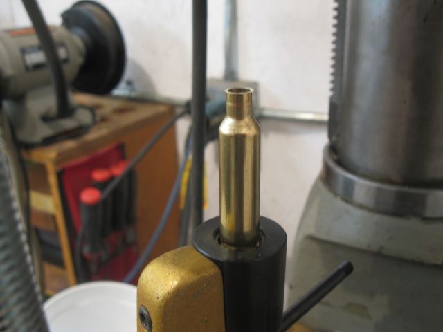

The case after trimming.

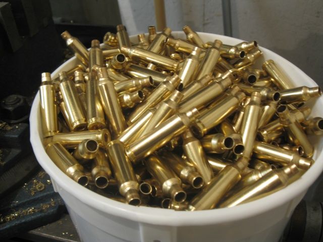

500 pieces trimmed, deburred, and ready for fireforming.

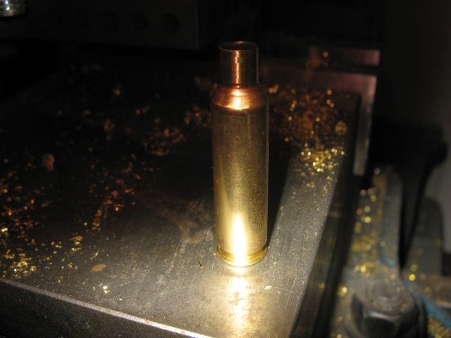

Finally, a fireformed and neck turned case.
and after die #2
