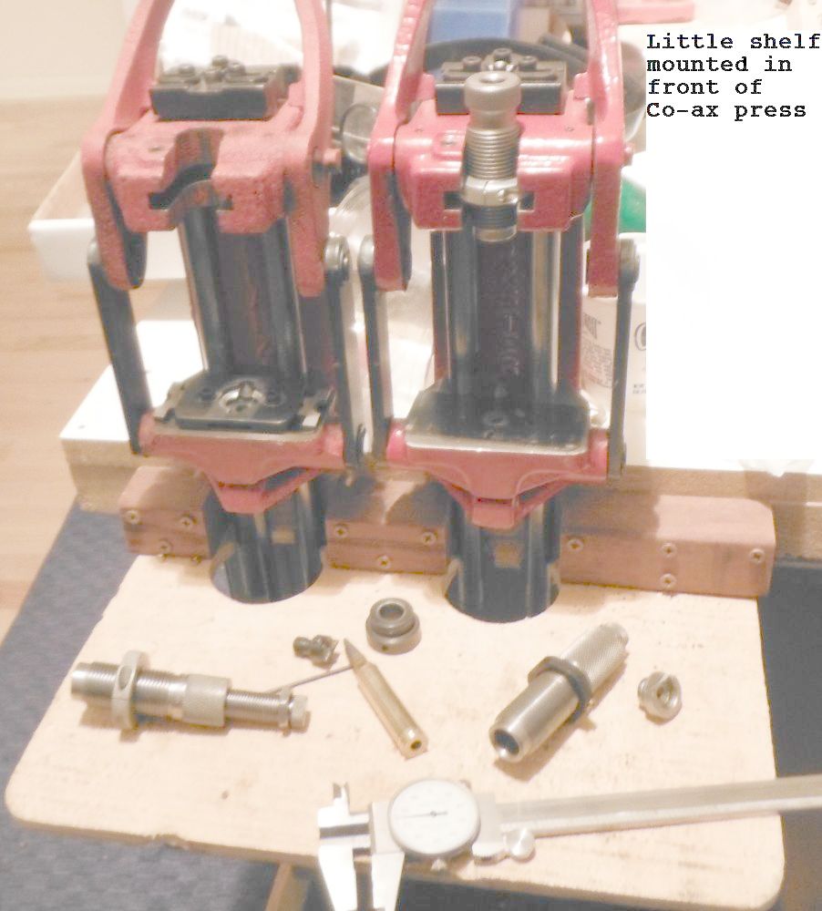

I made a little shelf that sits in front of the press.
It has a hole in it for the de capped primers.
There is usually a TV dinner plastic tray full of brass or bullets sitting on the tray.

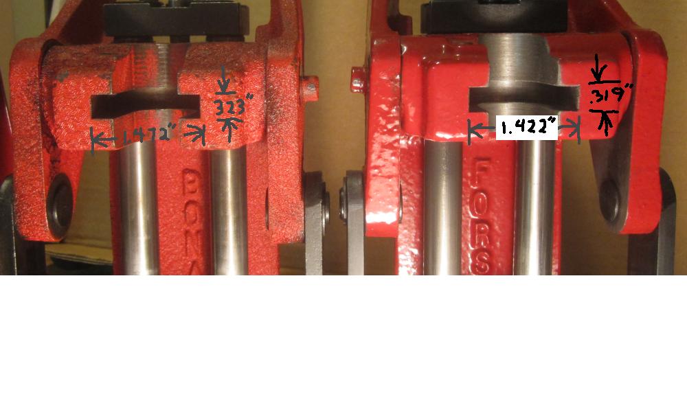

The outside of lock rings are knurled. That process upsets and does not remove metal. So the outside diameter of the lock ring increases when knurled. The variation i co-ax presses from Gopher, Bonanza, and Forster in the width of the slot of the frame castings machined over the last 50 years will not tolerate a ring of over 1.422" in diameter. If one gets a ring larger than that, the cusps of the upset must be filed off. This may need to also be in the relaxed state, depending on die thread diameter.

Clark:
Good post and great drawing. My press is a newer model and the Forster rings work fine but will definitely try the Sinclair rings. Like the fact that they are ground flat and appreciate the heads up.
