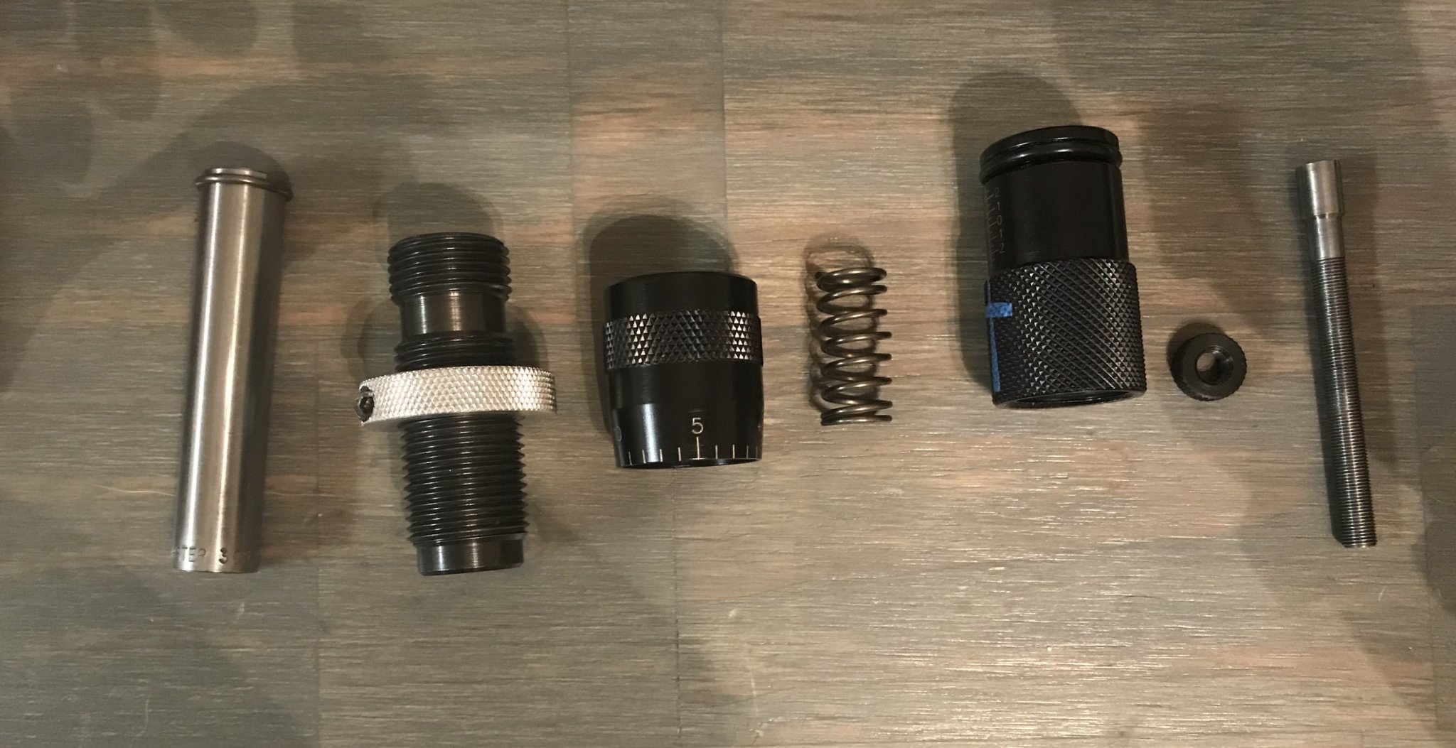

Forster Ultra Micrometer Seating Die
These are the parts I am looking at.
Sleeve, Die threat, micro body, spring, micro head, lock ring, seating stem.
Am I missing any parts?
Also, I’m now hearing a clicking noise when the bullet goes to seat and then subsequently pulled out of the case.
Days like this make me want to tear my hair out, throw my stuff out and just shoot ARs and Glocks...
BTW if it has not been mentioned, I lightly oil the exterior of the stainless slide (left) and the exterior of the seating stem. I do NOT lube the oring...

Since this thread brought up my problems with the Forster seating die I had. I decided to send the die back along with my F/L sizing die since it was gettin honed.
They called me today and said the seating stem they had given me in June 2018 was outdated and there was a new beefier “p30” stem. They said they would send it back with the new beffier stem. They confirmed again that they don’t harden the stems anymore, which they told me was actually a nitride process, because the stems would crack due to being brittle. We’ll see if this new stem holds up.

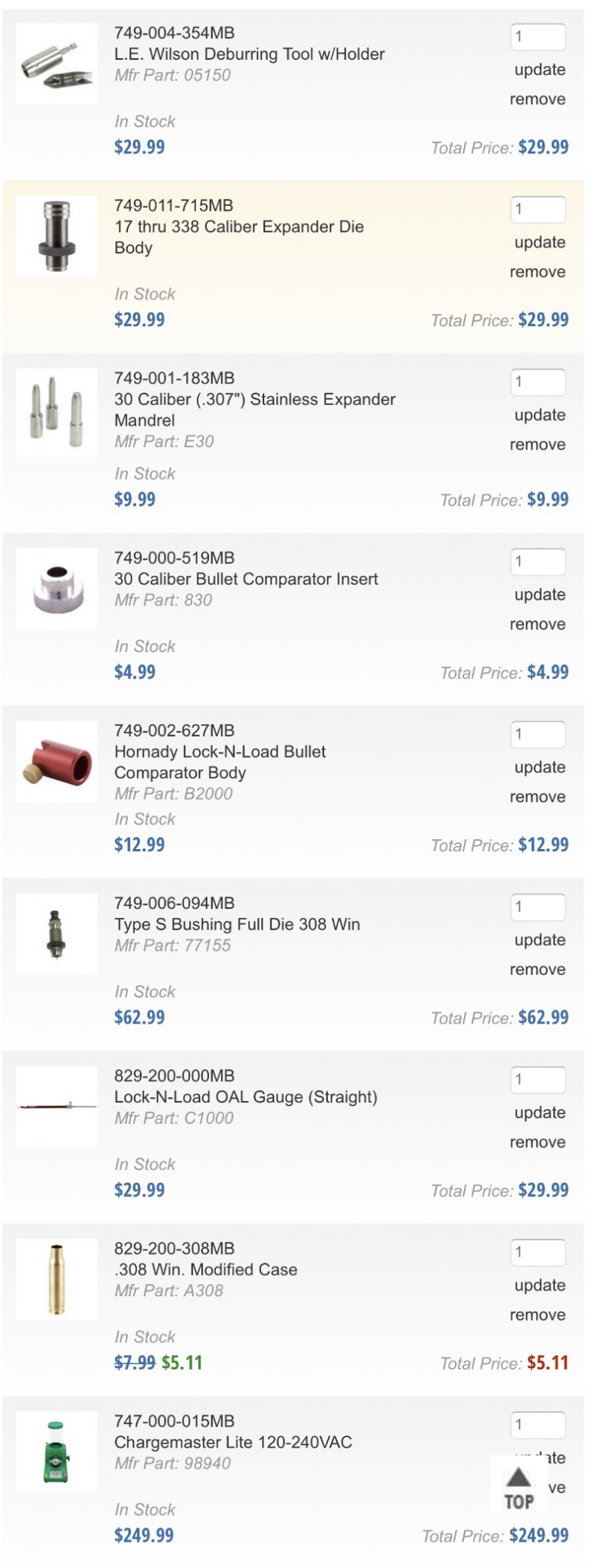

Ok, currently in my Brownells cart I have the Hornady comparator with a .30 cal insert, Sinclair mandrel die and mandrel, L.E. wilson deburring tool with a power drill holder.
If I’m going further jnto the black hole of reloading equipment, what would y’all recommend for a full length sizing die? Or can I keep using my basic Lee Precision die?
A scale is another 3-4 weeks off.
Redding type S full length set as mentioned here. Great website for reloading info.
You getting the carbide neck mandrel from Brownells? That's what I would suggest, rather than stainless.
The Hornady headspace gauge and bullet comparator kits are my most used tools. Headspace gauge to set dies up to bump shoulders desired amount, bullet comparator to get base to ojive and set up seating die. I also use Hornady OAL gauge with modified case to locate the lands. I could not be without these three tools. The only red tools I own.

Current cart on Brownells, it seems as if this investment will get me to where I need based on information from the Hide and the recommended Youtube channel called Panhandle Precision and his related website. Still need a Hornady comparator for measuring shoulder bump.
Right now, I can actually afford this. Any further suggestions as far as equipment?
Redding S bushing Full length.....dreamy

Don’t WANT to buy it, but if I’m going down the rabbit hole I might as well go all in. I would like to be where the only limitation is ME and not my equipment. Its the same reason I bought an AIAT, even if my skill level is a Ruger American...
To me, its nice to be able to grow into excellent equipment than outpacing it. “Buy once cry once” is by FAR cheaper than the other way around. I wish I would have understood that years ago.

Placed the Brownells order, along with a RCBS Chargemaster Lite. Should be here Friday. Only a few more tidbits left to aquire.

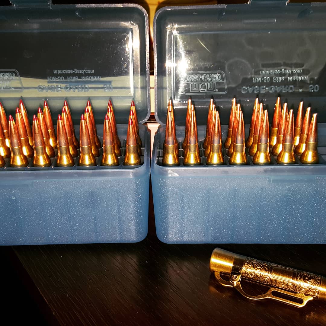

So last week was a beat down at work. Finally got them seated today. 140 ELD M and 130 RDF both seated fine. Maybe a faint ring on the ELD's that I accidentally seated too low 2.67". 41-44 grains of RL17 in a 260 (don't try that if you don't do research from some source other than me first!). No problema with seating. I may post the group results in the reloading thread tomorrow.
