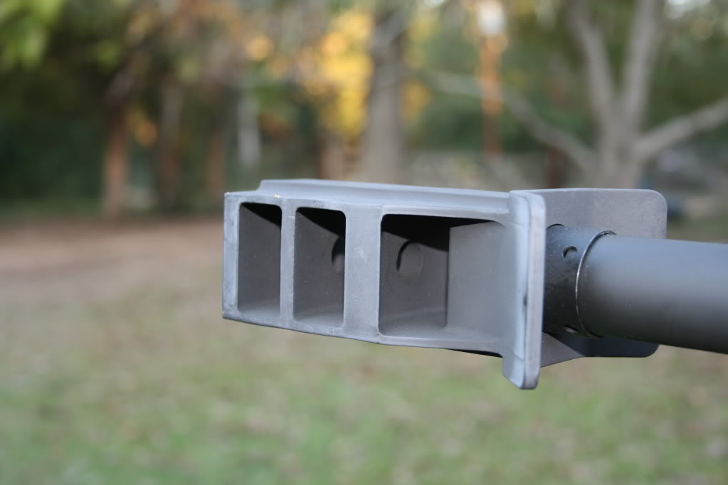

Armalite uses a deflector to direct the blast coming off the first angled port of their AR50 brake.
I see that now, thanks for the images, etc.
I think it's a rudimentary approach that could be carried a lot further along the lines I'm suggesting.
I also think that the volume of gas released by a .50BMG discharge could make the required dimensions/mass kinda huge. Such a cowl would need to be sturdy, or the blast wave might fatigue it and eventually turn it into shrapnel.
Greg
