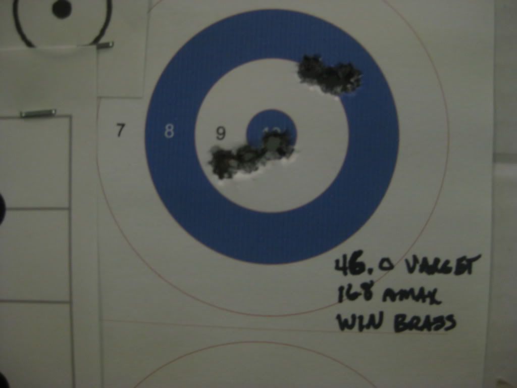

I was sure my node was going to be in there somewhere. So I started at 100 yds with my reference load of 168 AMAXs (46.0 Varget) in WIN brass to check zero. 1st three were a little high and right for about a .35" 3-shot group:
Moved the scope to adjust and shot another 5 with the same 168 AMAX/Win at the same target above, still under 1/2 MOA.. It was feeling like it was going to be a good day.

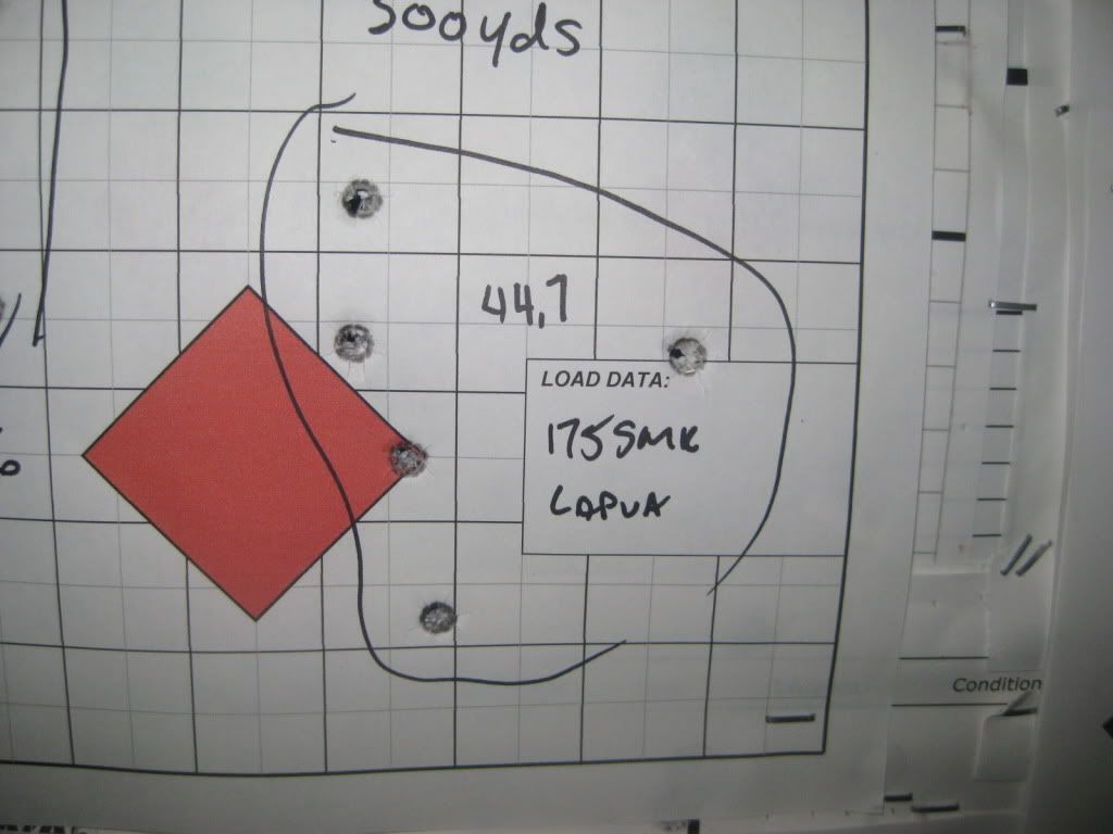

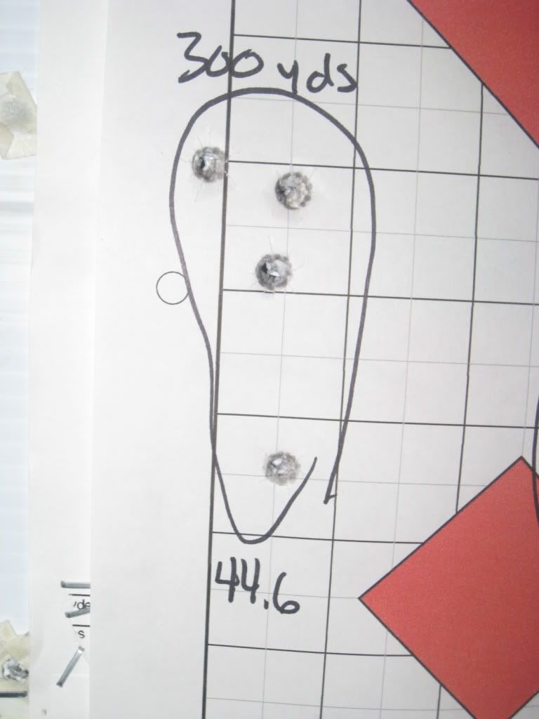

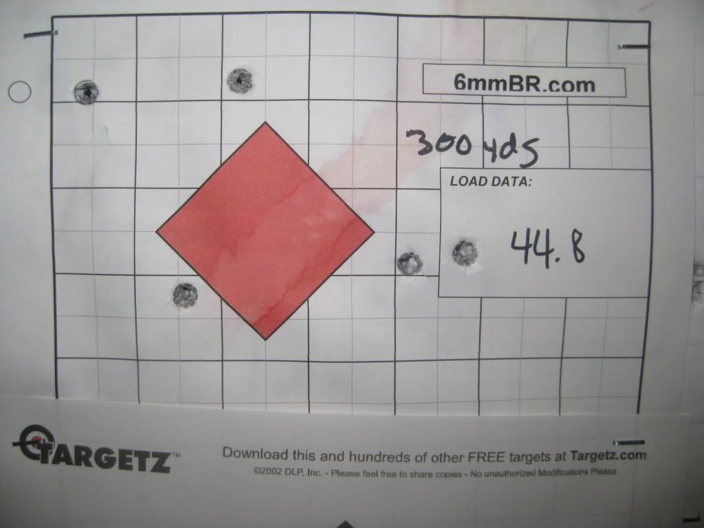

So then I moved out to 300 yds to start my load devel with the Lapua brass and say these results:

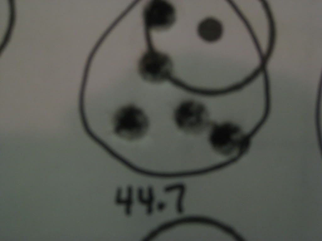

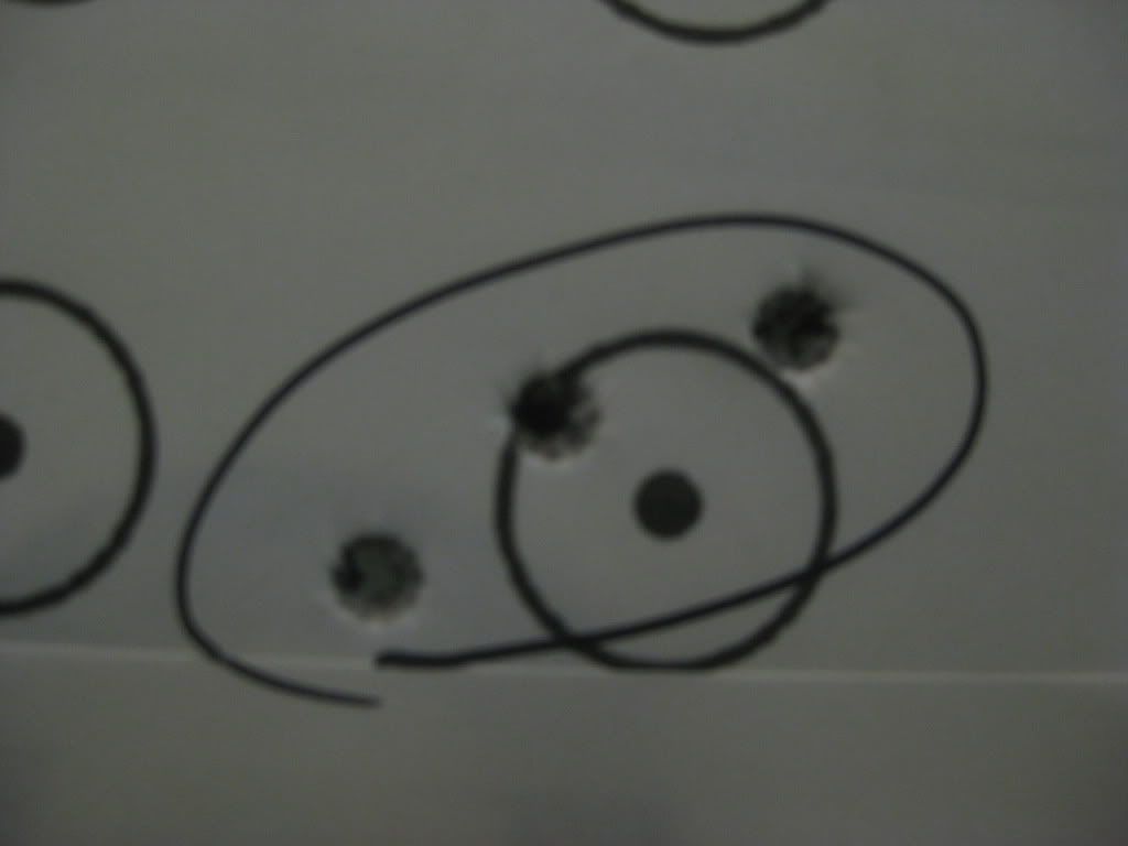

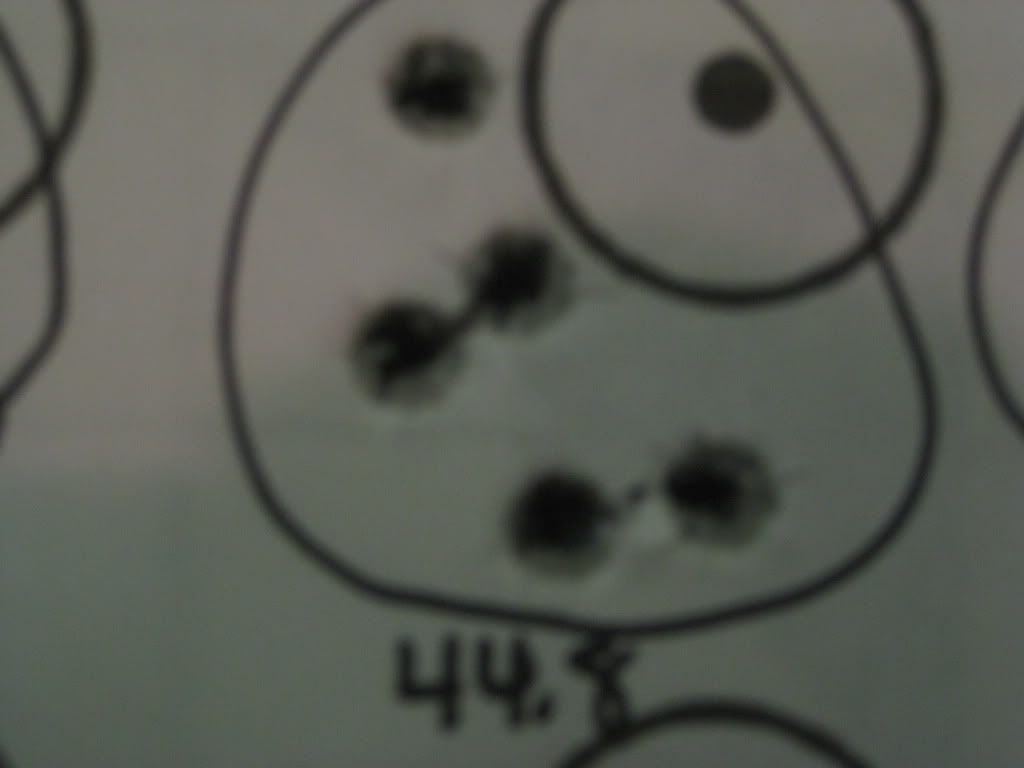

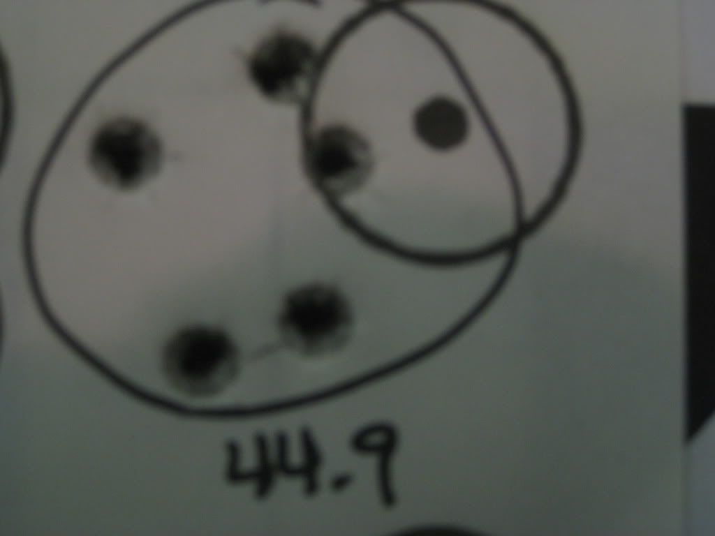

I didn’t bother shooting the 45.0 load at 300 because it was sucking so bad. The above are all greater than 1 MOA and close to 1.2. I didn’t think I was shooting that poorly, so I moved back to 100yds and had my mentor who is a MUCH better shooter than me shoot the rest of the loads over again at 100. Results are as follows:
The last pic was the 45.0 load, 3-shots each. That’s a 1 inch outer circle and I measured them all at right about 1.2" 5-shot groups.

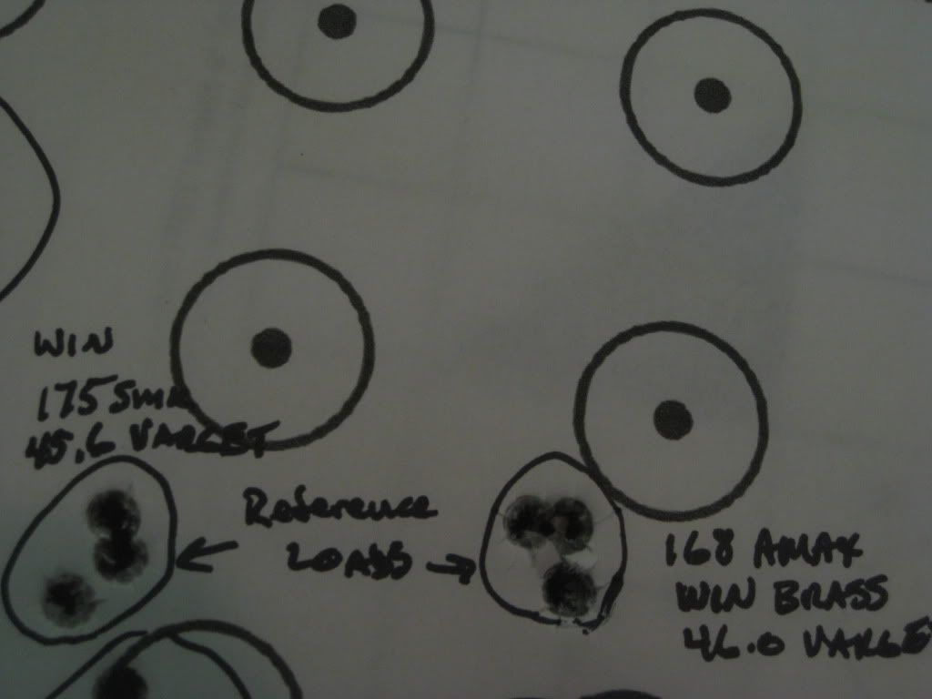

So I’m thinking holy frack, what has happened to my gun. So to test a theory – I shot the few remaining “reference Loads” in WIN brass I had left to see if they were also shooting poorly now. I had 3 left of my 168 AMAX load (46.0 Varget) and 175 SMK (45.6 Varget – both in WIN brass.
Both of those shot as expected – the 168 AMAX is .38” and the 175 SMK is .48”.
