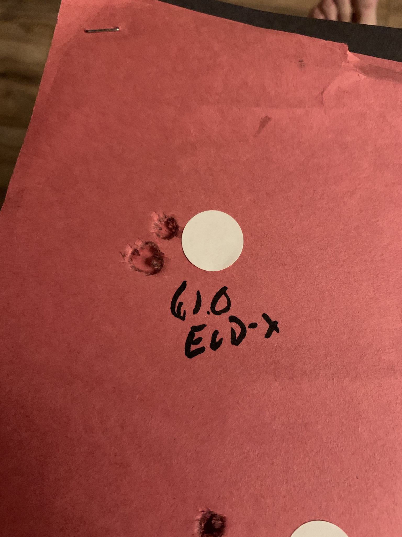

So, I took the rifle to the range yesterday. Loaded up 40 rounds with 20 200Gr LRX and 20 200Gr ELD-x. Using a proven load I went down .3grs and up .3grs to see if I got amywhere. The two lower charges shot around 1” but they grouped which is a step forward. With both bullets 61.0grs of RL 17 shoot goods the ELDs shot one group at 5/8” and one group that was awesome 1/2”ish ” I will do my normal ladder test this weekend and hopefully I have this problem fixed. Not sure but I think it was a host of little issues that added up to a shit sandwich. Either way I hop this is the end of frustrating myself with it.
Picture is 5shots
Thabks
Donald
