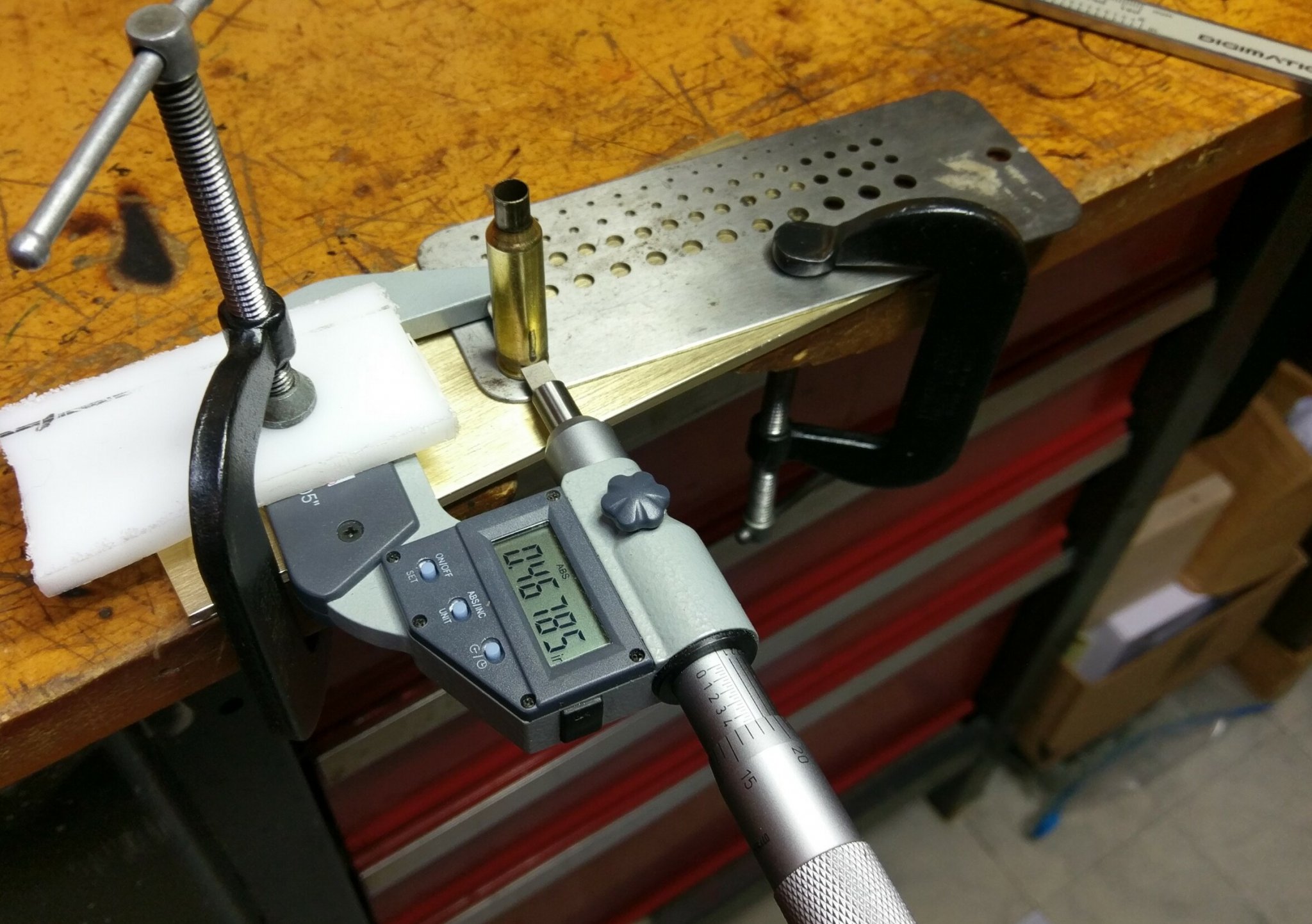

I use a full length sizing die to bump the shoulder back .003. This keeps the brass consistent from sizing to sizing but also minimizes the work being done to the brass each time it is fired and then resized. Fully resizing every time will likely cause case head separation faster then just bumping the shoulder.
Just FYI you’ll need a OAL gauge to measure the shoulder bump. Don’t FL every time just based on the manufactures instructions

This is mostly incorrect. A regular FL die will still take the case down .001-.002 down to the .2 line.
A small base die just takes it down more.
If your regular FL die does not size down to the .2 line, then your die does not match your particular brass/chamber. So, if for some reason your dies *never* size all the way down, you have been unlucky enough to never have properly matched dies.
Forster had a die customization option whereby you send them a few fire formed cases and they hone the die to more optimally fit your chamber. They can also hone your projectile seating die if you send them a few projectiles. The cost was very reasonable and it took them perhaps 2 weeks if i recall correctly.
