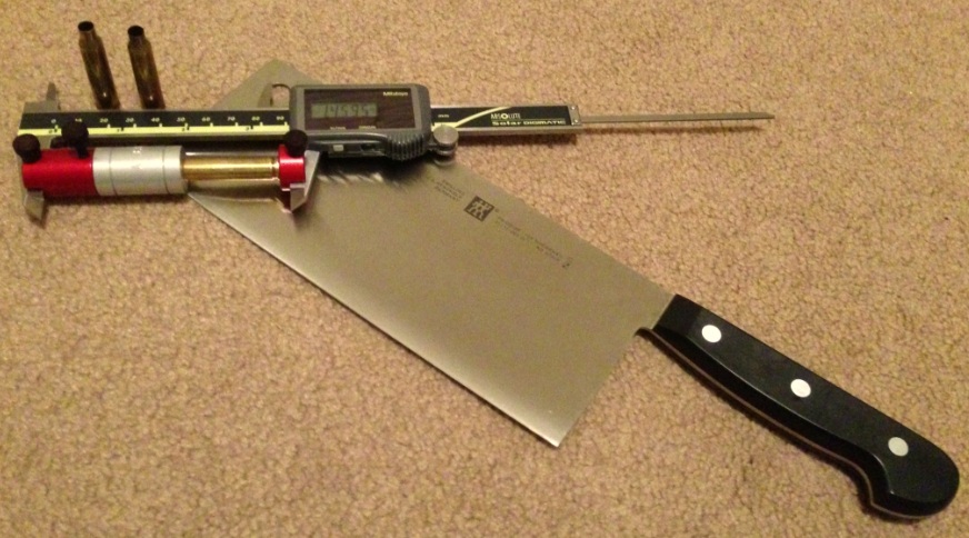

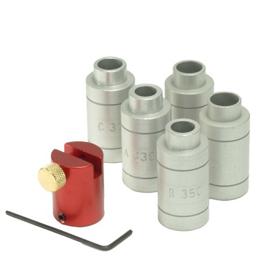

I was playing around with some measurements using the Hornady Lock-N-Load Headspace Comparator and tried sizing some 5.56x45mm NATO and .223 Remington range trash. I replaced the brass thumbscrews with plasti*... cough, cough
polymer thumbscrews to prevent gouging my fancy calipers.
36868d1398960389-full-length-sizing-brass-semiautomatic-rifles-hornady-shoulder-comparator.jpg

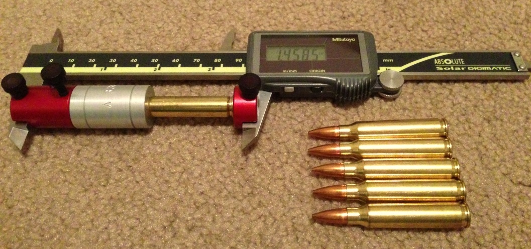

I took some baseline measurements on these rounds,
36869d1398960474-full-length-sizing-brass-semiautomatic-rifles-federal-.223-sierra-77gr.jpg
36871d1398960507-full-length-sizing-brass-semiautomatic-rifles-sig-516-headspacing-1-edited.jpg

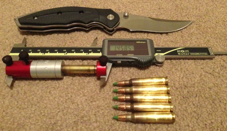

...as well as these. Please note the inclusion of the utterly irrelevant, phallic surrogate.
36870d1398960475-full-length-sizing-brass-semiautomatic-rifles-fedral-american-eagle-m855-150-rounds-edited.jpg
36872d1398960509-full-length-sizing-brass-semiautomatic-rifles-sig-516-headspacing-2-edited.jpg

Both batches were surprisingly consistent at 1.4585", even the el cheapo ammunition.

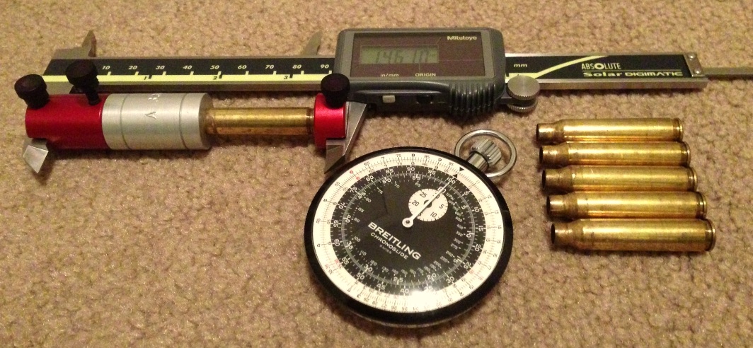

Now, measuring once - fired brass from my rifle was tricky... These casings weren't as easy to center and required some "spinning." These casings were fired with the gas system off, and were extracted manually after each shot. I'm presuming that this would be equivalent to rounds fired from a bolt - action rifle with really sloppy headspacing. Measurements were more or less consistent at 1.4610".
Please note the subconscious suggestion of an oppressive father figure. Since fancy man - jewelry is warranted and I didn't have any at hand...
...I suspect this Breitling will suffice. Look. It's a Chronoslide! Oodles of utter awesomeness!!!
36878d1398961118-full-length-sizing-brass-semiautomatic-rifles-sig-516-headspacing-3-edited.jpg

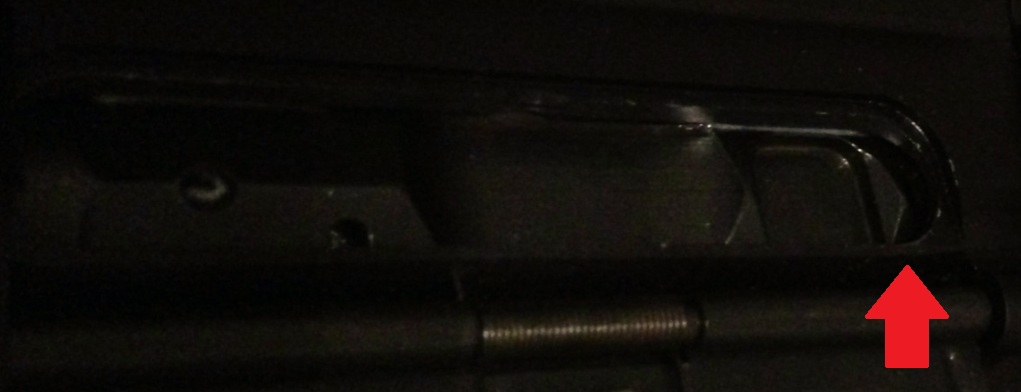

Riding the bolt gently (instead of letting it slam shut) prevented full closure with both cases (unfired FGMM, as well as resized cases).
36880d1398961124-full-length-sizing-brass-semiautomatic-rifles-sig-516-headspacing-5-edited.jpg
