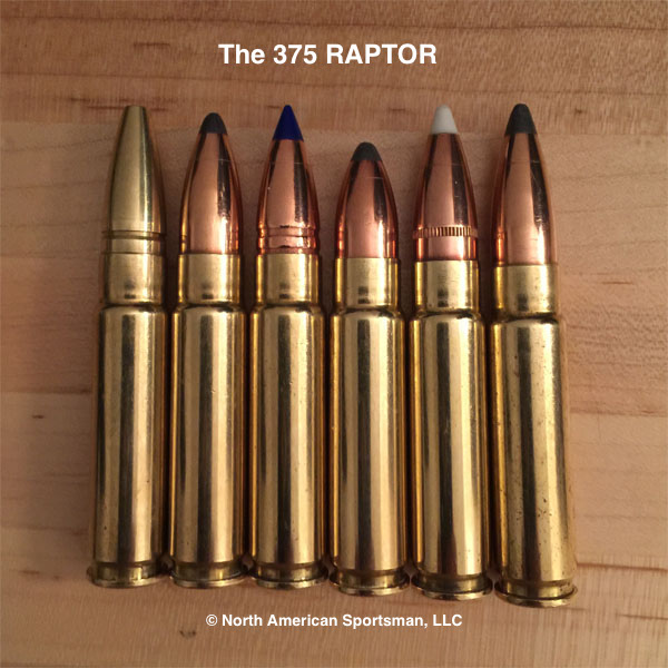

May I introduce you to the 375 raptor? its a wildcat based off the .308 win, so everything but the barrel is still standard .308, but it has some crazy nice properties. It was originally created as a short action option for hunting african dangerous game because of the legal requirements there for .375 cal and up.
its expressly designed for shorter barrel lengths too. Maker Bullets makes a 400gr copper monolithic for the caliber for subsonic use.
The brass isn’t standard necked up 308 brass, is it? Don’t you have to neck it up in two or three steps, and then cut/trim a fair amount off of the end of the brass?

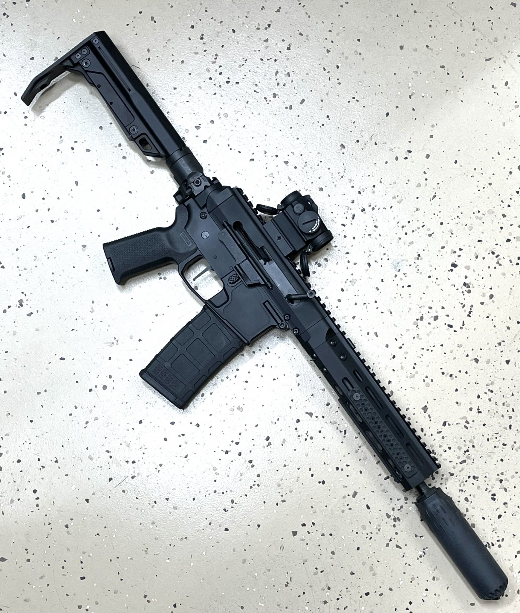

I'm really enjoying making more specialized builds for my 5.56 guns. Started with a couple 16" guns (Carbine, Mid, Dissy), then did an 18", 11.5" and so on...
Now I'm working on 13.9" (lightweight) and 14.7" (Recce) builds concurrently, with different optics, accessories, and furniture to differentiate them. I expect they will replace my 16" guns as my go-to options for training and coyote hunting. I also have a 7.5" in the works for the hell of it. If it ends up fitting in my pack how I hope it will, I'll probably morph it into a .300 BLK.
there are options to form it from .308 or other cases, it doesn't necessarily need to be fireformed or work the brass too much if you have the right tools

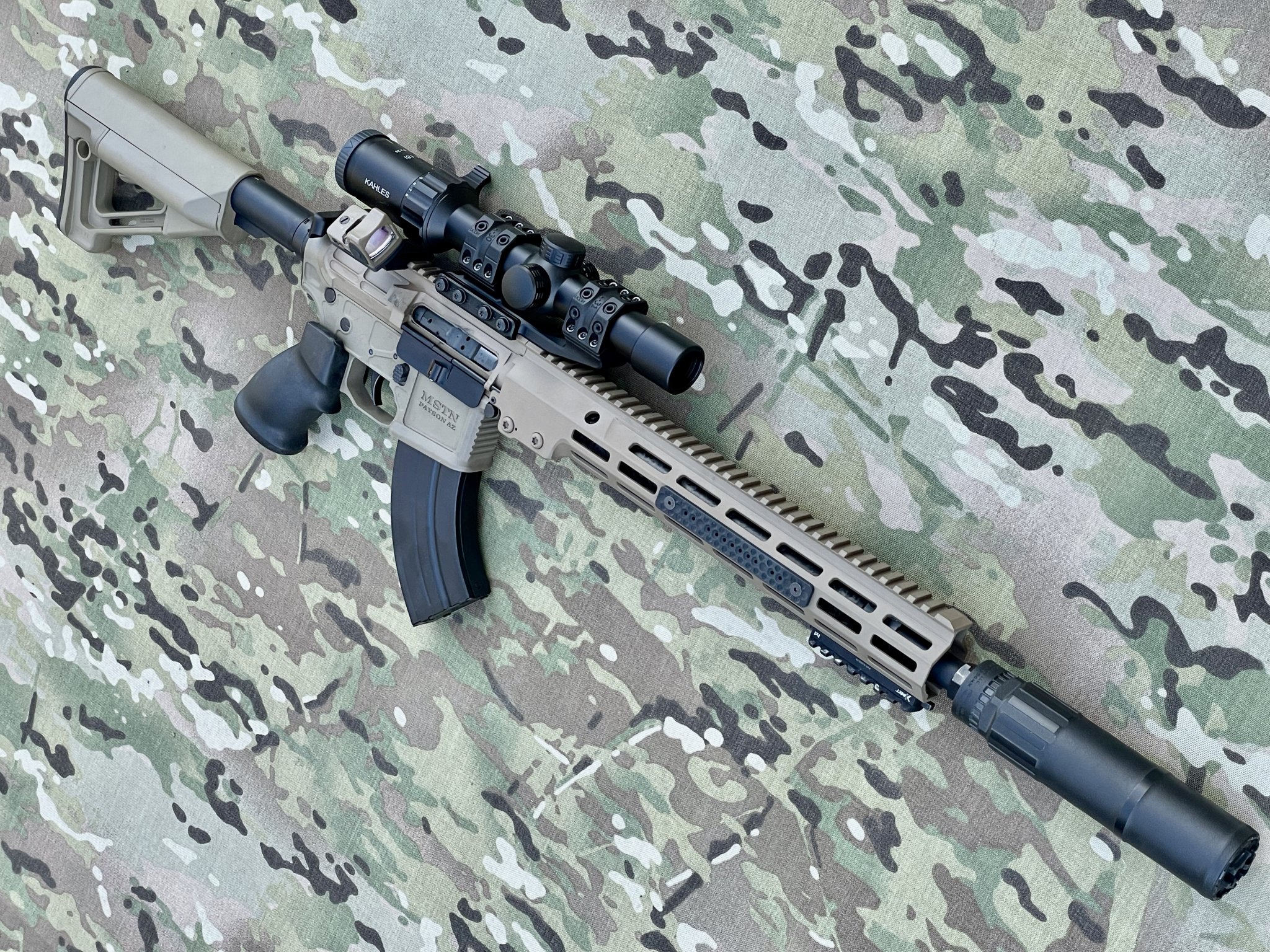

I didn't want another 5.56/Wylde, 300BO, 6.5G, 6ARC, or .308 build and assembled a 7.62x39 build with parts I had around and a POF 16.5" barrel when they closed them out. With Duramags, enhanced bolt/firing pin, and a Larue MBT (with extra power springs) it has been flawless. No adjustable gas block was needed. This was my least expensive AR to assemble and it gets the most attention at the range outside of my SBRs.

I'm building off that same barrel. Talk to me about the rest of the build. How's the accuracy?

It’s a basic budget build for a budget round. I didn’t want a high end build for this so I went cheap with a generic Cero Forge Upper/Anderson lower/UTG Forerunner (Titanium barrel nut) handguard. Gas block is a non-adjustable steel (.750 set screw type) from Luth-AR. I know some folks say you need an adjustable gas block for the round in an AR. I bought one and didn’t end up needing it for this build.
For reliability with steel case/comm bloc surplus you want extra power hammer spring (https://www.blackriflearms.com/Enhanced-Power-Hammer-Spring_p_685.html) . That means no cassette triggers. I use a Larue MBT-2S and it sets off every time with the EP spring.
Use an enhanced firing pin that is a little longer to set off comm bloc/steel case.
BRA (https://www.blackriflearms.com/7.62x39BoltandEnhancedFiringPinCombo) and RTB (https://www.righttobear.com/7-62x39-ar15-bolt-completion-kit-enhanced-firing-762ekit/) sell them. I use the RTB bolt/pin and no issue. I keep a BRA pin as a backup if one breaks.
I’m using a Crimson Trace Series 3 1-5x24 FFP on top and accuracy is limited by the ammo I shoot (cheap stuff), so it’s been 1.5-2 moa at 100 yards with just blasting. I have no doubt the barrel is capable of better so I’ve recently picked up components to start reloading the caliber. I’d sworn I wouldn’t add another caliber to reload, but the POF barrel really impressed me even with crap ammo. I’ve recently picked up some brass cased ammo to see if I can get more out of it and I’ll use those empties to reload.
Magazines are another key component. The Duramag 28 and 10 rounders are all I use.
