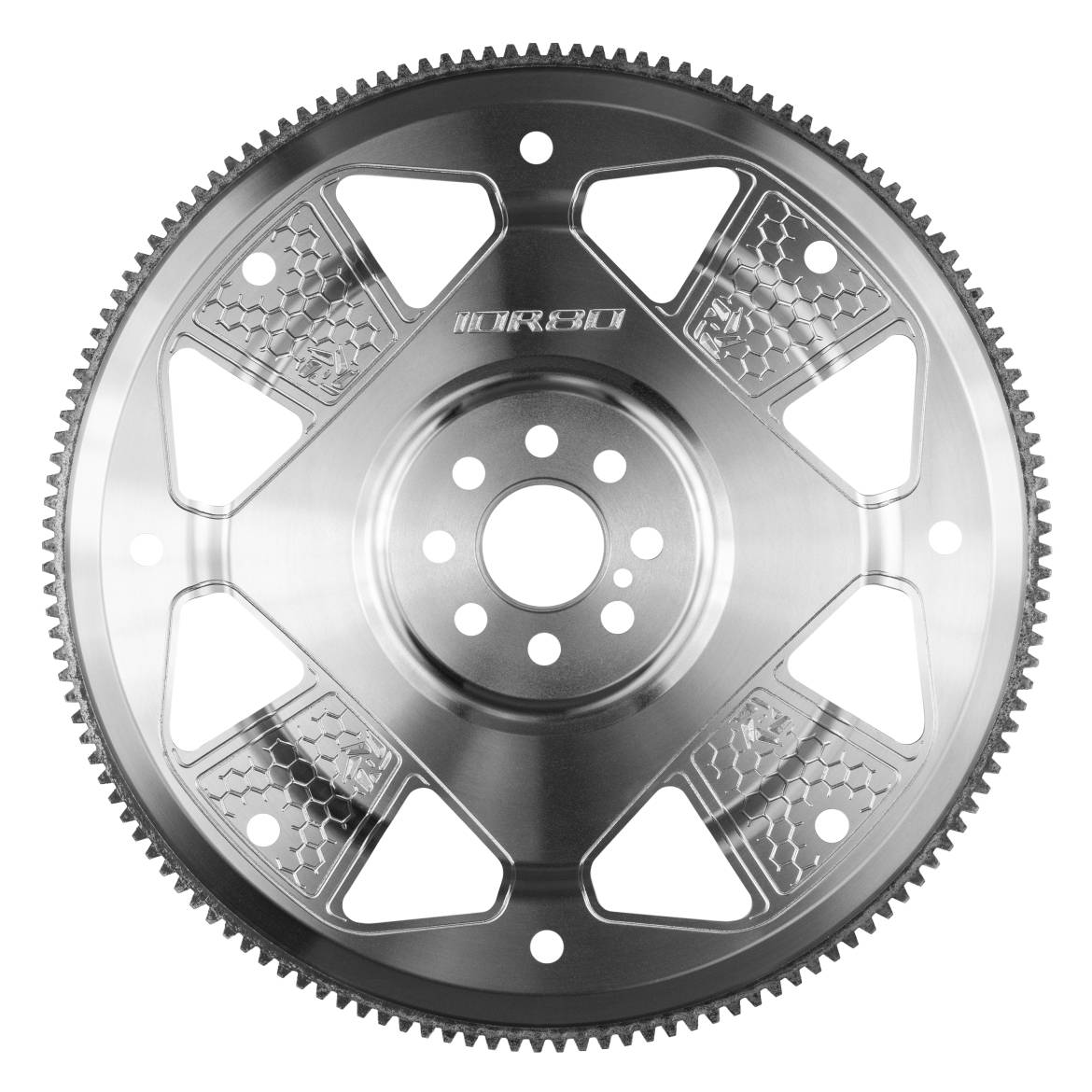

Shipping him my billet flexplate too, so he can balance the entire rotating assembly before building up the short block.

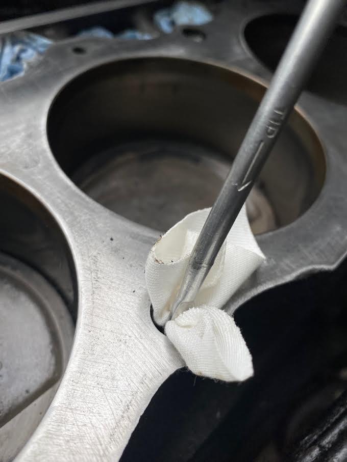

Some old dude a long time ago told me the best thing to clean cylinder bores, gun bore cleaner like 99 bench rest or such.

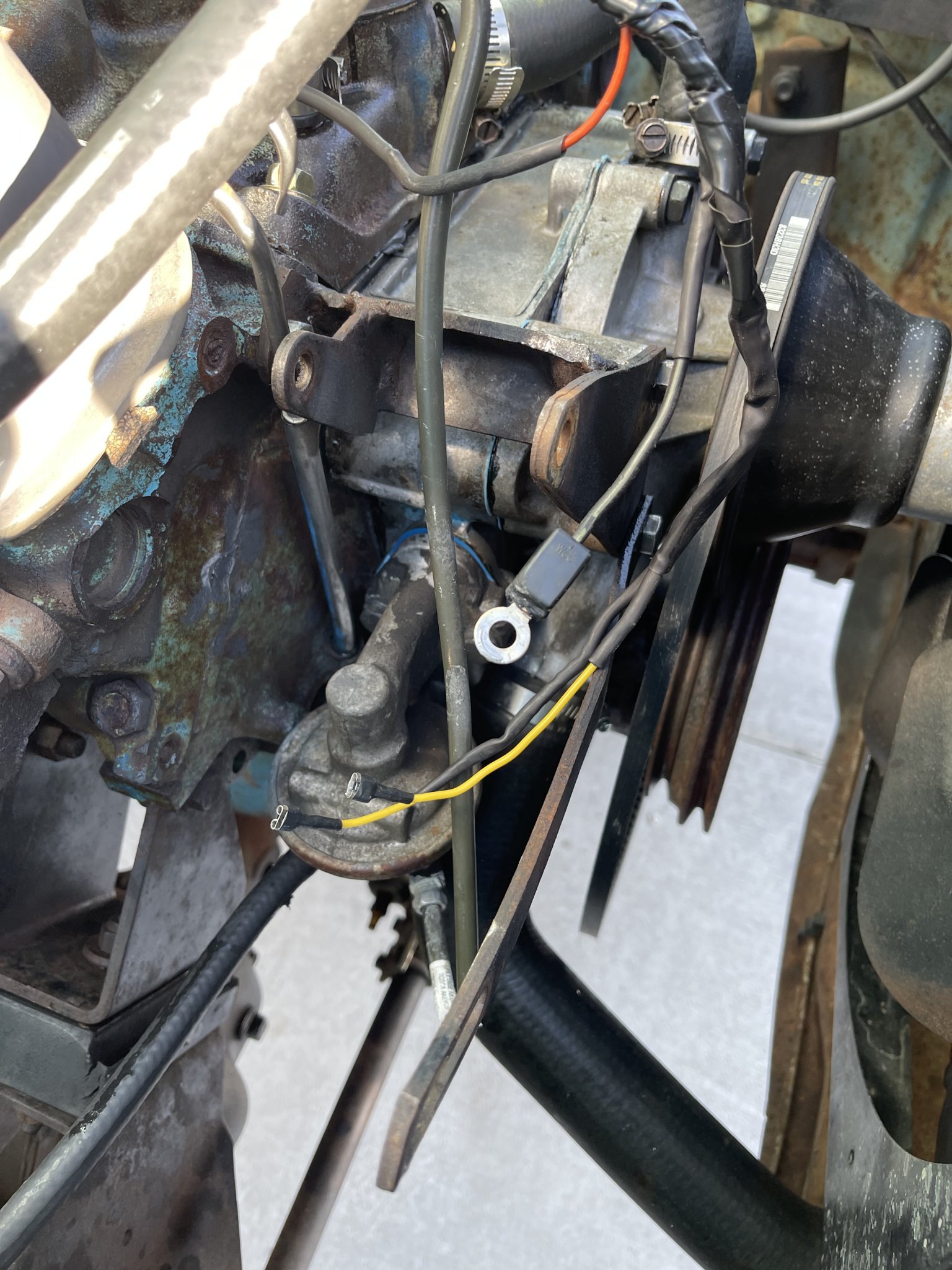

Oh for the days of yesteryear when I could wire up an engine in < 30 minutes. Here’s what mine looked like a few weeks ago when I got the cab off:
Two air and water-cooled turbos, plus all the associated intercooler/intake plumbing and engine management bullshit makes for a lot of peripherals to go through before pulling the motor!
Engine block itself is only like 18”x18”x24” … a lot of crap around it really fills up the engine bay though, LoL.

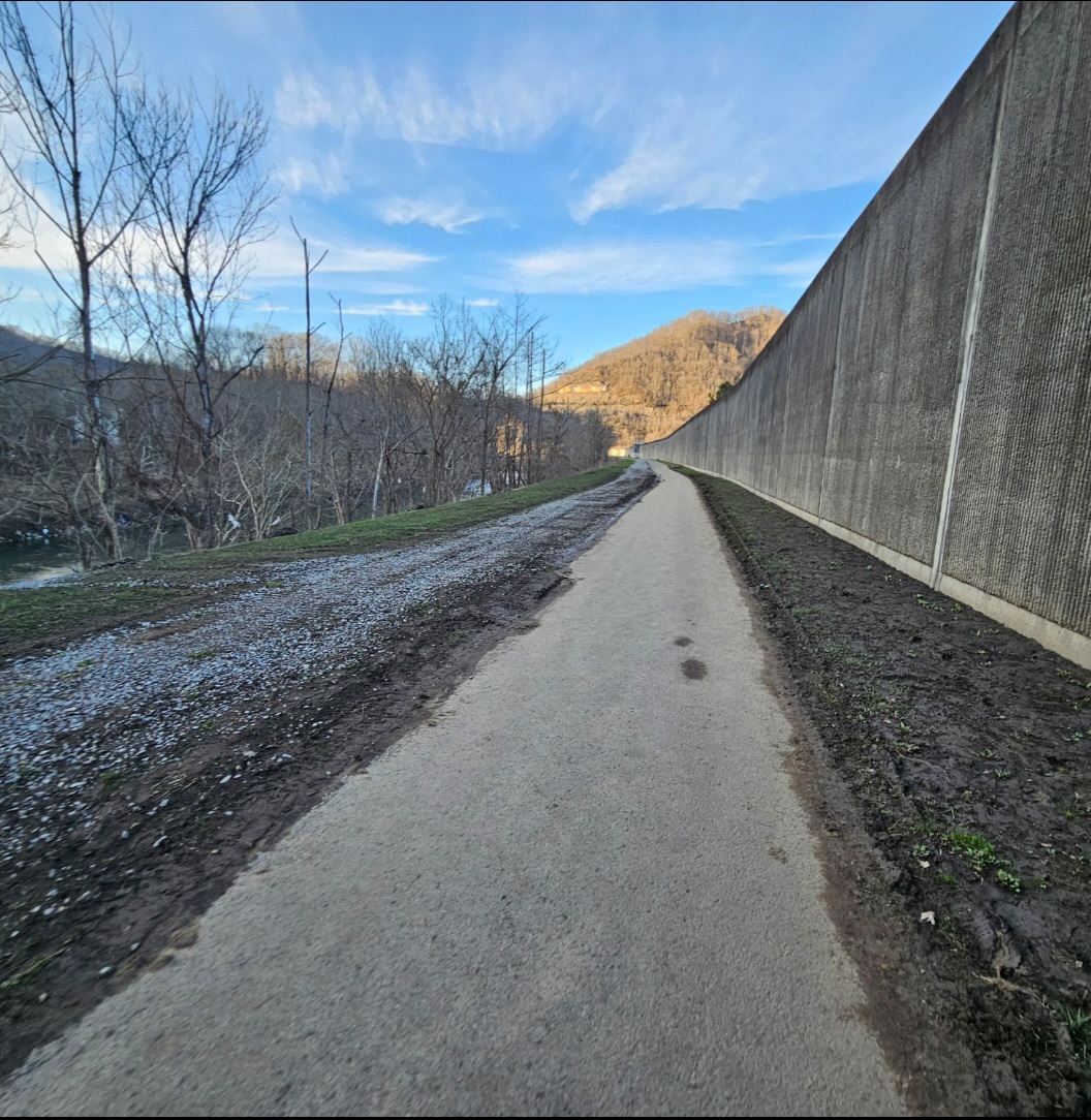

Actually, the course is around a flood wall.

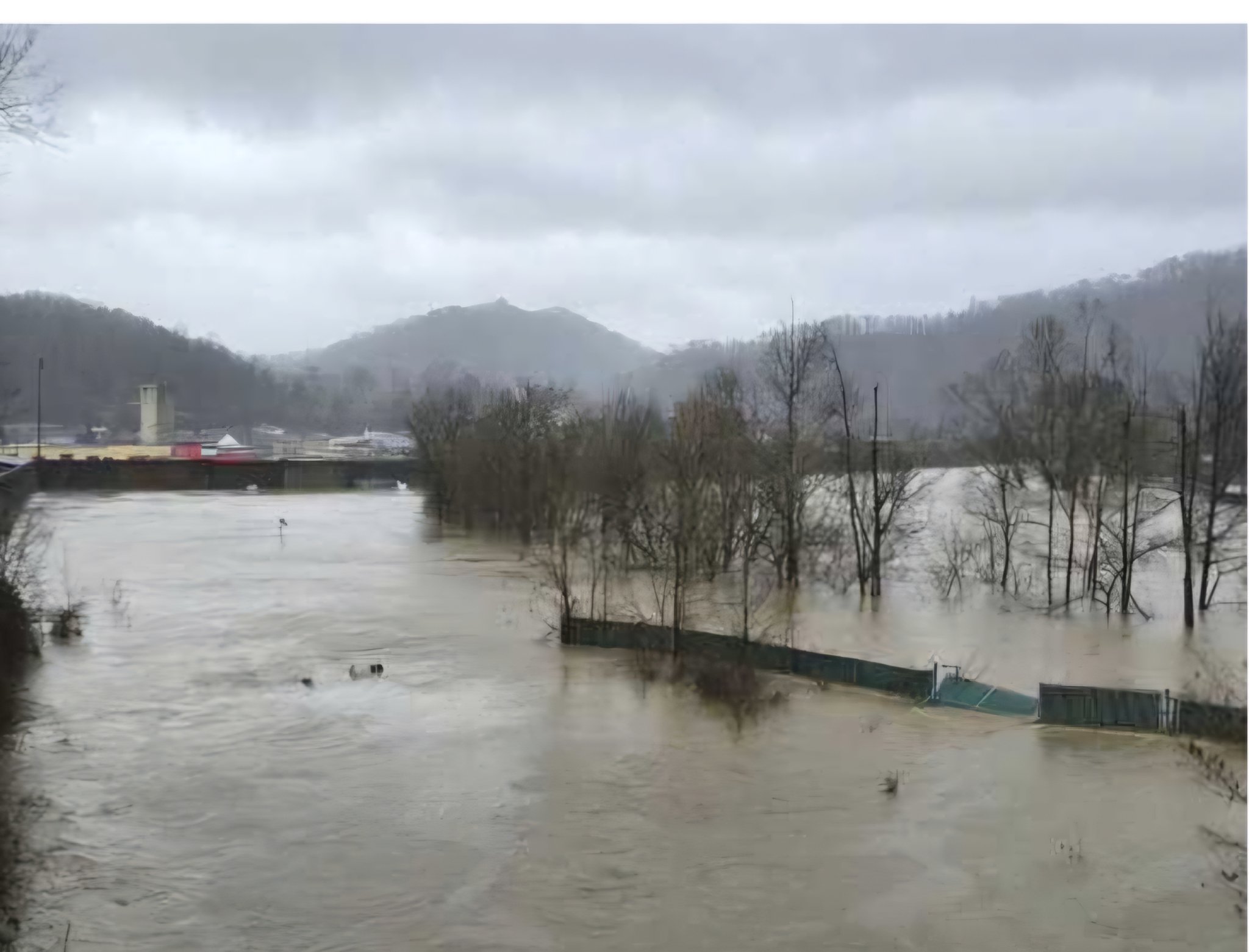

Then this was the same area about three weeks ago. The "wall" is on the middle left in the second pic.
I looked at a highway project near there years ago. If I remember correctly, the McCoy family cemetery (Hatfield & McCoys) is on a hillside just up a side road near there.
