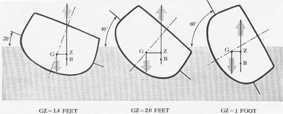

There's no good reason why it should have healed 50* and kept going unless it was top heavy.

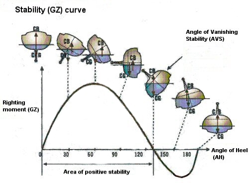

Lower figure illustrates how a sailboat can go to 130* and still come back upright.
You are confusing dynamic stability with static stability. And sailboat stability with motor vessels. Most of the ships I've worked on the GZ goes negative at around 60°.
If the vessel had negative static stability from launch (i.e. top heavy, KG>BG), it would have fallen over within seconds after leaving the blocks. It did not. What we see is a gradual increasing list to port; i.e. g moving to port and aft. As it was lightships on launch, it probably did not have much reserve stability to start with.
