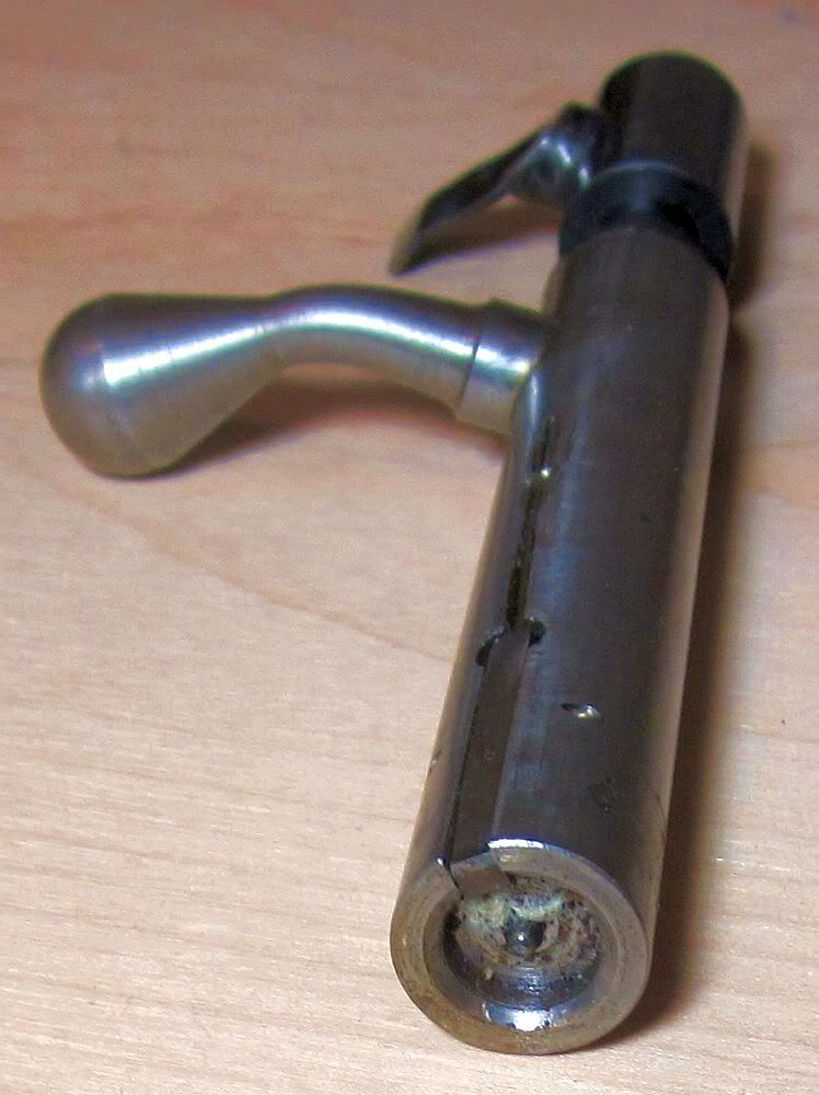

My 222 does not have the firing pin fit to do this test*, but the .223 uses the same 1950 222 Rem case head design.
This 223 test from left to right in Quickload pressure prediction:
0 kpsi brass ok
69 kpsi brass ok
80kpsi brass ok
92kpsi brass .0005" extractor groove expansion
106kpsi brass .0030" extractor groove expansion
*My 222 is a BRNO LUX and is based on a 22 rimfire action. It only locks up on the .625" bolt's .39" handle base into the .15" thick wall of the tube receiver. The locking surface is a .15" long on a .15" flat spot on a .39" diameter circle = .0225 sq in.
The inside of a .222 case is .3" diameter = .071 sq in.
At 70kpsi proof pressure, the bolt handle base could see 5,000 pounds thrust. That would be 222kpsi compression on the steel.
This sure scratches like 120 ksi 4140 steel. That worries me.
