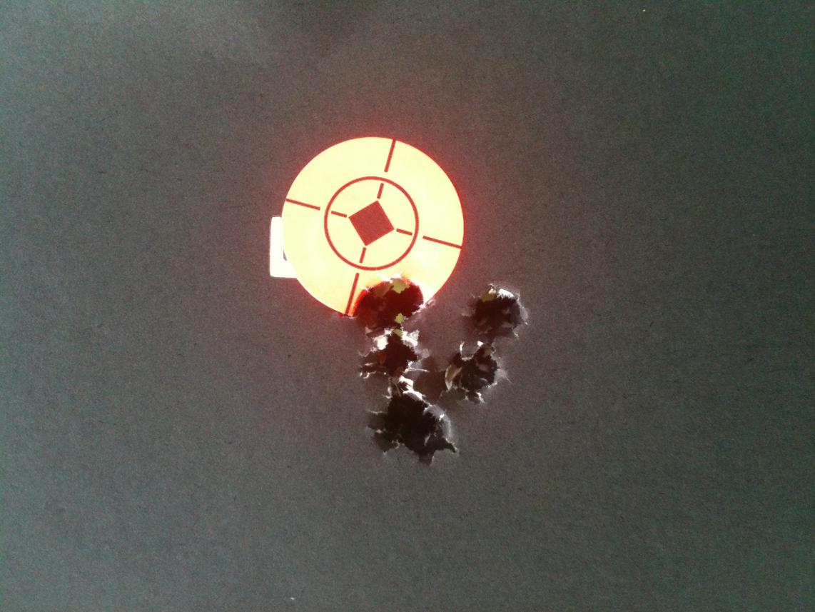

went out yesterday to tweak and test a few loads. It was drizzly rain all day, targets didnt look too impressive cause the paper was splattering the holes due to being soggy. It wasnt till I got home and took the paper targets off that the cardboard revieled a better story.
I was tinkering with 2 seperate powder charges and sub loads tinkering seating depths. Was at 100 yards, just for chrony and tinkering purposes. This combo here looks promising. there are 10 rounds in this cluster
Load-
162 AMAX seated to 2.380 ogive (note .380 on target)(lands start at 2.388 in my gun)
58.8 grains H4831SC 10 rounds running 2,900 fps even
WIN Brass
FGMM primer
ignore the five squirrely rounds on the leftern side, this was first time I ever shot a gun so get off me

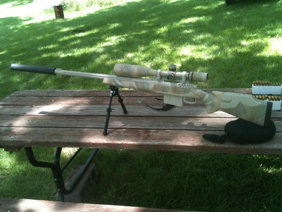

VJ, Have just finished the almost exact same rifle.
700 LA trued
mike rock barrel, 5 heavy flutes,5R, 8.7 twist, 26in.,APA brake
surgeon BM
bolt knob and bolt fluting by Kamfield customs
Timney straight trigger
Manners T3
Nightforce rail
IOR 3.5x18x42 scope (great scope,have four of them)
Badger bipod rail and atlas bipod
I have just finished this rifle and is not painted yet. I worked with RL-17. Settled on a load of 52.5 for a 5 shot average of 3011fps. Went to 54.5 at 3148fps before it started to get sticky. COAL is 3.165 with 162 A Max with custom reamer set up for the 162 in a long action. Did not have time to try other powders.
Returned from New Mexico Tuesday where I was able to shoot my antelope at 560yds with a first shot kill.
I am really impressed with this setup. Recoils like a 243 at most.
Going to spend some time with other powders, interested in trying Hybrid 100.
Holler at me and we'll compare notes, Javy

Here are some pics. My camera tends to show a bit of a redish pinkish hue when near those bricks, but that is an anomoly. I will try to get some pics in a different setting soon, but this should suffice to give an idea of what it looks like. Everything done in cerakote.
theBoneMaker
