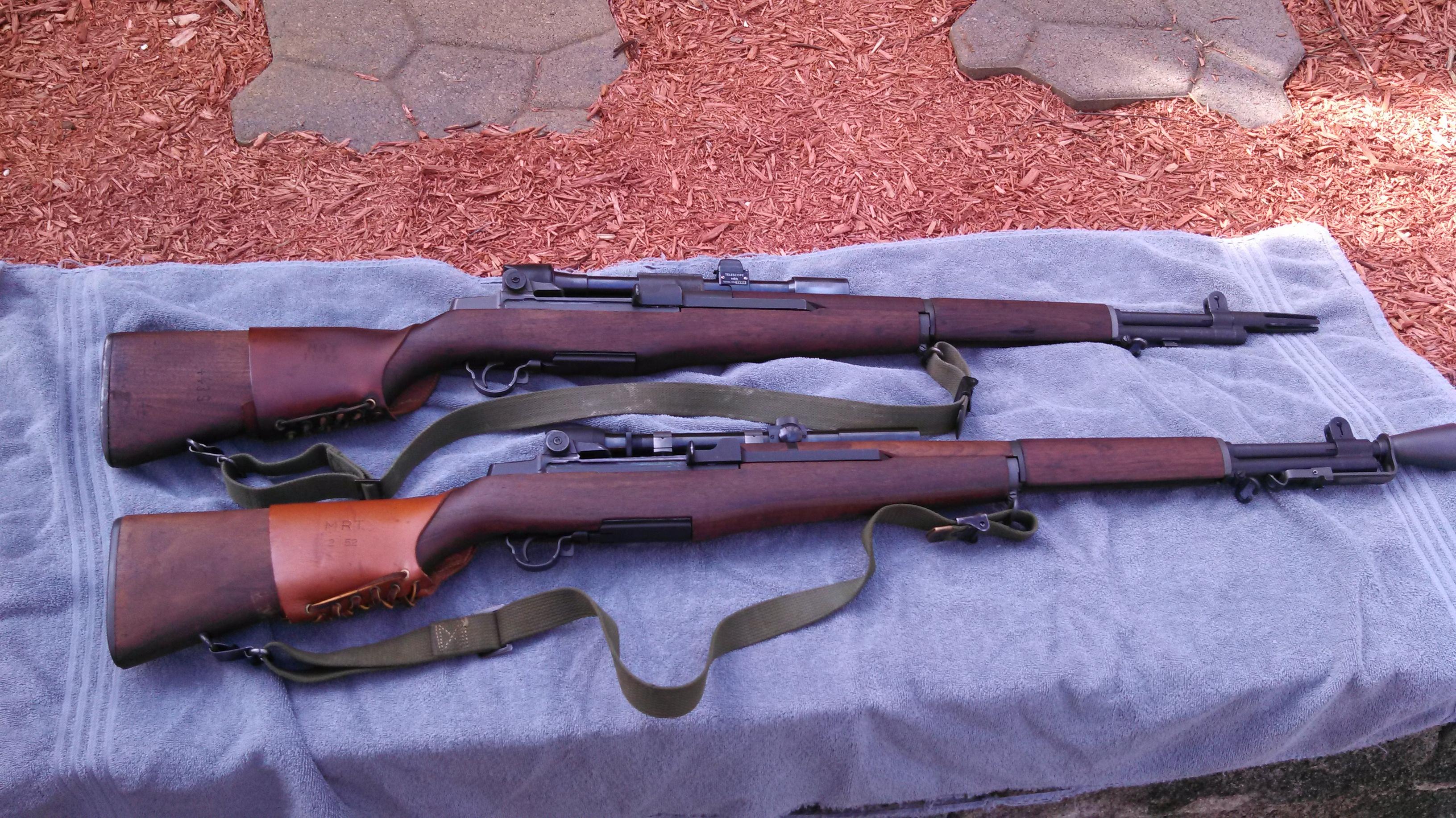

Twins
The D is 100% original. Stock is a SA/RA, GI T37, GI mount, pristine GI M84, GI cheek pad. Shoots "lights out" for its type - sub 2 MOA (best 5 shot is 1 MOA) from the bench.
The C is has a repro scope and upper mount. Lower mount is numbered to the rifle. I needed to "play" with this one to improve accurracy. Re-mounted the gas cylinder on the barrel and replaced the gas lock because the threaded area looked a bit reemed out and was not providing even tension against the the cylinder. Created a little play between the gas cylinder and the front hand guard (way too tight originally). Lastly, removed a little wood in some "strategic" places. Shoots much better now, but not quite up to the D's standard. Sub 2.5 MOA with handloads, but it has also fired a 1 MOA five shot group.
I need to shoot the C more to get a good opinion regarding accuracy. I do not use the M2 flash hider for shooting. It's just for display. I have tested it both ways. There is a dramatic point of impact shift and accuracy is impacted to a degree; even when on very tight. I guess this is consistant with military testing.
The D mount is more sturdy in my opinion; fewer parts that can loosen. I'm not confident regarding the repro scopes either.
This C has probably been rebuilt twice - once by the U.S. and once by the Greeks. Still a rare piece of history.
