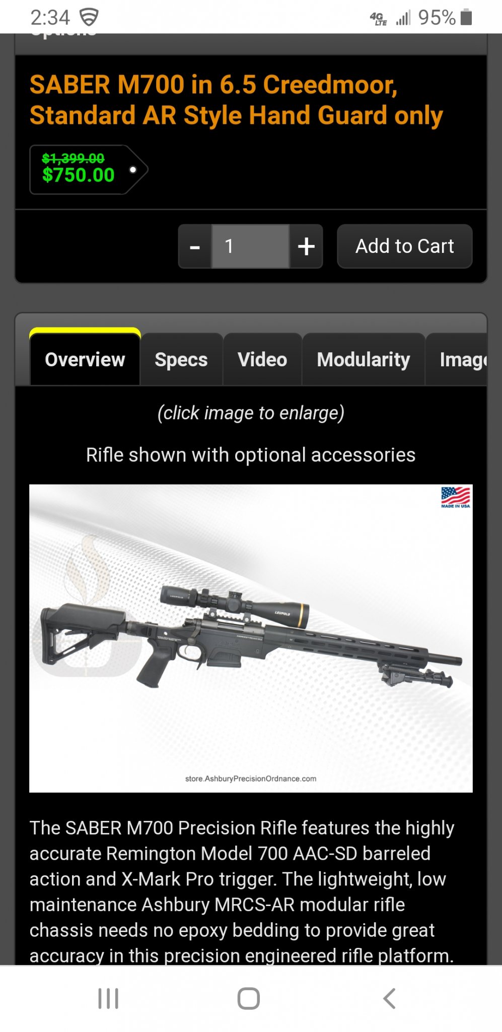

Ashbury is selling a rifle and stock for $750 as of today, use the other 750 and put it towards a Bushnell DMR2 from Cameraland NY those are going for $1k and that's a lot of scope for $1k.
Reactions: spife7980
I’m familiar with cameralandny, I actually recently picked up a Bushnell LRTSi from, so I’m good on glass for now. That seems like a heck of a deal on the rifle though!

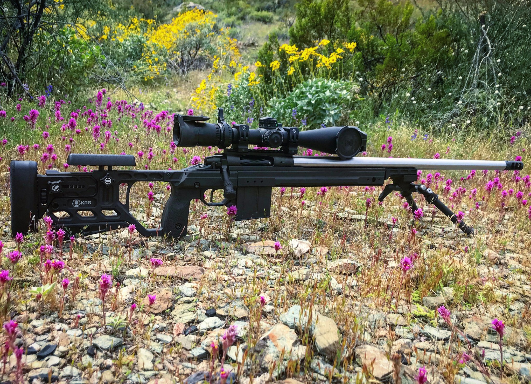

I hate to resurrect an old thread, but I wanted to thank everyone who offered up their advice and assistance, and wanted to show what I ended up doing. I went with a fully blueprinted Rem 700 action and a 24” Bartlein Heavy Palma barrel in 6.5 Creedmoor from Deep South Tactical. It’s sitting in a Grayboe Ridgeback stock, Timney Calvin Elite, Seekins base and rings, PVA brake, Bushnell LRTSi 3-12, and a Harris brms. It’s all zeroed, chrono’d, and doped for my first local prs match next weekend! Thanks again everyone!
Looks like a good starting rig, now go out and wear it out. Start with your local club matches and have fun.
Reactions: SonoranPrecision
Nice looking rig. Have fun with it.
For those of you who were interested in how things would evolve, here you go.
TL3
Proof Research 6.5cm m24 contour
Triggertech Special
KRG whiskey 3 comp chassis
Vortex razor AMG 6-24x50
ARC M10 rings
Atlas CAL
PVA jet blast brake
Nice. That will do the trick. Did you have the barrel spun up or is it a prefit?
I decided to go the prefit route and see how it goes. I figured that was one of the biggest advantages that action.
I go pretty much exclusively prefit because I’m impatient and hate waiting for barrels. Where’d you get that one? I thought proof only had slim profiles? Or is it a smith prefit?
I picked it up from Altus. They were down to just 26” m24/m40 profile in 6.5cm when I purchased the action, so I figured that would do the trick.
I’m hoping to have it serve double duty as an elk rifle by having a magnum bolt head and a 22” carbon barrel in 7saum or the like. Then swap out the aluminum hand guard for a polymer one and remove the spigot. That should drop the weight down to sub 10lbs.
