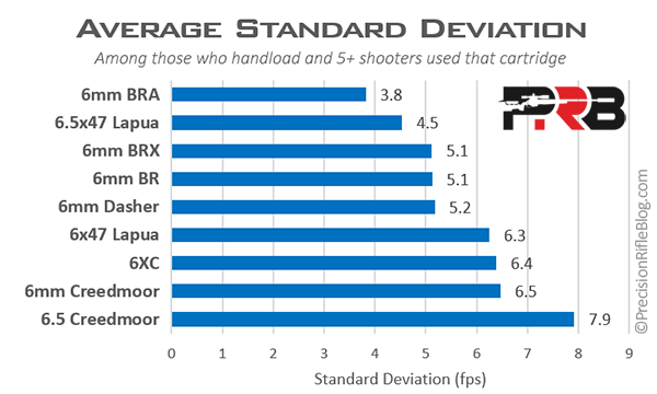

Here's a couple articles that the OP should probably take a good look at:
Addendum: Here's more info about other cartridges for perspective . . .
I soooo agree about SD on a 300 WM. A 6 SD and 20 ES is pretty darn good, though might be able to get the ES's into the teen consistently. But as you say, there's a point of diminishing returns.
I'm glad you quoted these two articles. I was going to link to the first one, but got distracted, then lazy :)
Thank you for these links. I was comparing data from the 6.5 crowd and saw how low their SD is and wanted to mirror that in the 300WM.
