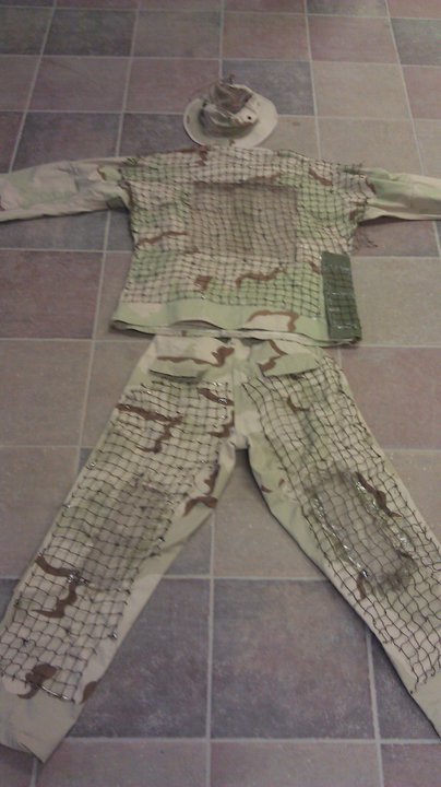

Home build bro. Purchase a cheap BDU shirt and pants from your nearest surplus store, some camo net base netting from either the surplus store again, a hardware or sewing supplies store.
You could easily keep the base under $50
That and as much and many sandbags, burlap tape etc as you can get. Test and adjust.
Contrary to what you see most of the time on the internet with all the ghillie being all burlap and jute. Most of the time the Burlap and jute is just used to tie in veg that is appropriate for the area.
Learn to do basic sewing with needle and nylon thread or even unwaxed floss. The Ghillie base doesn't have to be complex. It's just a base for you to add local vegetation to blend in. For a typical military style ghillie, you would take canvas and sew it to the front on the knee and chest area. Then the back of the blouse and trousers get a empty paracord mesh. Sometimes if your planning on being in a hot area, the back and top of the cover get cut out and replaced with a fine mesh for extra vent.

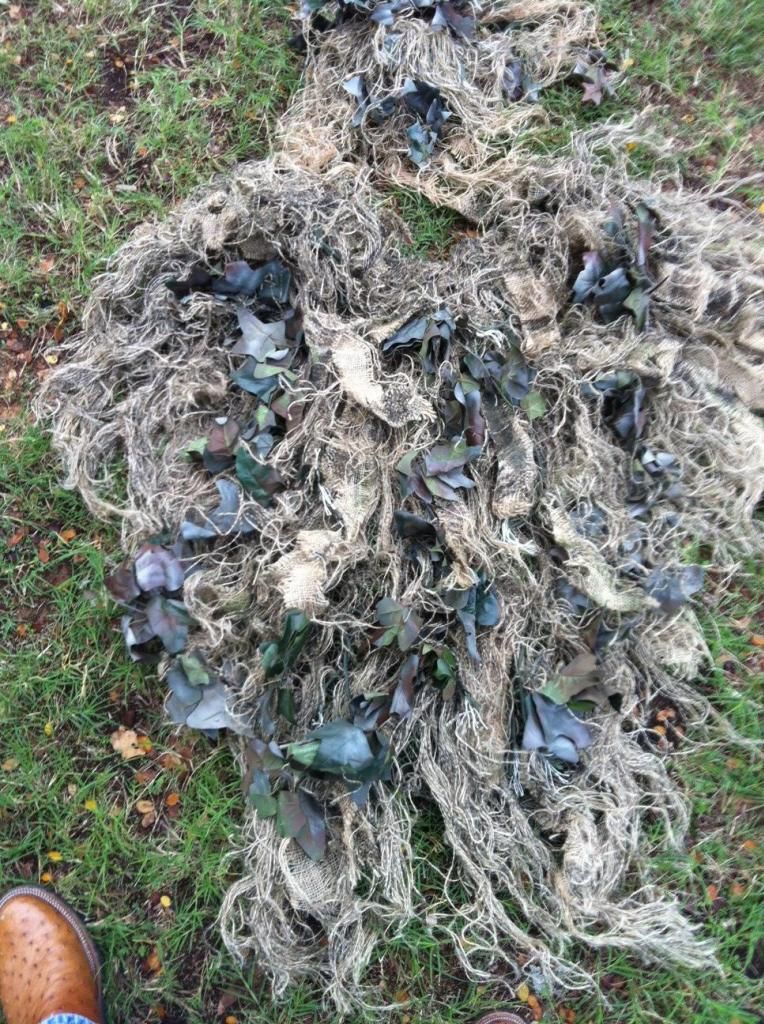

Here is my budget build. I really wanted light and packable so I went a bit like c-bass above (not as cool however). My poncho is pretty thick in the front and when on, hits me about the waist. Goes down to boot level in back. I use a couple plastic clips to keep it together and sitting properly. Multiple 550 cord points for attachment. YES, it is also too thick and does not have enough mud bath. That said, it was very cheap. Here is what I bought. All at Wally World.
1. Net from crafts section (like old fishing net). $7
2. Camo burlap. WalMart sells a 4x8 piece in hunting section. $15
3. 550 cord
4. Plastic plants (sprayed to get rid of shine). $10
5. Cut strips and started tying. Free (sorta.)
6. Spray paint
The hole is where it goes over my head. When sitting, I sometimes turn it around and let the long part hang down out front for cover. My hunting area is NTexas and Hill Country. I needed a bit of green and the fake plants work awesome for depth. Since this time, it has had a monster mudbath and some of the jute removed. I also added a little color here and there. It rolls into a ball and I have a net sack that I put it in. Weight est is around 3-4lbs.
LD
